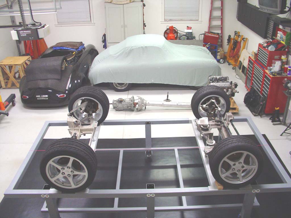

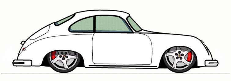

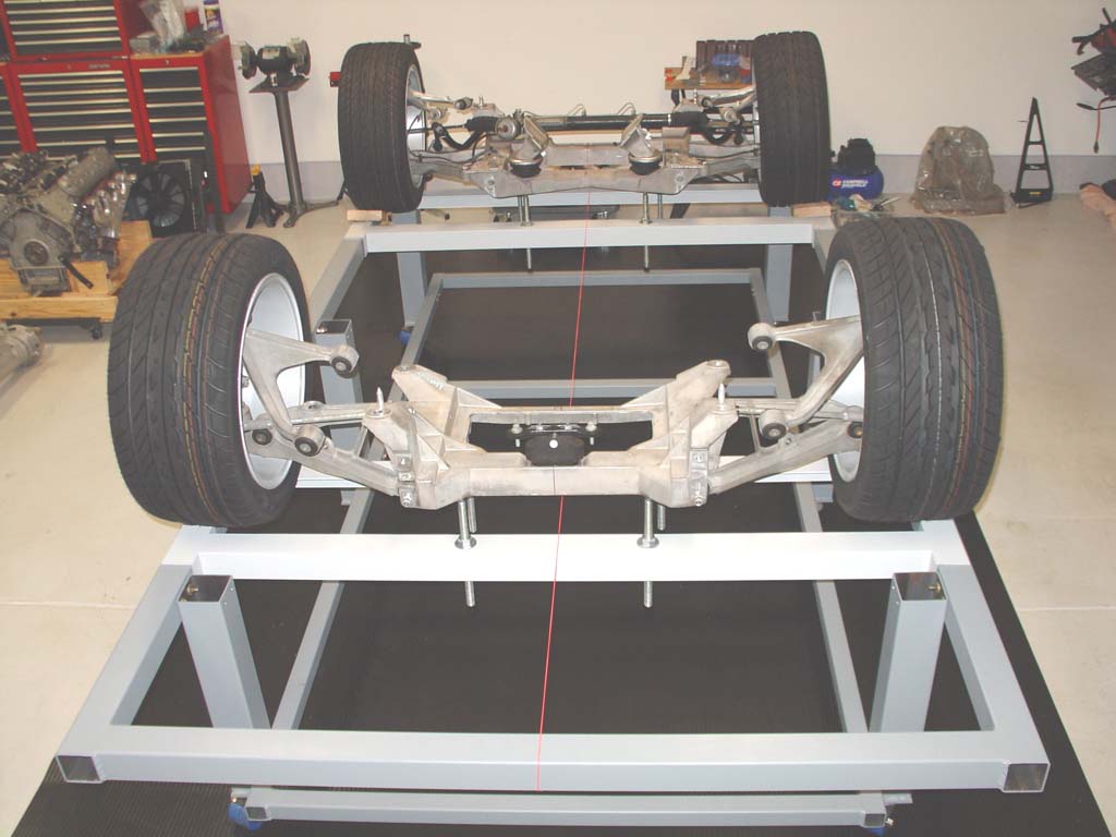

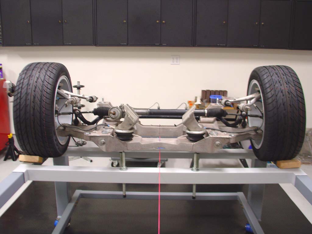

Here's a new twist for you to think about. I have a 65 356 Porsche coupe - and I'm in the process of installing a 2002 C5 drivetrain and suspension under it. I have to build a custom perimeter box frame - with a tube backbone so I can lower the car down. (Kinda like the Sniper that Troy did a while back) I also have to split the car and widen it 10 inches to get the torque tube down the middle. I'm sure I'll upset the 356 crowd - they call these Outlaw cars. Hope they will see it as an interesting use of the car.
I have the parts, the frame jig is done, and I'm starting to layout the suspension cradles/parts so I can determine where the upper A-arms pickups go. Does anyone know the factory suspension measurements that would help me figure out the proper placement of the upper ?? (not the alignments specs) I've read some of the threads where some people just install them to look good and don't worry about how it works at the limits - but I'd like to really make it work too ! Any help would be appreciated !!

The reason for splitting the car is because on 356 Porsches - the pax and drive seats are literally touching. In order to get the torque tube down the middle - I'll need to widen the car at least 10 inches to seperate the seats. Other then that - I really don't need the stock vette track width. If I widen the car as stated - the stock vette track width is just right. I might shorthen it a bit so I can get a slightly deeper lip on the face of the wheels just for appearance - but the stock Porsche turbo wheels don't have much anyway.
One of my main problems is lowering the steering rack down so I can move the engine forward and over the rack. I have an LS1 front sump pan from a GTO that will let me move it forward - to gain some foot well space if needed. Once I get the upper arms set in their stock locations - I'm ready to set the body on the jig and start cutting !

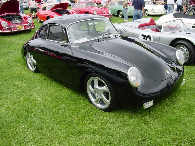

Mr. Johnson - Thanks for the suggestions and guidance. I have every pict I could find of your awesome cuda - and will be stealing every idea possible I can't stop looking at the wild work you and your team performed on that car. Guys like you keep me keep me working hard at building something a tenth as nice - if I can even acheive that level ! I won't be cutting the Outlaw car (blk w sunroof). That's just one I saw at a porsche show in Calf that had the look I was after - yet mine needs to be lower. My car is a real 65 coupe, single owner, 67,000 miles and when he retired he had the body completely stripped, blasted and all the metal work replaced that was bad. He primered it -and then put it into a storage bin for 20 years losing interest in finishing it (Golf...). He had already bought everything new to completely rebuild it - and that came with the car in un-opened boxes. I got the whole deal for less then the body work costs - 20 years prior..... I have attached a pict from when I brought it home.
