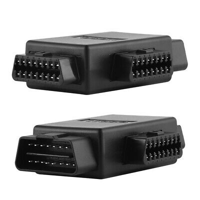

A little update...... After the LS transplant and installing all the Dakota Digital products ...... the car was Awsum....Chris took the car on the Hot Rod Power tour...... Driving to Ohio for the start everything was perfect...Then during the middle of the week the car started having some issues.....He called and told me the Dakota dash had only half the gauges working and the cooling fans wouldn't run....... Hummm!!!!!!......This happened sporadically....Hummmm!!!!........ They ended up adding a manual switch to turn the fans on and he made it home .......I was thinking it was a Dakota digital issue...... LOL..... after getting the car into Frame-up and Donnie and his crew looked into the issue....... They found that the OBD splitter harness I added for the ease of Scanning if required was the problem..... The Harness was the issue....... They removed it and plugged the OBD plug from the GM harness directly into the Dakota module and everything is perfect again..... Just wanted to post this because it might help somebody in the future......

I have had issues on several builds due to the use of splitters. Some work and some don’t. The shorter ones that use ribbon cable or the ones without cable seem to work better.
I had one issue where the voltmeter wouldn’t work until I changed the bus address of the Dakota Digital BIM. You have four options for bus address in the BIM.
I spent some time looking to see if anyone made a bus buffer or expander without success.
Don

I have had good luck with this splitter
https://www.ebay.com/itm/333415688554

dhutton, you're an EE right?
I was under the impression that the signal couldn't be split and that the issue wasn't the splitter so much as the splitting of the signal. I tried a couple of splitters when the BIM modules first came out and was less than successful so I have always avoided them as a rule.
If you got tech to impart, I am interested. Thanks!

Hi Donny. Ya retired EE. Well I have a couple of theories. With the long cables on the splitters there can be significant delayed reflections of the signals (caused by impedance mismatches) that can distort the signal. With the short lengths of the above splitter the reflections do not cause distortion. The other possibility is that the added capacitance of the cables is loading the signal but that seems less likely.
To be honest I haven’t been motivated enough to dust off my oscilloscope and look at the waveforms with and without the splitter.
