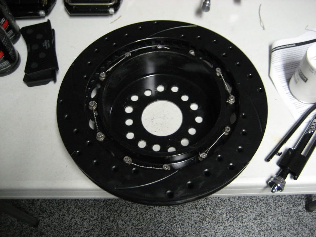

My brakes showed up, unfortunately my subframe change screwed me on the front brakes and they sent brakes for a stock sub. Wilwood dropped the ball there. I do have the rear brakes all ready to go minus the brake lines from the hose to the calipers. Just waiting on the rear end bracket. I did have to enlarge the stud holes in the rotors quite a bit. There is a shoulder about an 1/8 inch off the flange. The center hole needed enlarged very little. They fit perfect now and I have the parking brake adjusted and the rotor to caliper clearance is within spec. They look gooooood withthe wheels on but I was to lazy to lift those heavy sucker on there for the photo.

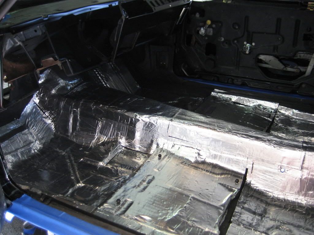

Next I ordered 40 sqft of second skin sound deadener. It wasn't to bad once I got the hang of it. Undecided on the firewall. Not real excited about using an insulator that could be very messy incase it decides it wan't to come loose. This should help substantially with road noise and exhaust resonance.
