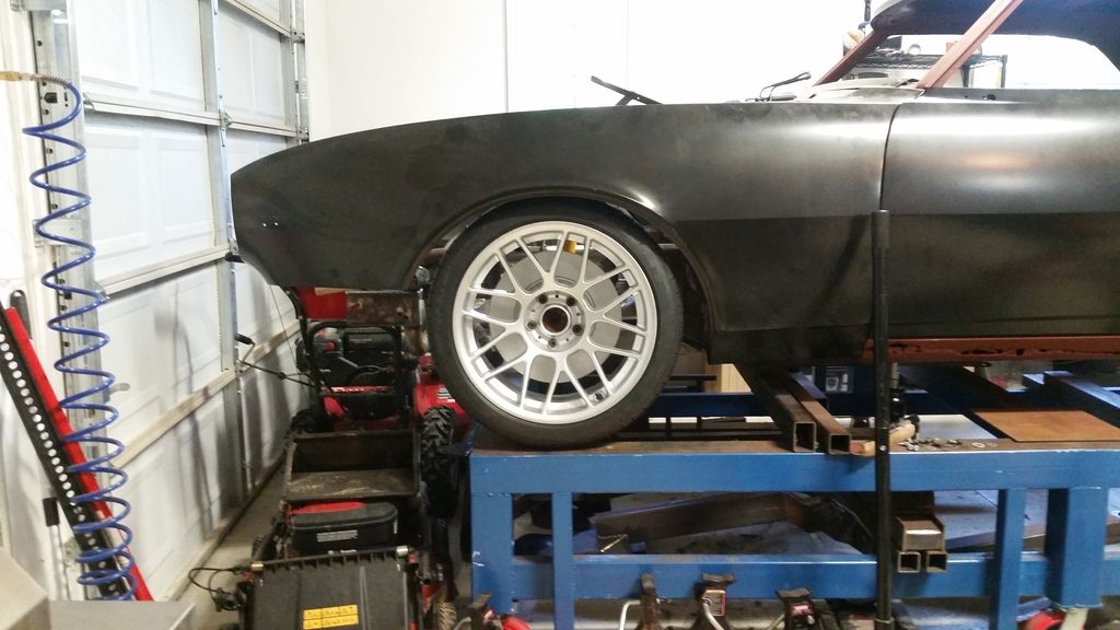

Just about finished with the front suspension..... at least on the driver side. Moved the mounts rearward to try and get the wheel centered in fender. I think I'm pretty close. Some cars seem to have the wheels further rearward but looking at this shot of Mayhem I think I'm in about the same spot. Anyone think I need to go further rearward?

Looks great, love the ride height!!!
