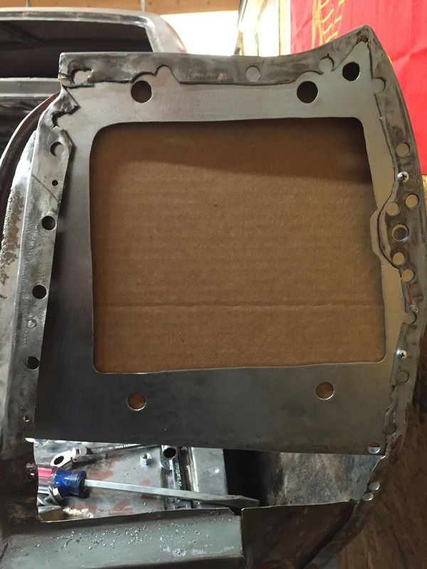

I've been working on a 68 to 69 tail light conversion on my 68 GT.
I never did care for the extra large tail lights on the 68.
Made a prototype sheetmetal piece to get close as possible for the 69 mounting.
Found the best location for it and held it temporarily with sheet-metal screws.
Mounted the 69 fender extension to check for fit.
Lens fits pretty good. I will fill in all the holes with muggy weld to delete the chrome trim.
I will modify this one and then make two final mounts.

The 69 tail light assemblies are installed. I still am not happy with the final results, back to the 18 gauge stash for another pattern.
I bit the bullet and bought a lower front drivers side quarter panel, and a trunk drop down. The amount of time it took to make the light mounts was more time than I had to spare, but I like fabrication.
I like the 69 lights much better than the 68 originals...
