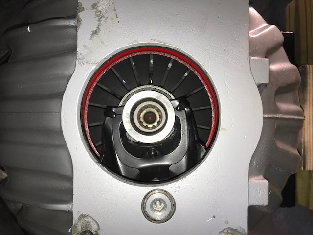

This weekend I'm going to take some measurements. I plan to measure runout on the driveshaft, rear axles, and pinion. I'll also try and check the rear end position/alignment if I can figure out a proper way to do it.

I took a few runout measurements yesterday evening.
Driveshaft yoke- .002
Front of driveshaft (about 4" behind weld)- .015
Rear of driveshaft (about 4" forward of weld)- .017
Rear end pinion- .001
Driver side rotor (face/lateral)- .003
Driver side rotor (edge/radial)- .005
Driver side wheel lip (lateral)- .030
Passenger side rotor (face/lateral)- .005
Passenger side rotor (edge/radial)- .005
Passenger side wheel lip (lateral)- .025
Anything stand out as alarming?

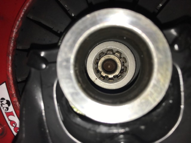

I "rented" the correct Snap On tool from a guy on a Corvette forum. It took all of 3 minutes to pull the bushing with the correct tool.
I installed the new tail shaft bushing, seal, and new yoke on the driveshaft. Finally, got some dry weather the other day and went for a drive. The vibration is still there... It may be very slightly reduced around the 2000 rpm range, but the 4000+ rpm vibration felt the same.
So...……..I pulled the trans out this morning. It went smoothly.
Here's a short video of the play in the input shaft.
https://youtu.be/cbggep6tDu0
Axial play is .007"
Radial play is .065" (measured about 1/2" from pilot end of shaft)
I'm pretty sure that's not within spec. Any input?
The pilot bushing, throw-out bearing, etc, look normal too me.
**Not sure why the top two photos are 90* off**
Daniel

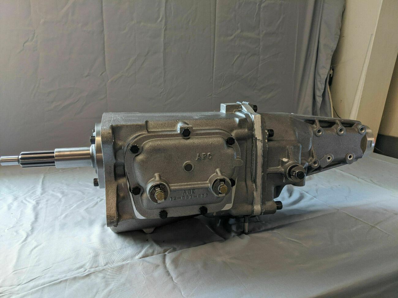

My existing Muncie M21 has had weld repair performed on the mounting ears of the case. So, instead of rebuilding this unit, I'm leaning towards starting completely fresh.
I spoke with the folks at Auto Gear (https://www.autogear.net/motorsports/) and should be ordering a Muncie M20 from them in the next few days.
Here's the specs on their Muncie:
BRAND NEW Auto Gear "Syracuse" four-speed manual shift transmission/gearbox with Auto Gear/Antonio Masiero 'Muncie' M20 gearset (2.52 / 1.88 / 1.46 / 1.00 ratios), ONLY with 10-spline input, 27-spline output, and passenger side speedometer.
Choice of 7 or 8 tooth speedometer drive (typically 7-tooth for 3.55-4.10, 8-tooth for 3.08-3.42s).
It uses the following:
Auto Gear American-made "Supercase"
Auto Gear American-made C355 aluminum midplate
Auto Gear American-made heavy duty tailhousing
Auto Gear American-made, Oilite(tm) Bronze-bushed sidecover
Auto Gear American-made cast STEEL shift forks
Antonio Masiero (Italy) M20 gears (2.52 / 1.88 / 1.46 / 1.00) w/ 1-inch cluster gear
Antonio Masiero (Italy) Auto Gear-designed synchronizer hub & lightweight 27-spline mainshaft (tighter fitting hub-to-mainshaft fit [40-spline press fit and zero lash])
Antonio Masiero (Italy) forged synchronizer sliding clutches
Forged high-silicon bronze synchronizer "blocker" rings
Auto Gear-designed, Antonio Masiero (Italy) produced T10-syle reverse gears (no more chipped up reverse gears!)
Hopefully, this will do the trick...
