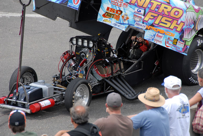

Troy Trepanier made these for Chicayne, I've always loved them and they don't eat-up a lot of under-hood space! Lots of trial and error in getting the travel, angle, and strut geometry right, but what a great look!
