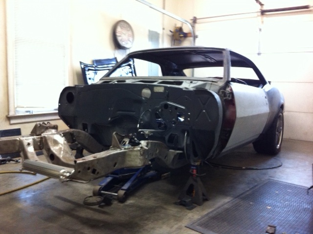

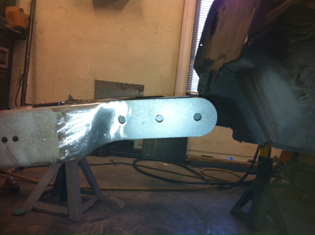

I did some measuring the other day and found out I didn't install my subframe completely square to the body, so I pulled it back out. I never was able to get the same measurements I found in the Fisher body book. I was an inch shy of one of their cross measurements...strange...I did however get it square. I finally welded on the DSE subframe connector brackets to the frame as well. My frame has a flare at the end and the DSE brackets would not fit flush, on the side, to the frame, so I had to get creative. What do you think?

Well that post was enough to create paranoia over swapping my subs one for the other...
I think your fix looks about like it was made that way. Got a pic from above? Or another angle?
I'm still torn over whether I want to take the front clip apart or off, contemplating pulling the motor then dropping the sub out... and so on.

It's strange, I had a 68 frame under the car for a while that I did the permanent Guldstrand mod to. It fit perfectly under the car right on spec with the Fisher body manual. I switched back to the original frame to this car when I purchased the Truturn system. Ridetech states their system cannot be used with the G-mod. Now, the original frame to this car measures nearly an inch shorter at one of the cross measurements from what Fisher manual states. I'll find out tomorrow how the fenders fit with this frame.
I'll snap some more pictures tomorrow for you from different angles.
I would do everything I could to not have to remove the fenders. I've been trying, off and on, for quite some time to get my fenders aligned properly and have yet been able to get a fit that I'm satisfied with. I have all GM metal, minus hood, and still am having trouble. I'm about to defeat these ill-fitting fenders though!
