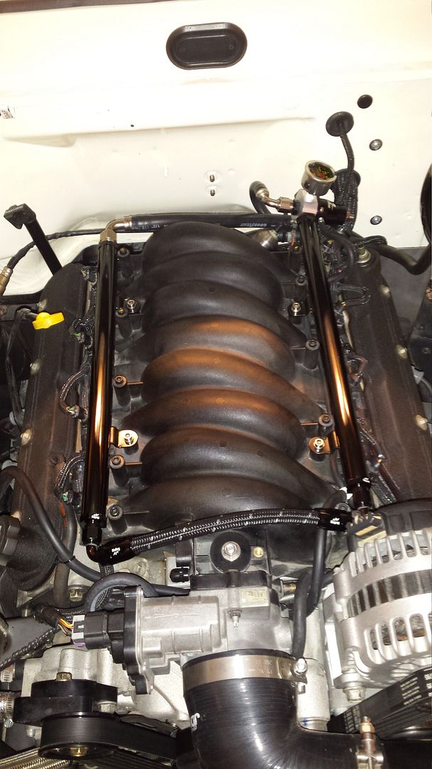

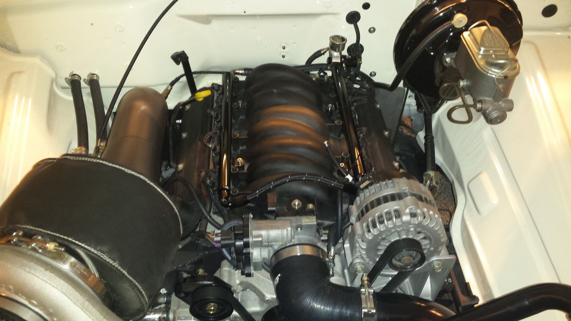

Truck is getting a 6.0 from an 03 hummer lq4 and a built 4l80E.
Power will be assisted with a Borg Warner s480 turbo, 80 lb injectors, circle d triple disc full billet converter and a HD-2 shift kit. Looking for somewhere in the 700-800 WHP range.
So, I got to work getting the engine in place and building some motor mounts.
Engine is nice and low in the engine bay, tranny should work out nicely and the engine is staggered to the passenger side to assist with steering rack, booster and exhaust clearance.
Here are the engine mounts all finished up and ready to go for powder coating. I am using the OEM locations on the front K member with some poly bushings sandwiched in there, trying to leave some room for the 4" downpipe.
So, I got the brake booster and brackets from a 75 and swapped the pedal into my 68 assembly, pulled everything I could from the firewall and dropped all that stuff off at the powder coater on Monday and that gets us up to speed for the weekend.
