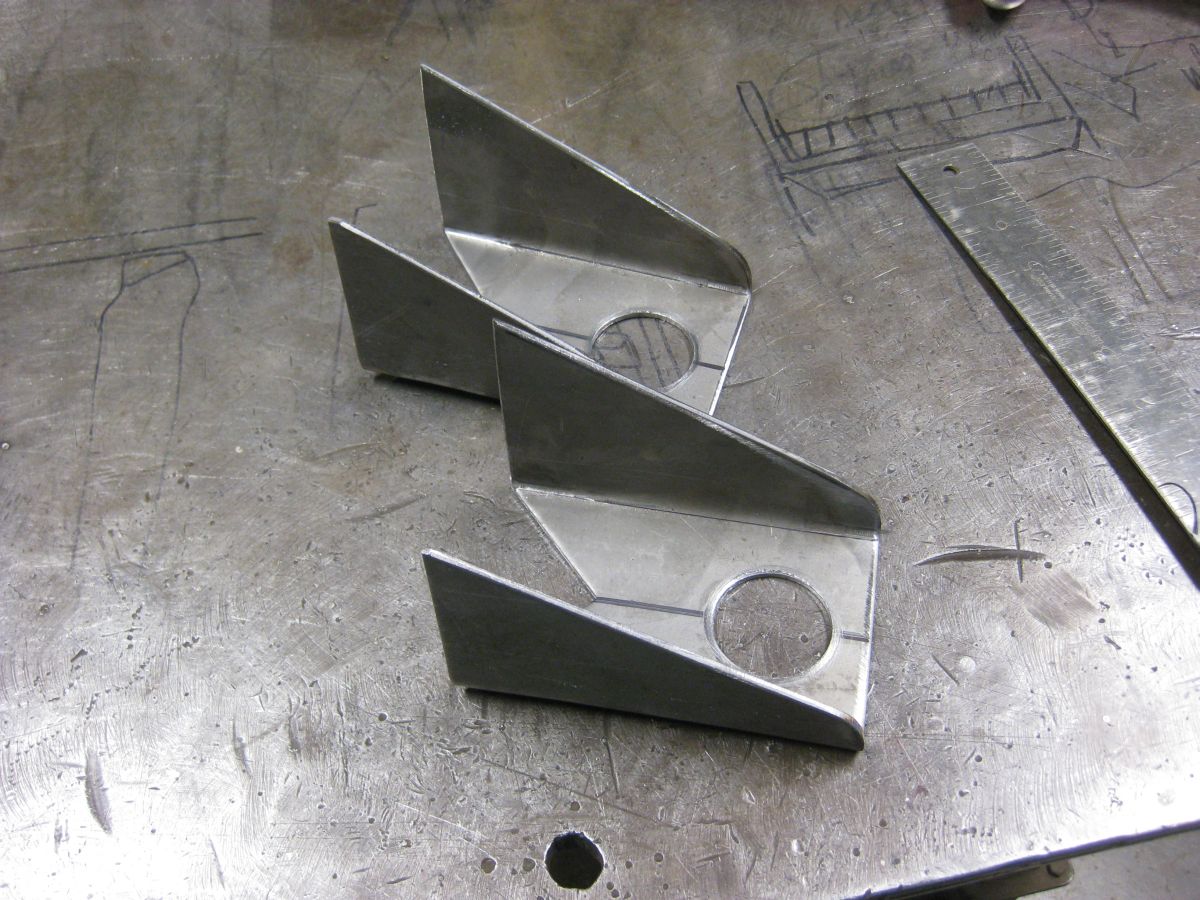

Blocks that got welded into the rockers and the place formerly known as rear frame rails. This gives a solid mounting point for the sub frame tie ins and the new rear frame rails that will need to be dissected to fit the IRS.

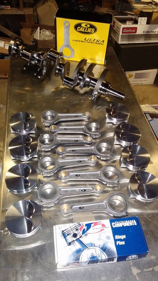

Giffin sent pics of the reciprocating assembly for the "rpm" motor. They are so very pretty.

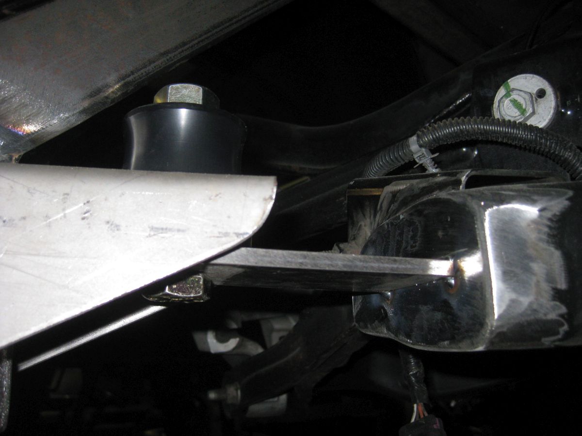

The IRS is in and level... if it passes a few expert looks, it will get gusseted and burnt in. It's using DSI bushings to mount the factory sub frame to the new mount points Scott welded in. Certainly not for the weak hearted.

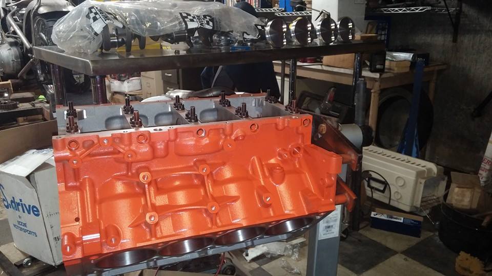

Since I am going through Camaro update withdrawals, Giff thought he'd cheer me up.
The block's ready to receive the internals and it's getting it's first coat of paint. I also got in the shaft mount lightweight rockers for it, so will run those up shortly.

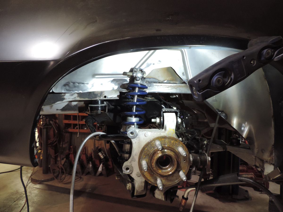

Scott's making progress on the IRS. I will order rims soon.
