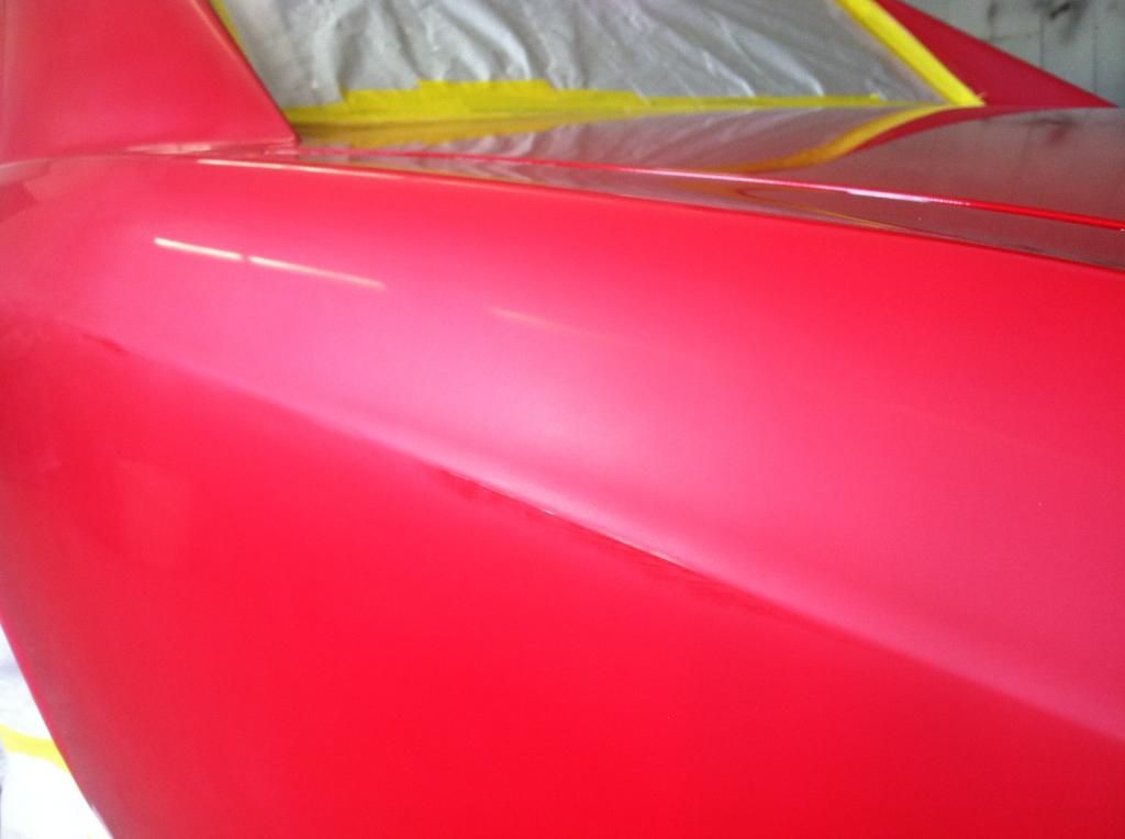

I got the glass installed and looking sharp. Having the original stainless for the front and rear windows is the key on these guys. I think we got the gaps as good as they can get.
Next up was a final cut with 3000 and a wool pad followed by the hybrid Finesse-it II pad and compounds. Then the black waffle pad followed finally by the blue waffle and 3M micro polish. It's looking really flat and crisp. My guys are hitting a home run.
23 days to go!
