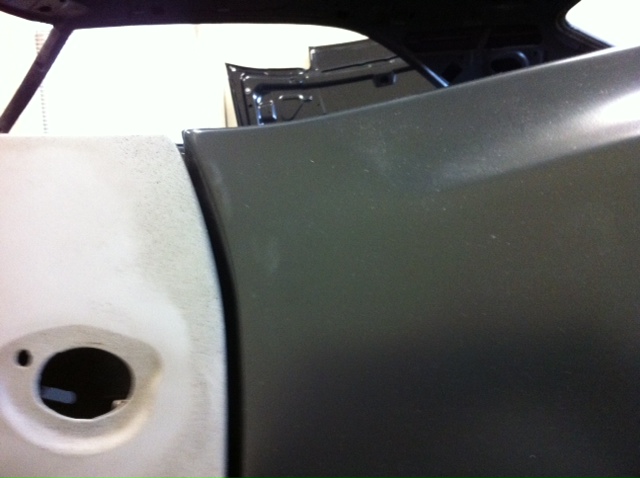

I've been working on front cap alignment. It's still not where it needs to be, but am getting close. Once I'm satisfied with the fitment, I'll move on to working the gaps and the flatness of the panel edges. Factory panels had a curve to them up to the edge from the stamping process. I like for them to be flat across the gaps.

I was just reading your update .... looks like you have your work cut out fer sure. Did you say those were GM fenders? They don't look so good

Yes, they are original GM fenders aligned to original GM doors
I'm sure I'm making it more difficult than it should be
