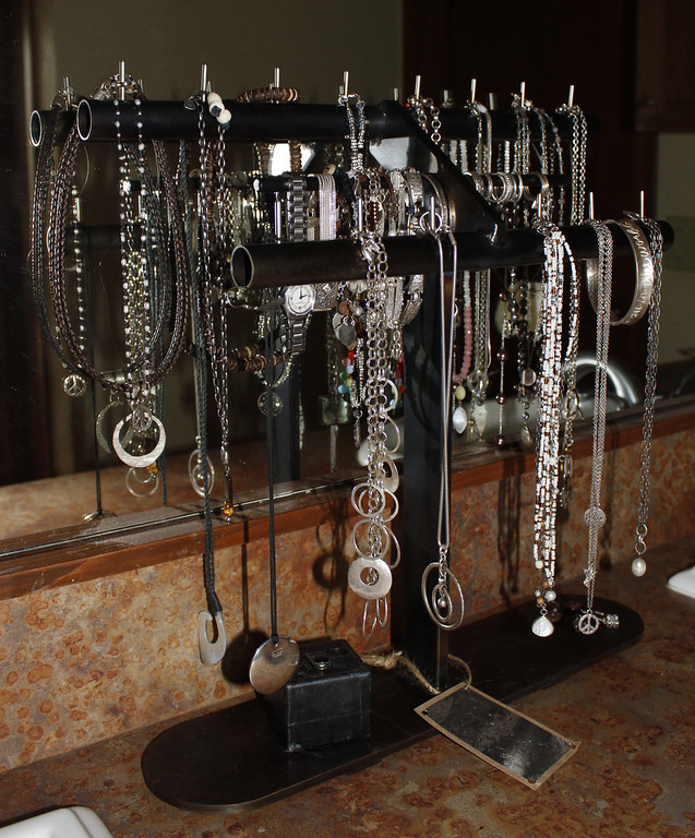

TIG welding practice project......fabbed a necklace and ring holder for the wife for Mothers Day.
<holding a card to his forehead - and wearing a diaper for a turban> I see a future for you little one......

...fabbed a necklace and ring holder for the wife...
I like your style. I'll have to remember this. When she starts complaining about spending too much time in the garage you break out "But... but... honey, I'm practicing for you"

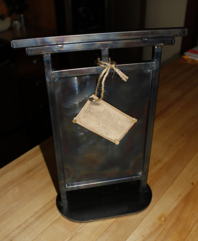

Mom's Mother's Day magnetic photo frame.
Wife's necklace holder loaded
