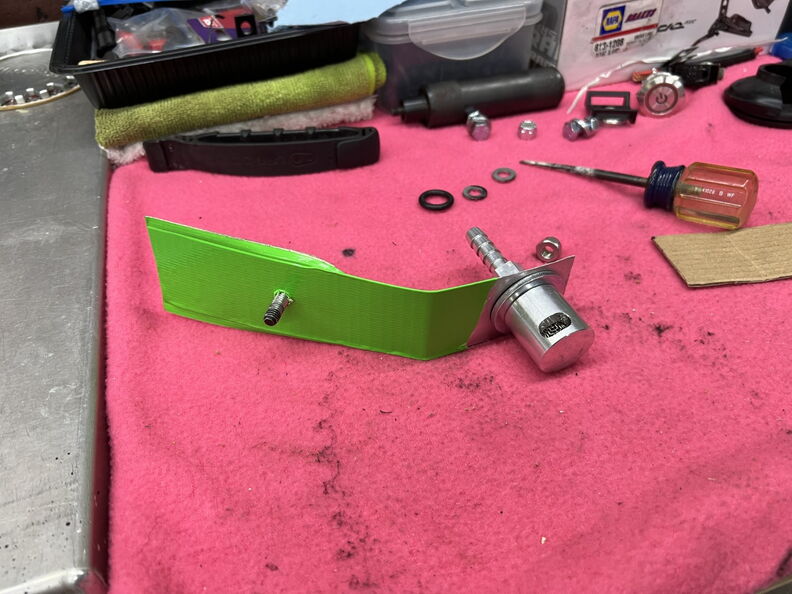

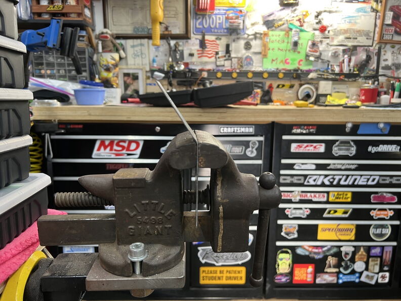

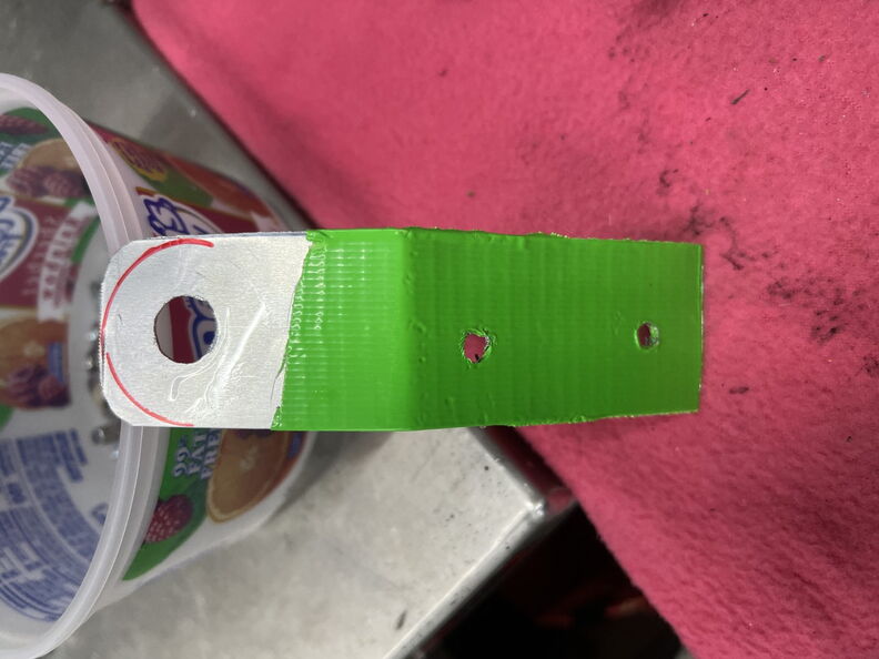

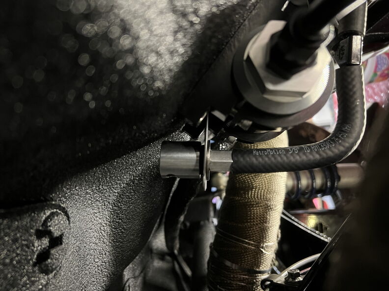

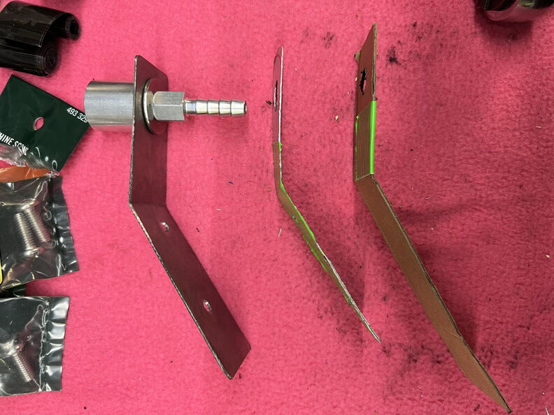

Default Fuel Vent Bracket (03-20-22)

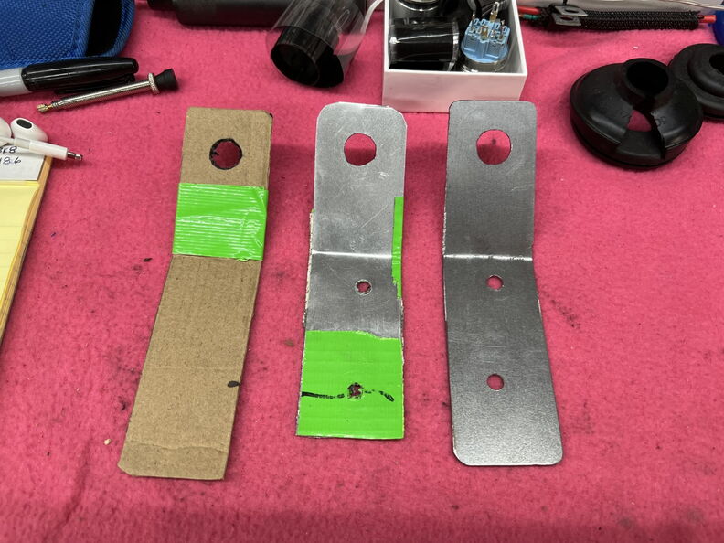

The bend looks perfect

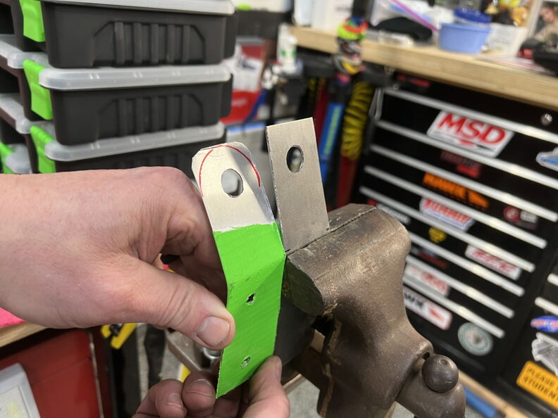

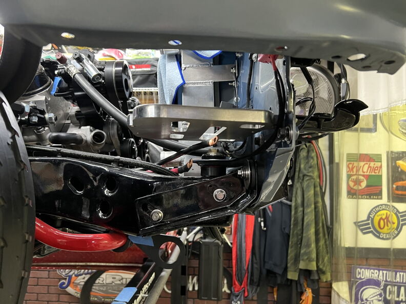

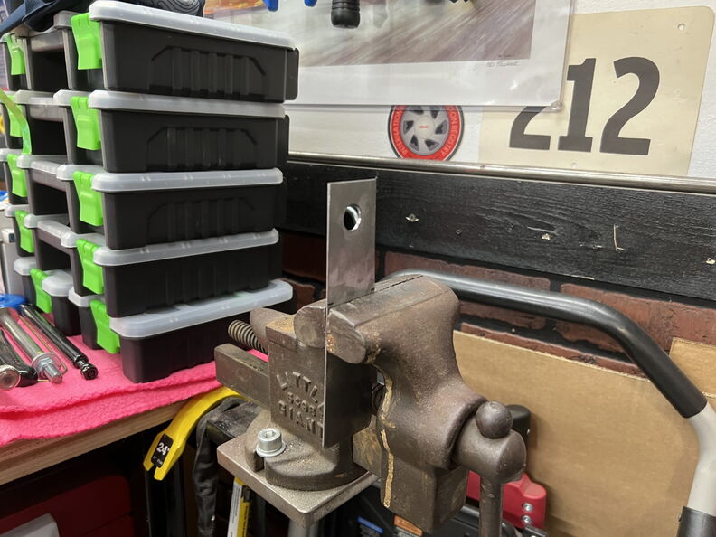

I originally made the fuel vent bracket using some cheap thin steel.
Test fitting to make sure it works.
Time to make it out of thicker Steel
Just a little bit more.
Comparing it to the mock up.

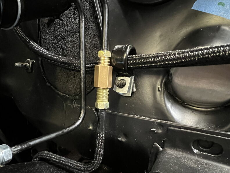

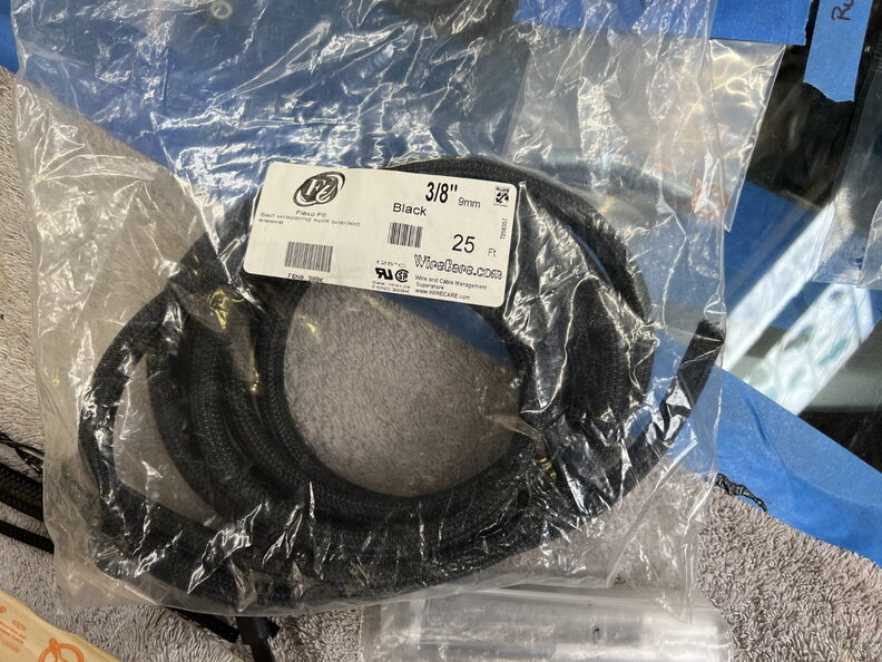

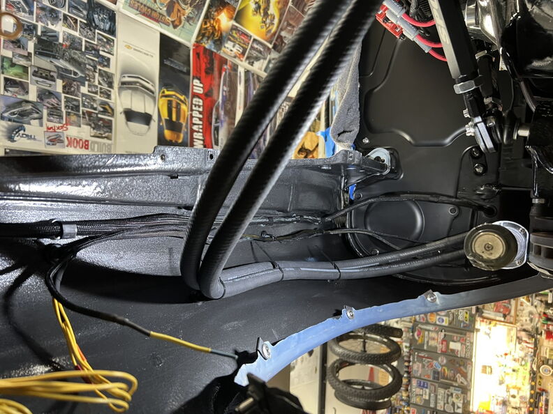

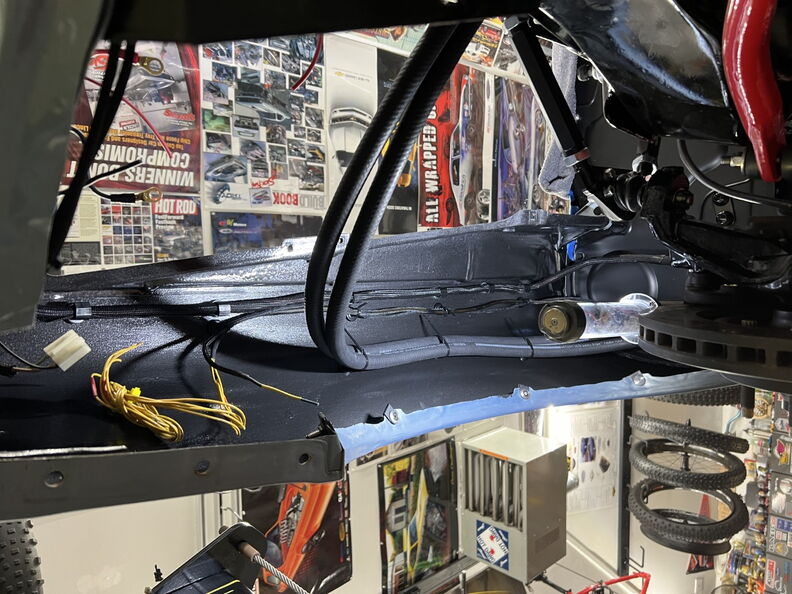

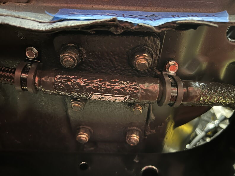

Default DEI Fuel Line Wrap (03-23-22)

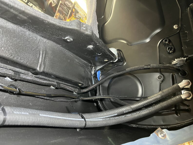

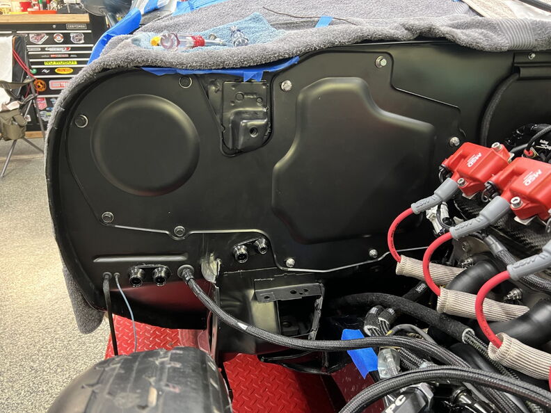

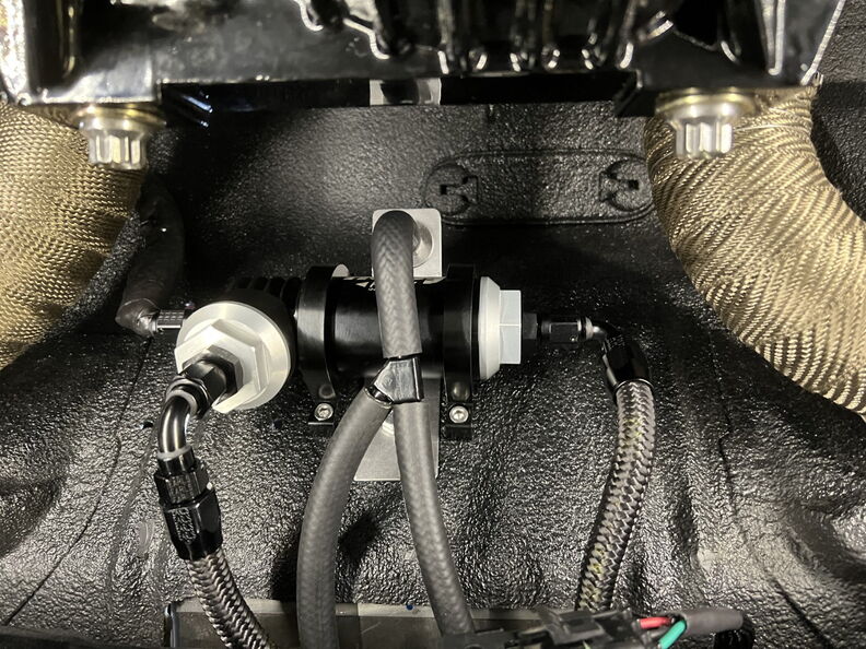

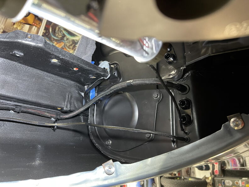

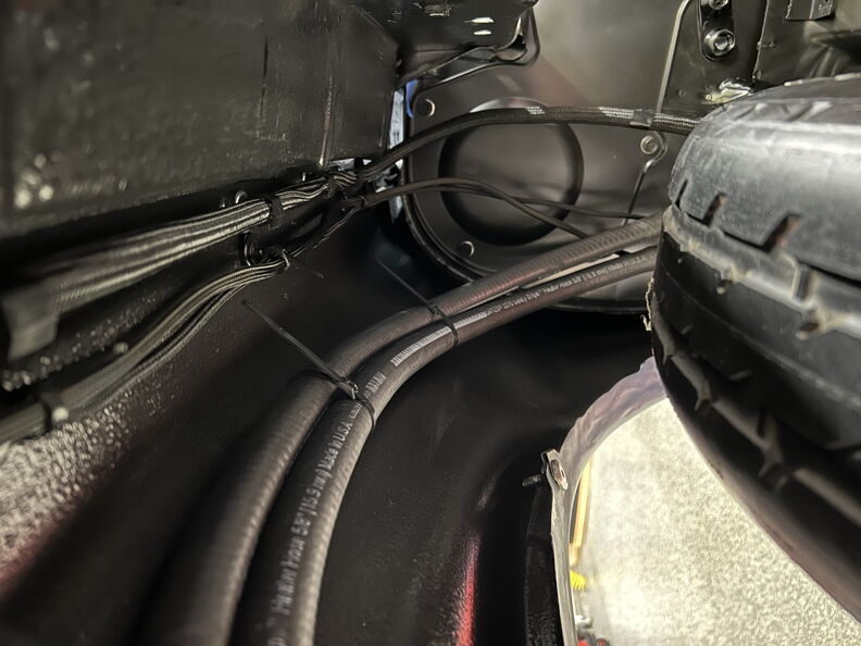

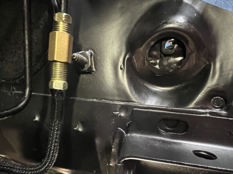

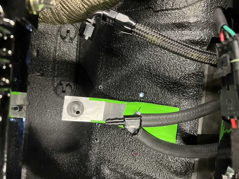

Since I am content as to where I ran the fuel line it's time for me to install the DEI Fuel Line Wrap and tape off the ends with there really strechy tape. Yes, I know stretch isn't a word.
You can barely see that the right side is taped.

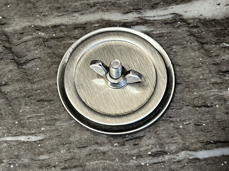

Ron Wilson was kind enough to send me this firewall plug so I can block off the E-brake cable hole.

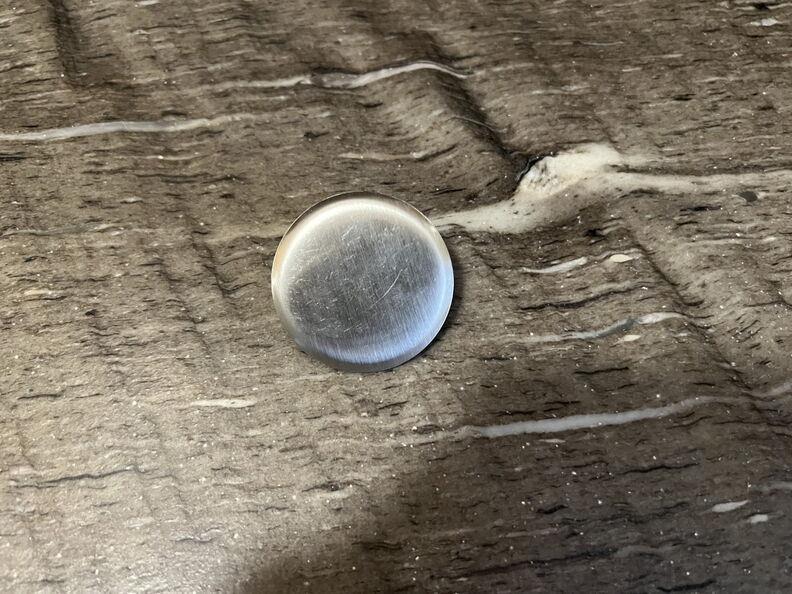

I filled the back with sealant which allowed me to install this by myself.
My OCD wouldn't allow me to drop off the bracket till I rounded the corners. So I pulled out my bench grinder and completed the task.
No it's not an illusion the holes are not parallel.
I also received these very nice Billet headlight switch knobs which I will be sending out to get anodized

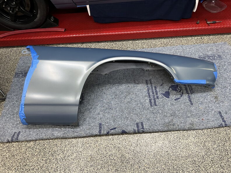

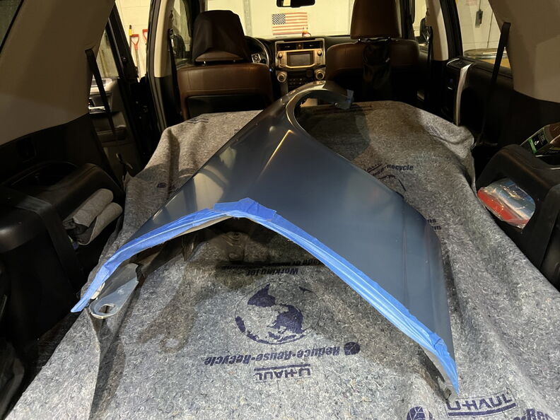

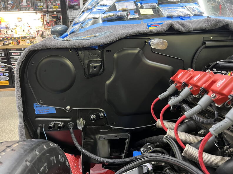

Default Passenger Side Fender is coming home ( 03-24-22 )

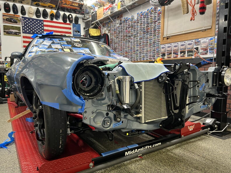

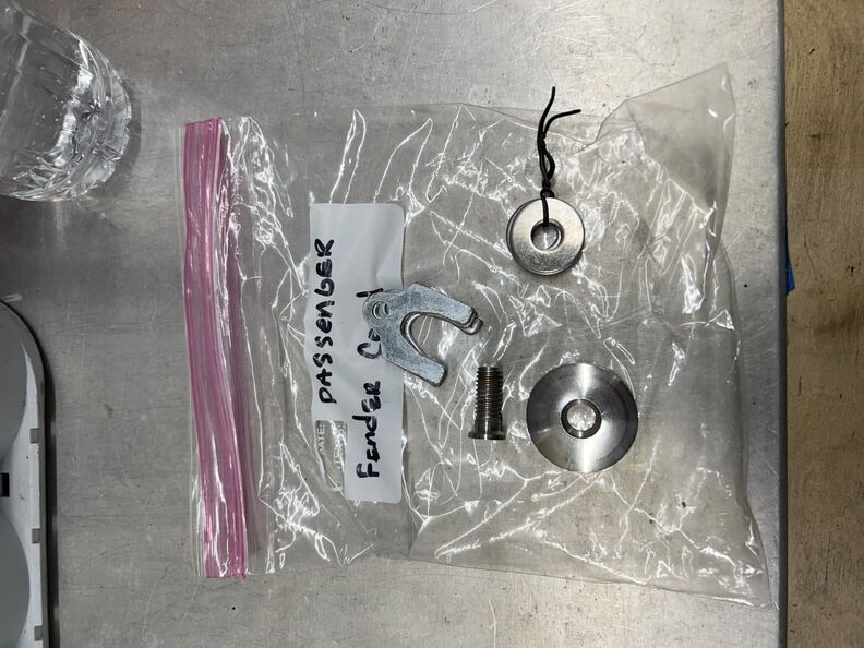

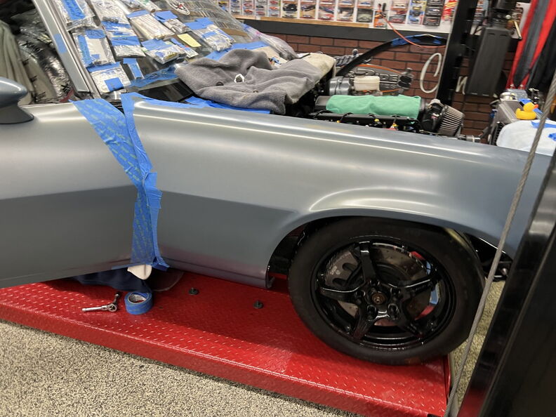

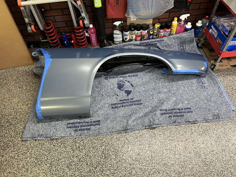

( 03-24-22 ) I am finally bringing the passenger side fender home.
Thankfully I labeled every bag.
Me and ARP are really good friends.
(03-25-22) Here goes nothing

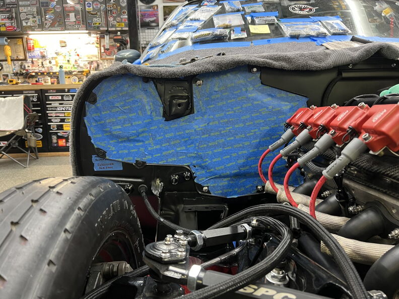

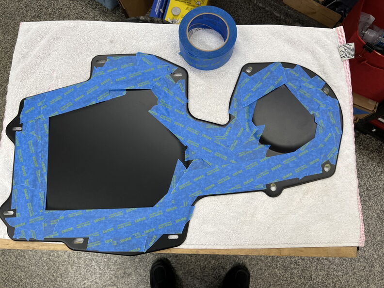

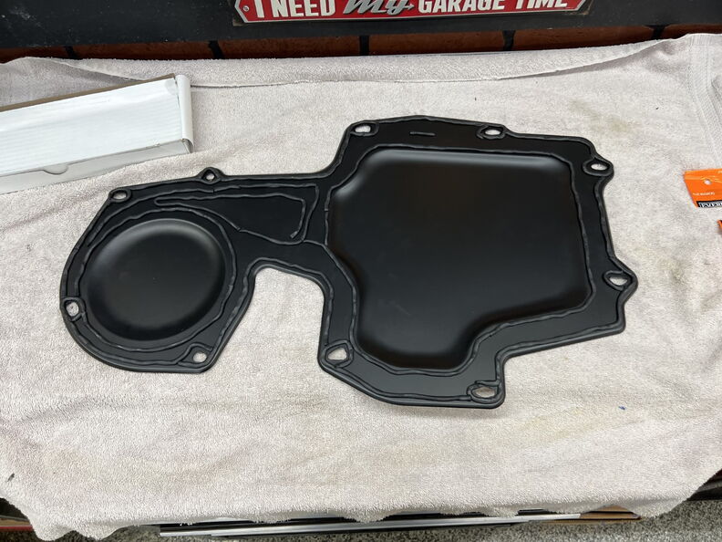

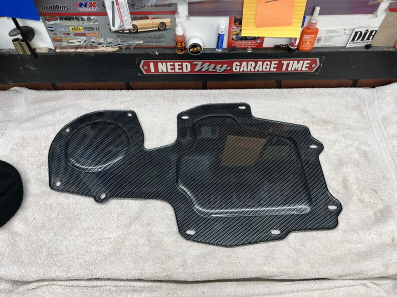

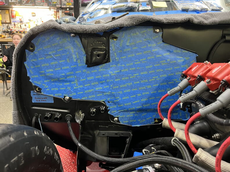

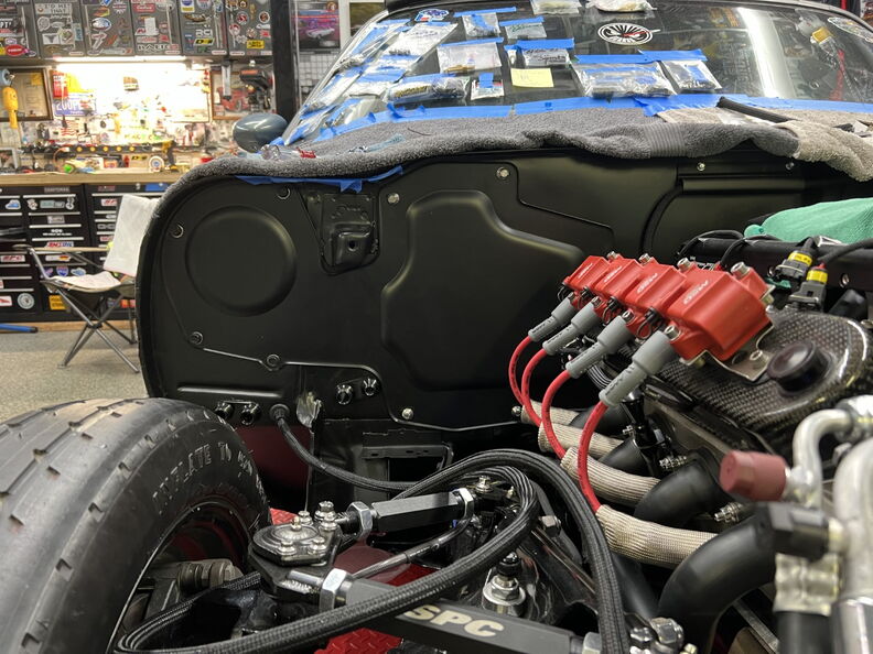

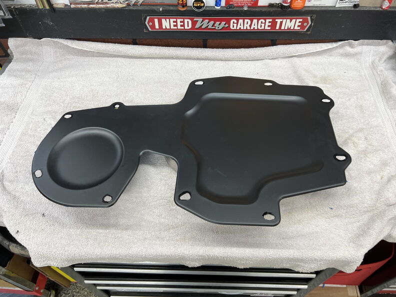

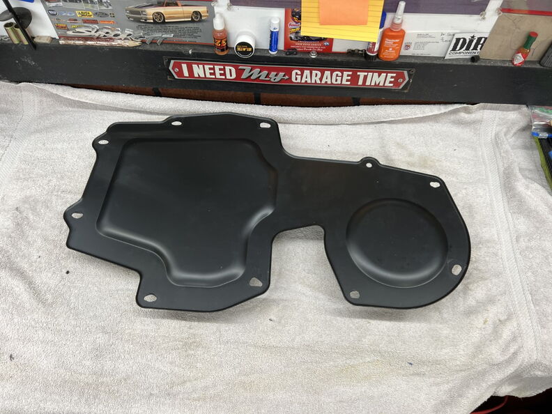

(03-26-22) Opps, I forgot to install the blower motor close out panels so off to Eastwood.

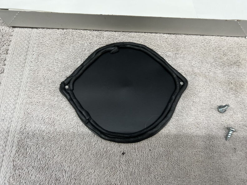

The originally DSE Closeout panel which I am not using has 5/16'' slots and the new one does not !!!! (( insert a ton of profanities here-))
So this sucks !!!
Apparently on the new panel I received from DSE the slots are way smaller and of course I already have 5/16 nutserts in the firewall and of course the panel is painted.
Luckily one hole lined up and I was able to locate all of the area's that need to be opened up.
I spent about an hour filing and test fitting.
Getting closer.
A little touch up paint.
A few feet of strip caulk.
Since four of the bolts are not visible I didn't use ARP bolts.
Fender is going back in hibernation since I want to tighten the bolts one more time before I install the fender.

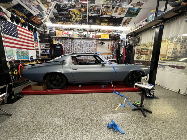

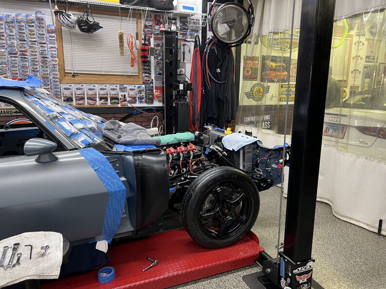

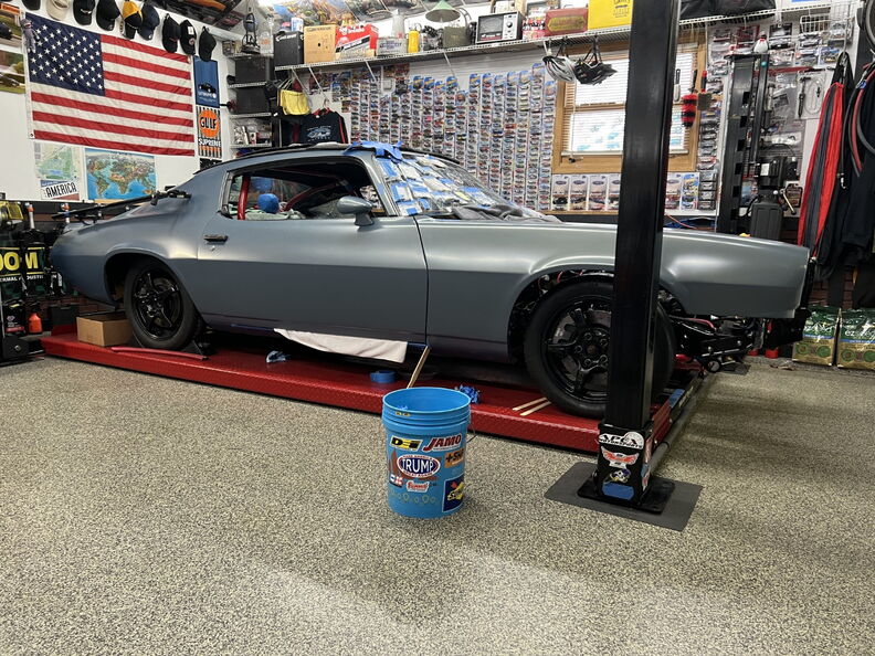

Default Passenger Fender is finally going on. Thank you Mike ( 03-27-22))

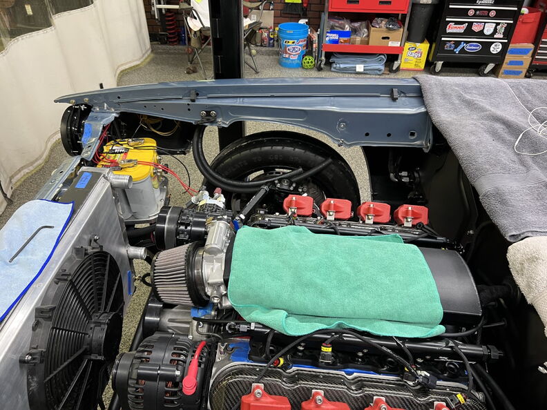

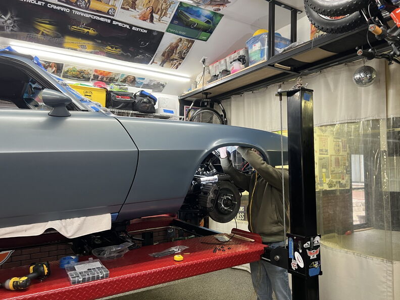

Well, it looks like this week we are going to install the passenger fender. Even if Remy says no !
Here goes nothing ( 03-29-22 )
After a little bit of work Mike I got it close.
marty-mj

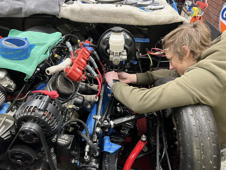

One of my daughters friends brother likes working on cars so he offered to help. So we started working on all the projects that require having a second set of hands.
The first project we worked on was the steering column & steering shaft.
Apparently Remy likes him.

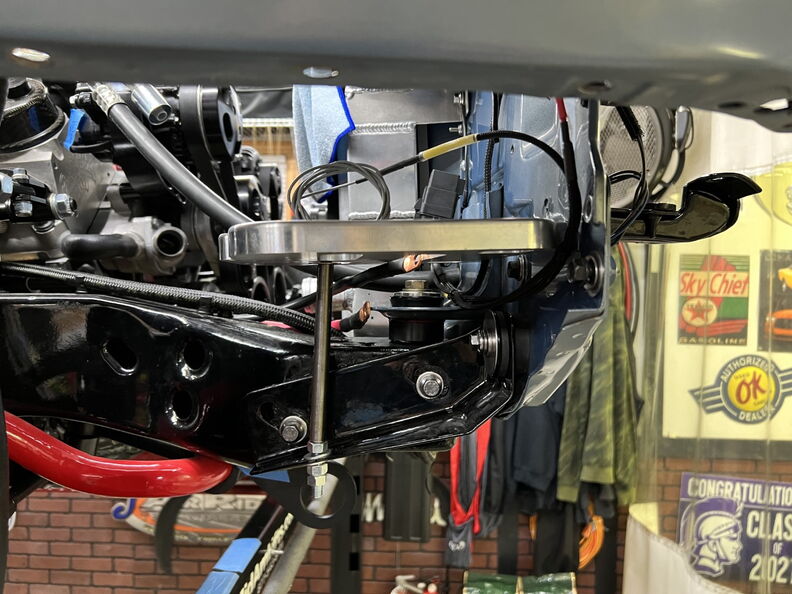

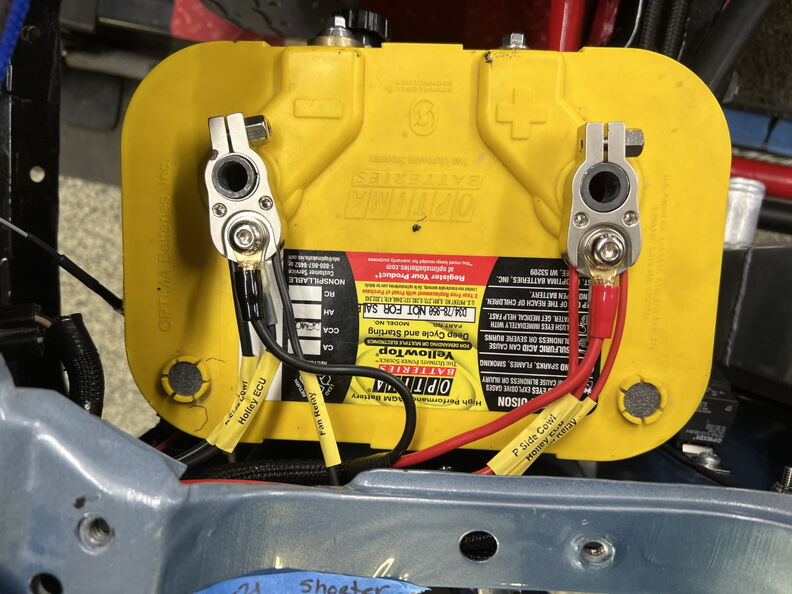

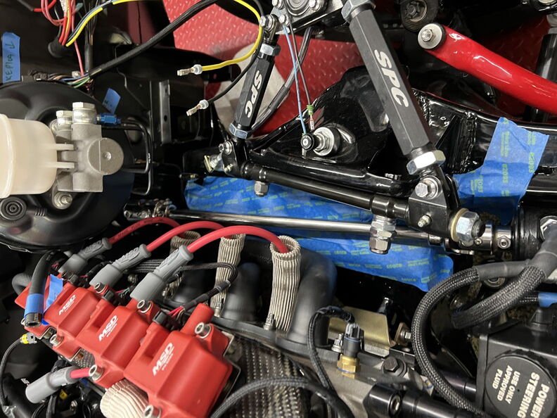

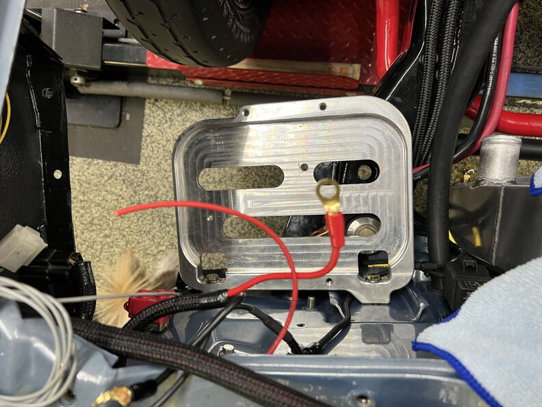

I re-installed the WMC Optima Battery tray so I could work on the wiring going to the Battery.
This is the support rod that is used when you are using the Anvil Carbon inner fenders.

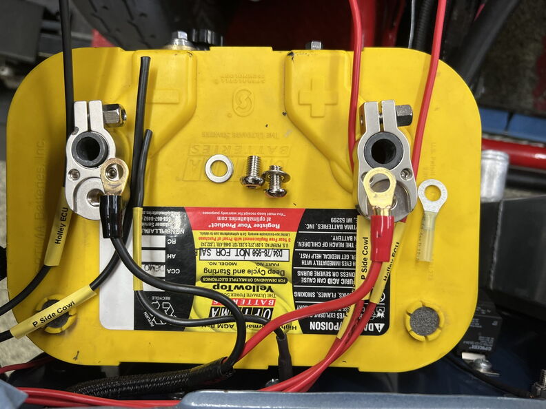

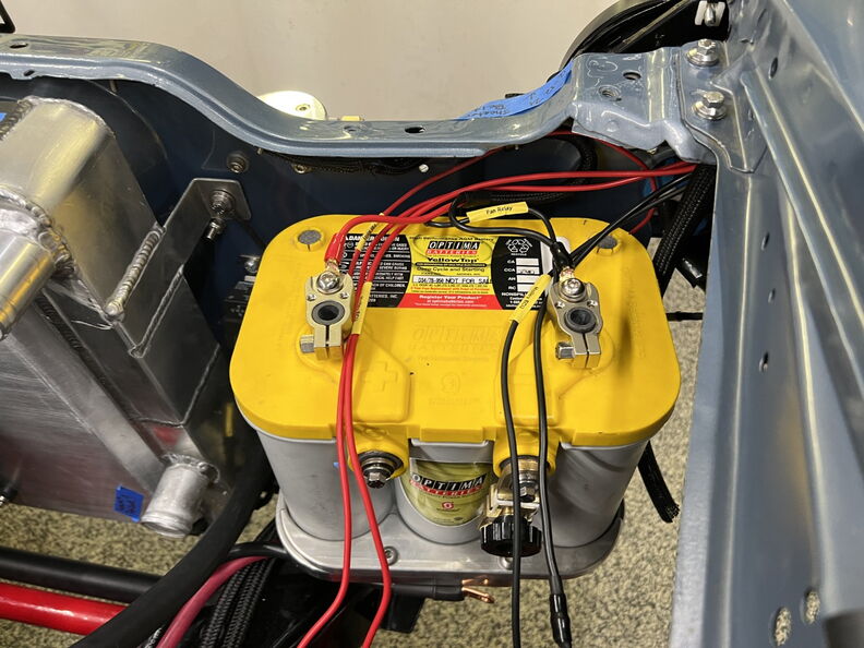

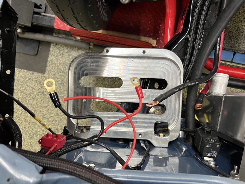

Default Battery wiring (04-10-22)

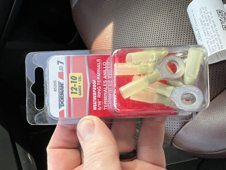

Before I started working on the battery terminal wiring I need to run to the auto parts store.
On my way home I stopped at McDonalds for a McFlurry.

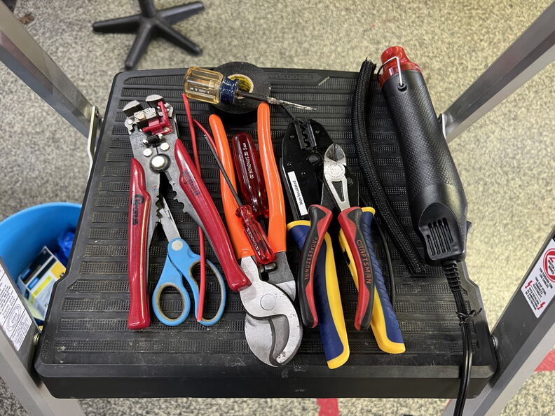

Since wires tend to have strong memory so I made sure the ring terminal was on in the correct orientation.
I am still amazed at the amount of tools used on every project.

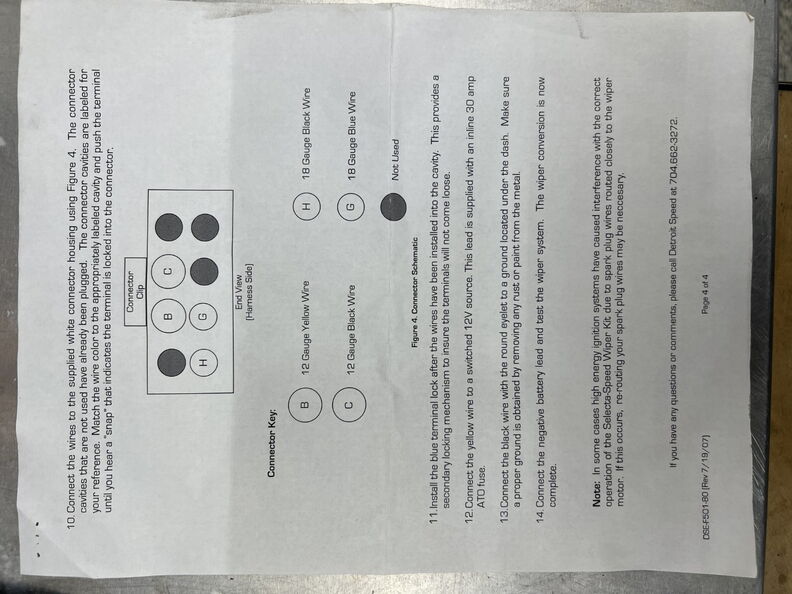

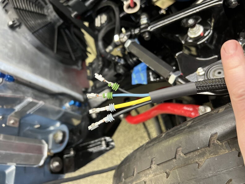

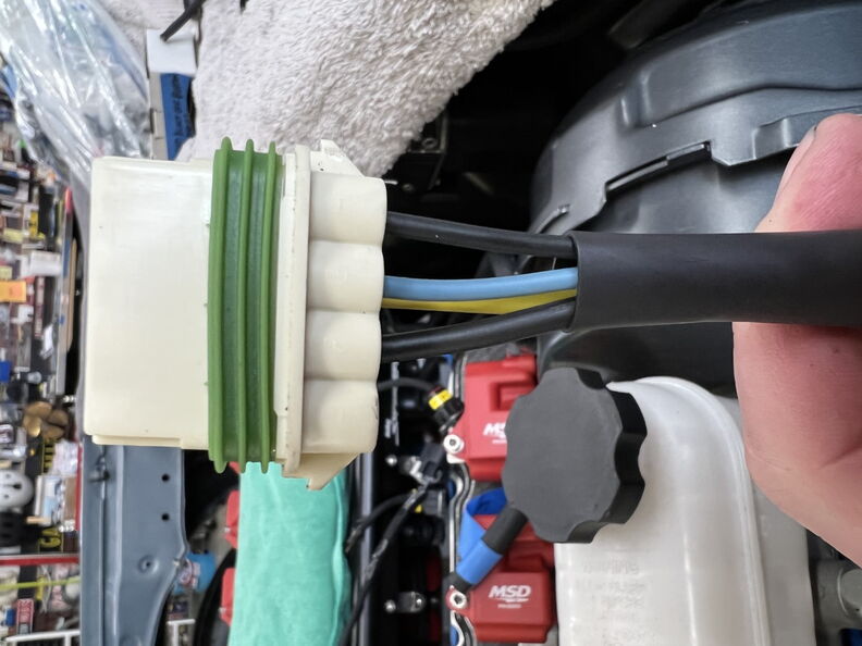

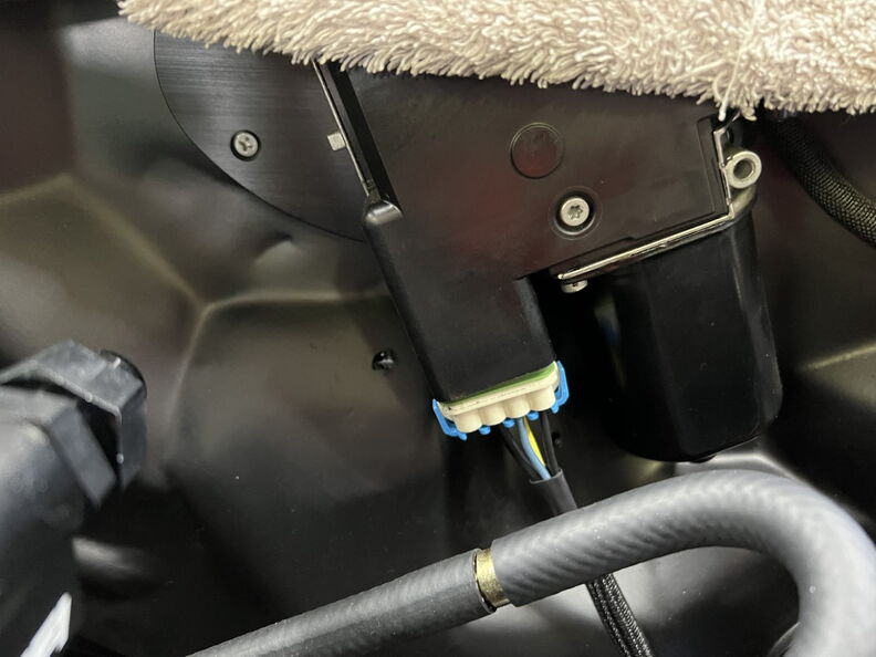

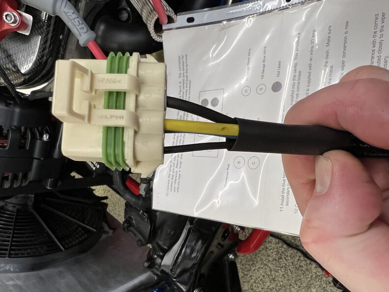

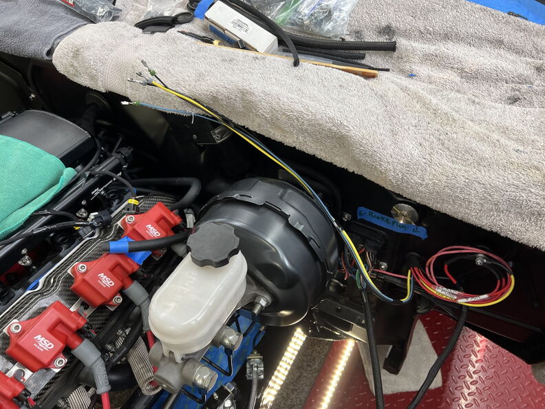

Default Finally found the DSE Wiper wiring Diagram (04-10-22)

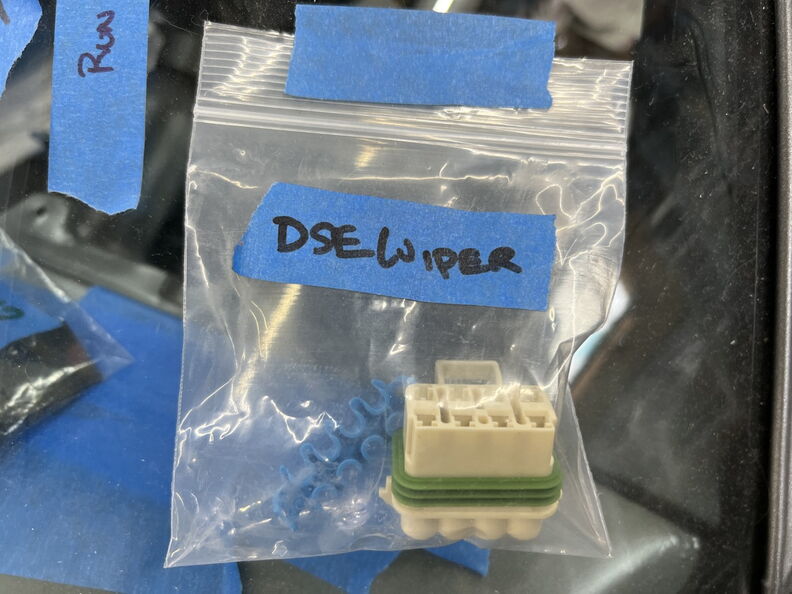

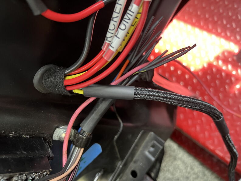

Well, I am certain everyone has lost instruction for something. This time I lost the instruction for the DSE Wiper wiring
harness and no one at DSE could find a copy of it for me as it was there Gen I kit. After weeks of searching I finally found
it so today is the day that I will finish that project.

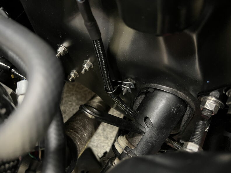

I added a line clamp to the steering column bolt. However, I am going to have to drill and tap these so I can use a nut to anchor these.
