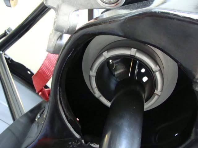

Originally Posted by speedjohnston View Post
I'm trying to post pics up to its present state with a bit of the build pics in while I have time but it takes time to load all this stuff.
I'll post one more for now of the start of the front suspension. sorry about jumping all over the place. When i do get to the present day it will be easier to follow.
This is a pic with the SPC a-arms and c5/c6 style spindles. For the front suspension and brakes is where I got Mark from SC&C involved. I'm doing it from home but I bug him as often as i think I can get away with.
Thanks Mark!
and the brakes 14" Baer 6S extreme plus
I got a little more work done this week with some paint touch ups to the new welded on parts and started hopefully for the last time final install of the front suspension components. I got some RCD Billstein shocks, and even though they are mounted in the stock location, I had to modify the bottom round bracket of the spc arms to clear the shock under full compression. A few minutes of grinding and a little touch up paint and all was good.
and the spindles mounted with my steering arms also by my friend and good neighbour Stu
Sway bar is also mounted, at least the main bar anyway after spending about 2 hours pounding those bushings in place.
I have to get the arms pressed into shape and install the rod ends. The holes on the bars have to be drilled out after, and I'll have to make brackets to hold the lower rod ends. If anyone has any pics with a link to how they did it let me know.

Originally Posted by Nor-Cal Nick View Post
Question,
- What made you go with Bilsteins over a adjustable style like Vair or QA1?
I don't know myself first hand about all the different brands, QA1's were considered among others, but after discussing it with Mark Savitske of SC&C and Steve Duck of RCD I decided on the Bilsteins. The nice thing unlike most of the parts is they are not very expensive and changing them at a later date is not an issue. RCD was also able to supply the valving, length and change the ends on the shocks to suit my needs.
