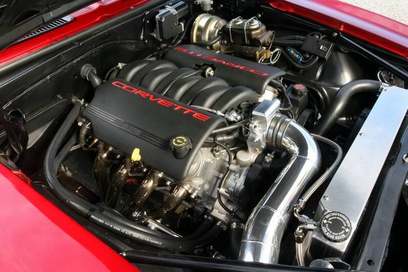

Payton, is that a FAST intake? If so, I'm definitely painting mine! Looks sweet

Fast 90mm and I am signed up and ready to go to RTTH. Got a little oil pump problem rigtht now...7 psi of pressure. No metal in the oil or filter so i am guessing it sucked out an o-ring or the bypass is stuck. While I am changing the pump I will put in an Improved Racing oil pan baffle.
