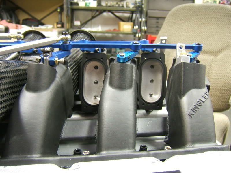

Oh My God. Think I just blew it in my pants...
And by the way. That would look awsome on my LS3...

Good looking intake!!! Really liked to see dyno results vs stock LS7 manifold.

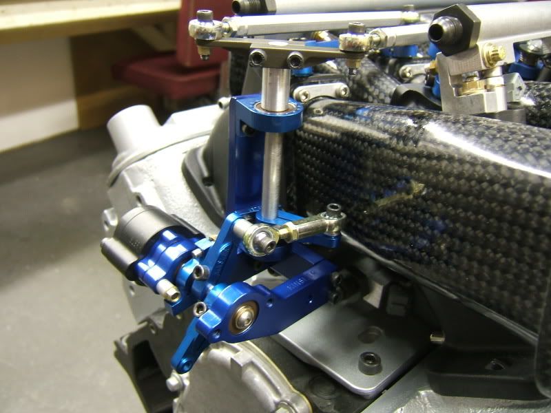

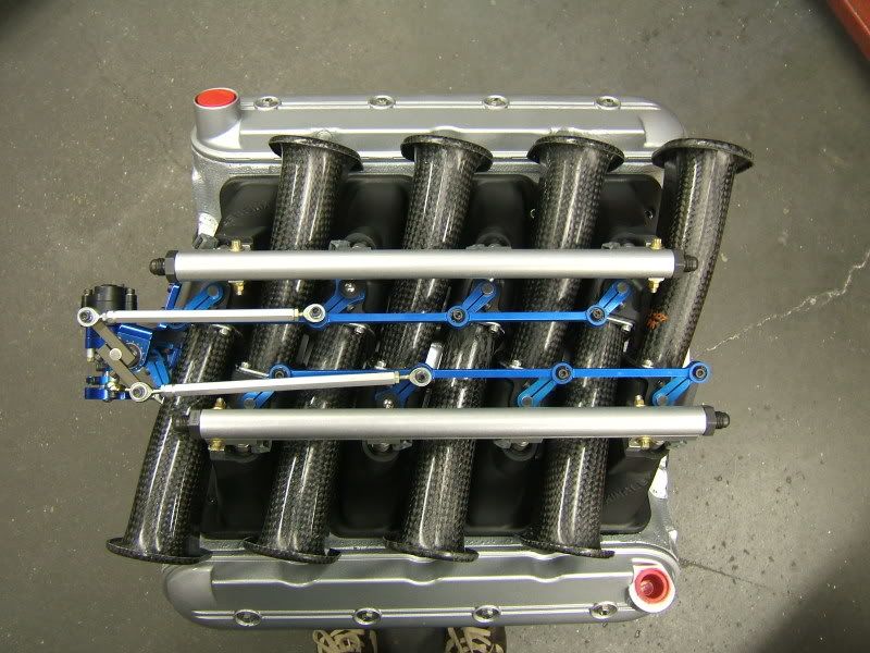

We just finished this today. What do you all think?
We had it on the DYNO at Katech (they did a great job. They are a talented group with the best technology around).
We were up 58 torque and 55 hp.
Torque peak 616 at 5197RPM 528 at 3193RPM.
HP Peak 696 at 6398RPM. 504 at 4389RPM and 662 at 7000RPM.
Numbers are on a 427 LS7 with big cam, headers, dry sump. Comparison is stock ls7 intake with UMI 90 mm throttle body vs. our cross ram.
How much will it be?
Will it work with Turbo Charging?
Will it fit under a stock 2 inch cowl hood?

Ty,no matter how much you dig the looks-you dont needit with forced induction.

Ty,
Give Kinsler a shout for a quote - there are some options that you may or mey not require - ECU and baseline tuning for instance.
The manifold is ~8.5" tall measured from the blocks register/china wall to top of the casting so it fits with room to spare.

With those kind of power numbers, your probably right.
But really now, that thing is just beautiful to look at if nothing elsi.
