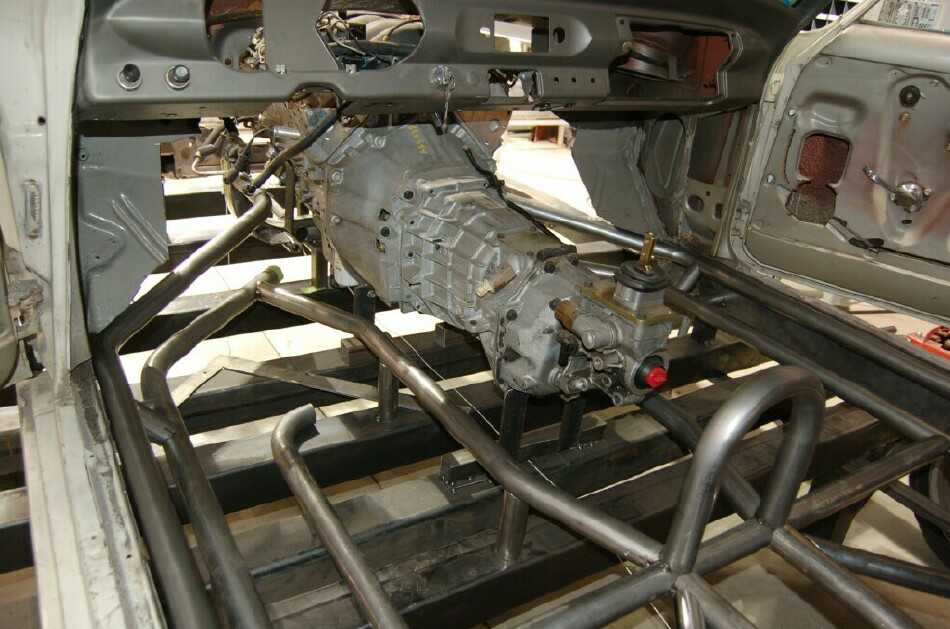

Default UPDATE time
Ok so some pics of the upper rails starting and the A sneak peak at one rear rail we will install tommorrow. Enjoy. You can also see the problem we are having routing the tubing to the Chris Alston crossmember. I called ATS today and I think their pan will solve this problem. The tape line on the tube is where we cut off the previous tube and the tape line on the engine is where the ATS sump on their pan gets moved back to from stock. If worse comes to worse we may slide the engine back about a 1/2 To 1" to make things fit.
2 guys working today, without looking at time cards 20 hours ish.
Rodger

So when you build these round tube chassis, do you build them on the computer first and then lay them out. Or have you done this enough to just know what works?
Also, i see when you cross brace the floor section of the frame with the X's, you dont join the cross bars in the center of the other two bars joining perpendicular, you put them just before the joint. Is there a benefit to this rather than fitting the tube in the center of the joint?
Is that 1/8'' plate you weld to the rockers when you attatch the body to the frame?
If you get a chance to answer these questions i would be very greatful, thank you.
