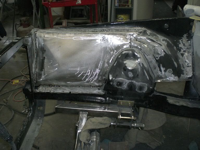

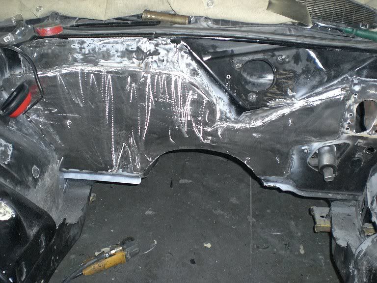

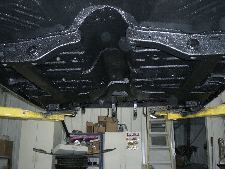

well not much time left to get it done for the power tour but I'll take it even if its in primer, with all the customer projects and this depressing winter it's been a slow moving project but I made some good progress this week making the trans tunnel and smoothing out the engine compartment, I hope by next weekend I'll have the underside bedlined and the engine compartment painted so I can start putting this thing back together. Here's a couple pics maybe some more next week.

Looks good .......why are you leaving the cut-outs in the inner fenders?? just curious
RobS
With the headers and that big ol hemi I thought it would be the only way to get to the alignment bolts, I'll make covers that bolt in so you wont notice the holes, on the drivers side I left the front stock because I'll put an air box there.

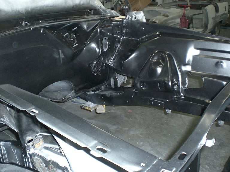

Well heres what my easter weekend consisted of more engine compartment hell but I finally got it painted its a dark charcoal with semi gloss clear

well one week later the engine and tranny are back in and painted the bottom is bedlined all the accessories are on it's starting to look like something, the suspension will go on next and I'll put the rear end together 390 gears and moser axles.
