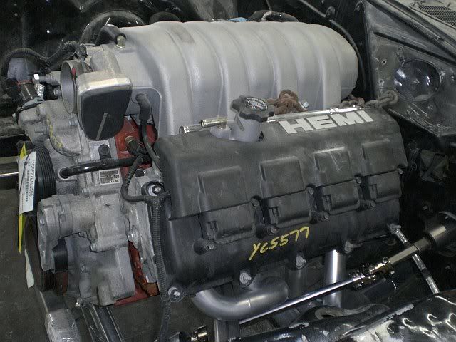

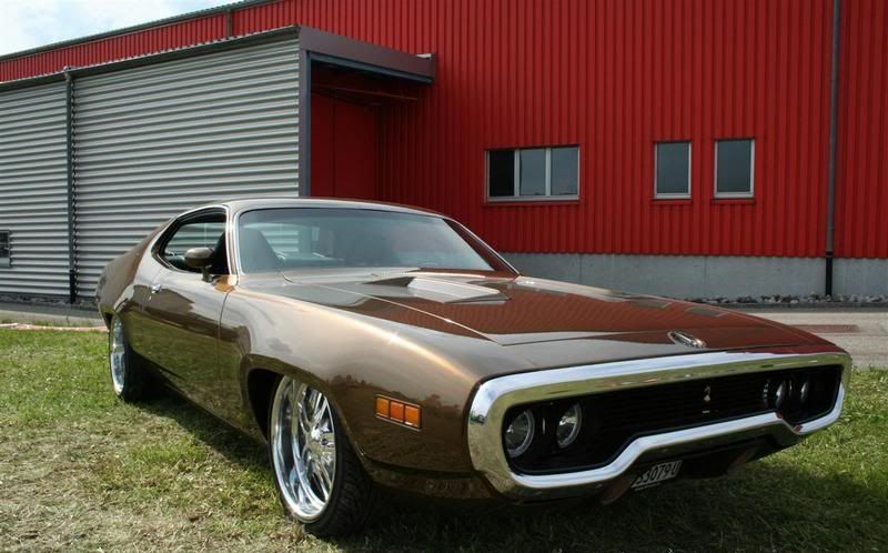

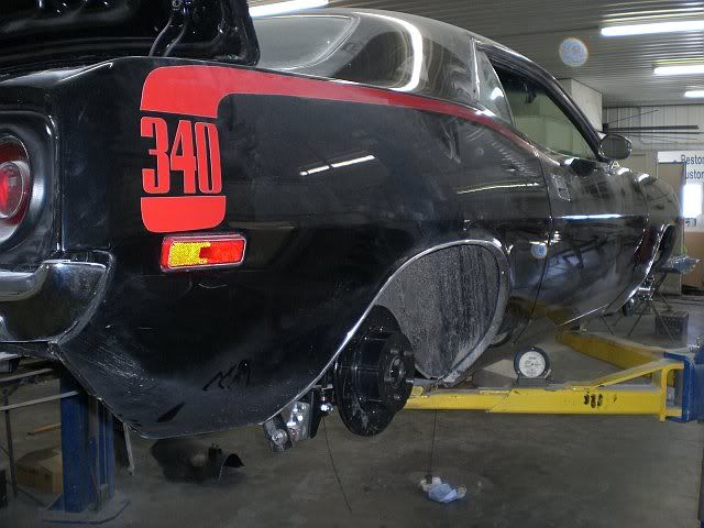

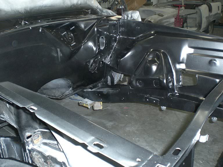

Here's a couple pics, just mocking the drivetrain in now, 6.1 hemi, alterkation k-member, air bar, going pretty good hopefully by next weekend I'll have the exhaust and everything complete so I can dissasemble and start the body mods, I'll post more pics here and there, theres some more @ my website violettoautoworks.com click on blog. thanks telly p.s. its not like a blackened grouper sandwitch it's like the metallica song

Looks good......are those TTI headers or custom??

yes I went with tti's they fit excellent.

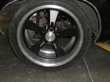

what do you thinks of these, I'm thinking 18 & 19's or 19 & 20's not sure but I think this is the right wheel for me.

those look great.....what are they?

budniks, its between this and the gasser d I think I'm going with these

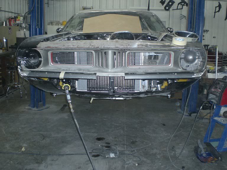

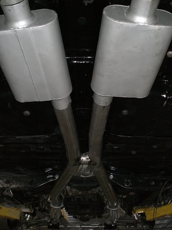

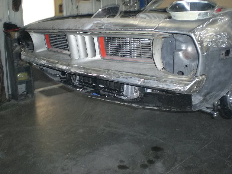

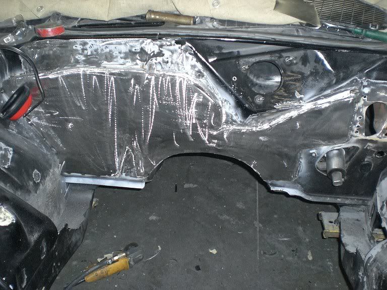

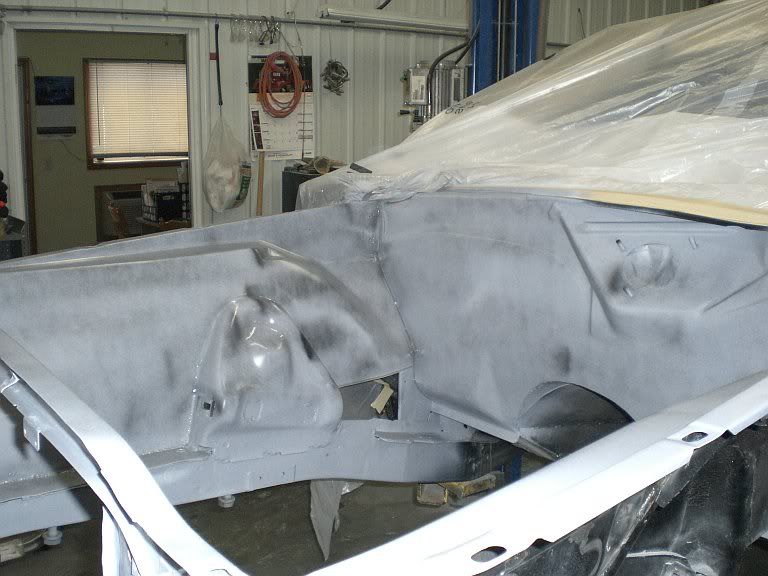

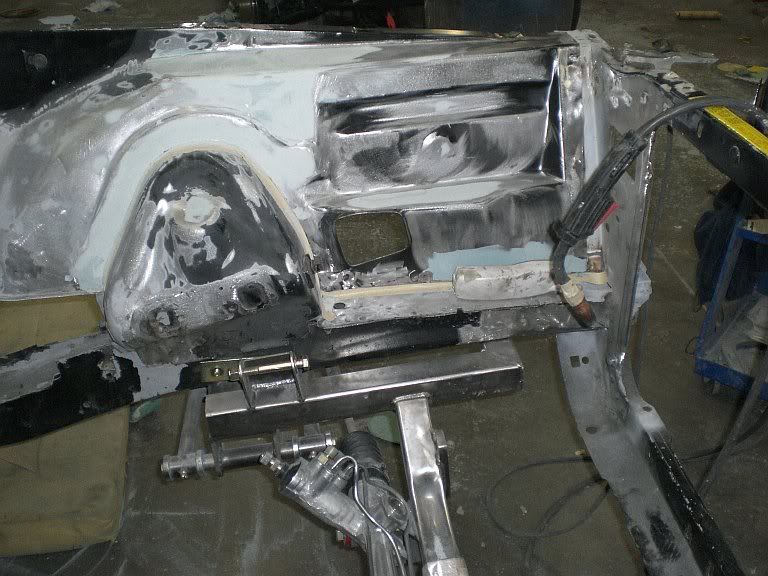

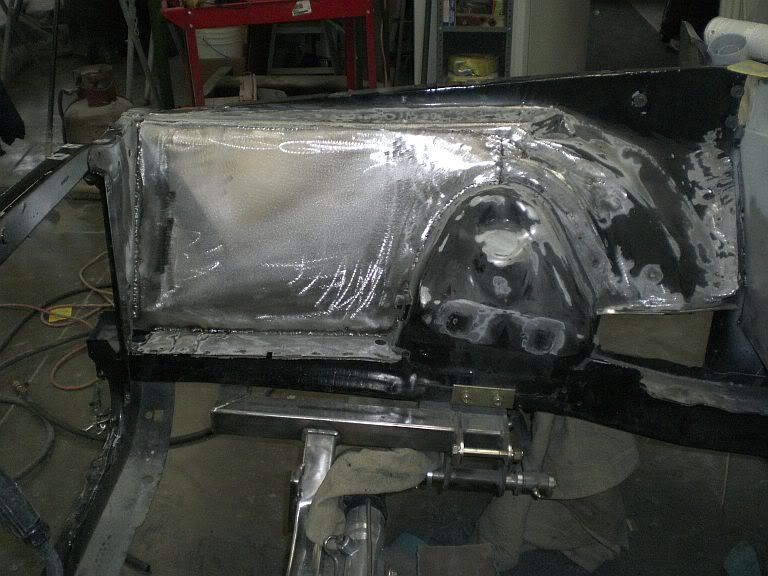

well here's a couple pics of some progress, exhaust it in 3" mandrel bent tight fit but looks good, I worked all day on the front bumper I took 2 69 camaro bumpers and did some chopping its almost done have to do some more welding and smoothing but it looks pretty good ( yes I seen troy do this with sick fish I dont like to copy but its was easier than building something from scratch) I'll move to the lower valance next not sure what I'm going to do with it yet. Then I'll start on the firewall and engine compartment.
