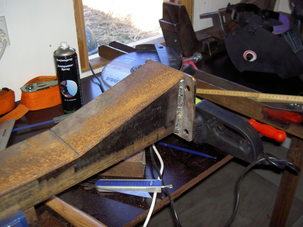

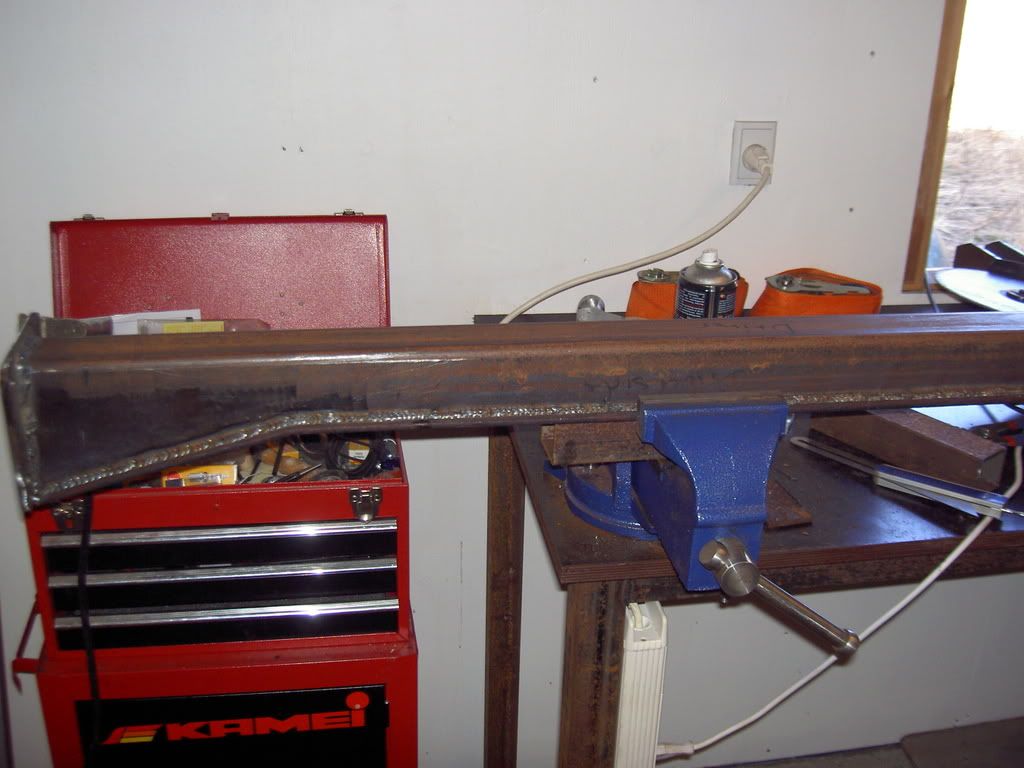

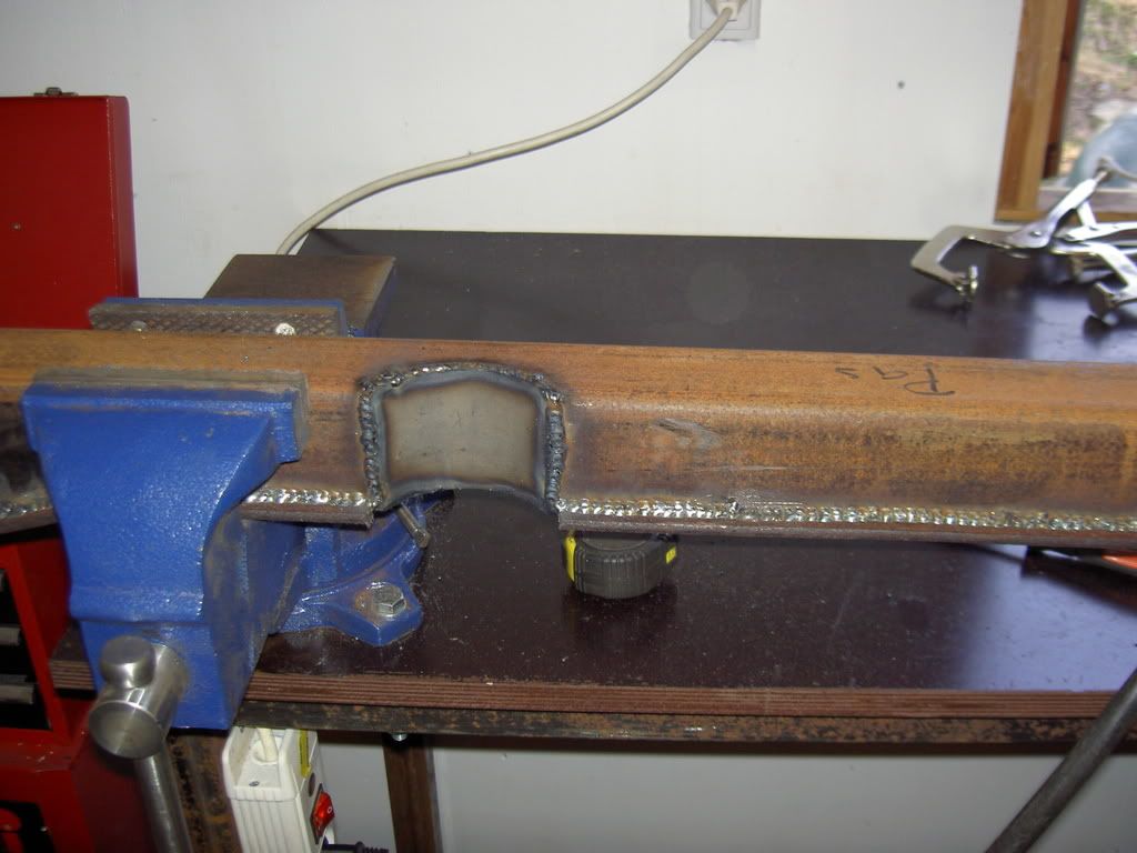

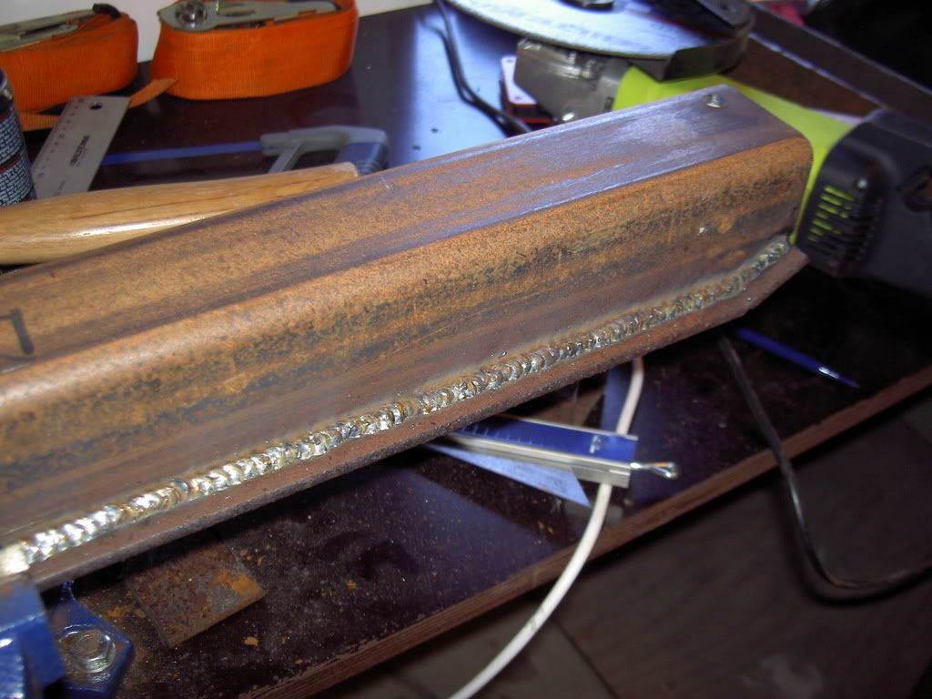

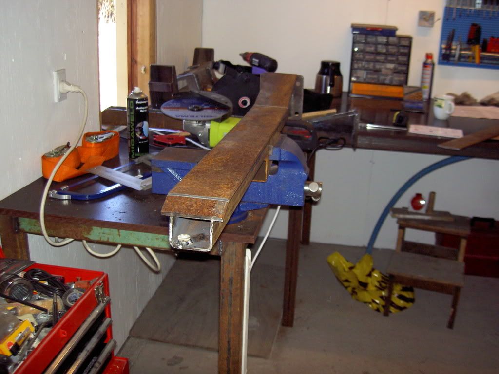

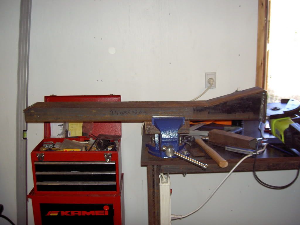

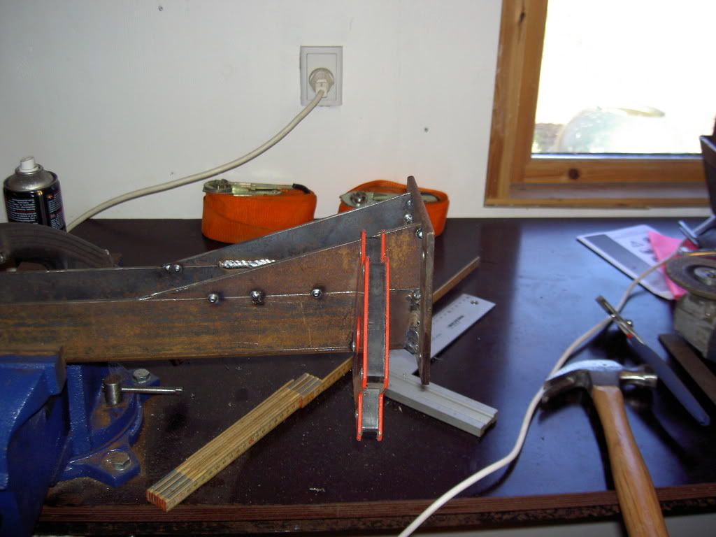

Got some progress on the front end this saturday. My idea behind is, is to have the rails appear as stock as possible, this might help me get it approved for the streets, otherwise i have to bolt up the old front end to have it approved and then swap to my home fabricated again, but i take those worries later on, for now it is very fun to fabricate everything myself. My initial plans was to have the entire front welded together and the suspension bolted up and on the ground in order for me to have the measurements to order my new wheels. But the first hurdle was that i did not get my spindles with everything i ordered, but they should be on the way now. And then i was home kind of late saturday night so i was not that productive sunday.
Hopefully i will make a bit progress during the week, and then next week i am off from work, in order to make som mayor progress hopefully.
  #20

A little more pictures:
