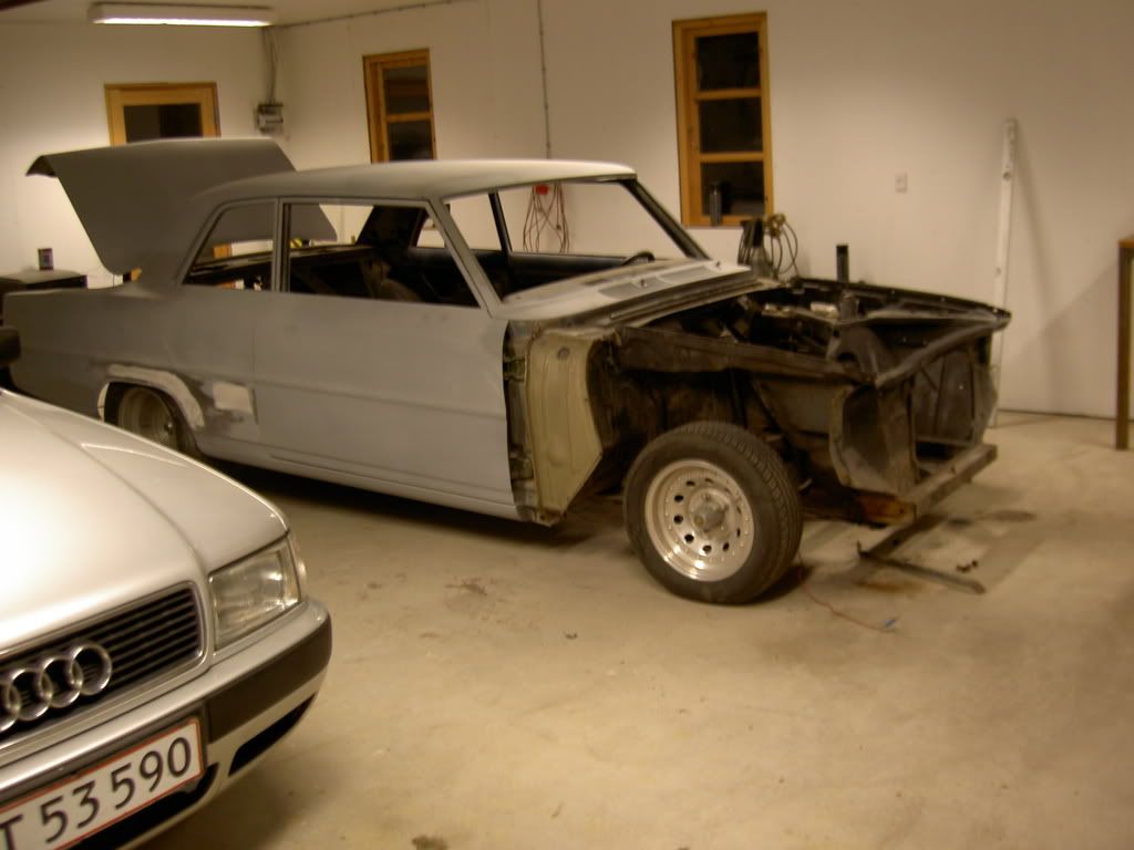

Now i will start a thread for my project. Is has been "on" more or less a year or so, but not much has happened because of different circumstances. But now i have a deadline for when the car should be running. Or atleast when i would like to have it running. Therefore if everything goes according to plan there should be quite alot of progress the next couple of months. I recently bought i new house, which has an nice garage that i am also upgrading along the way.

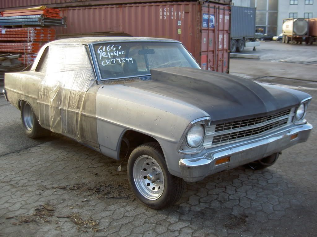

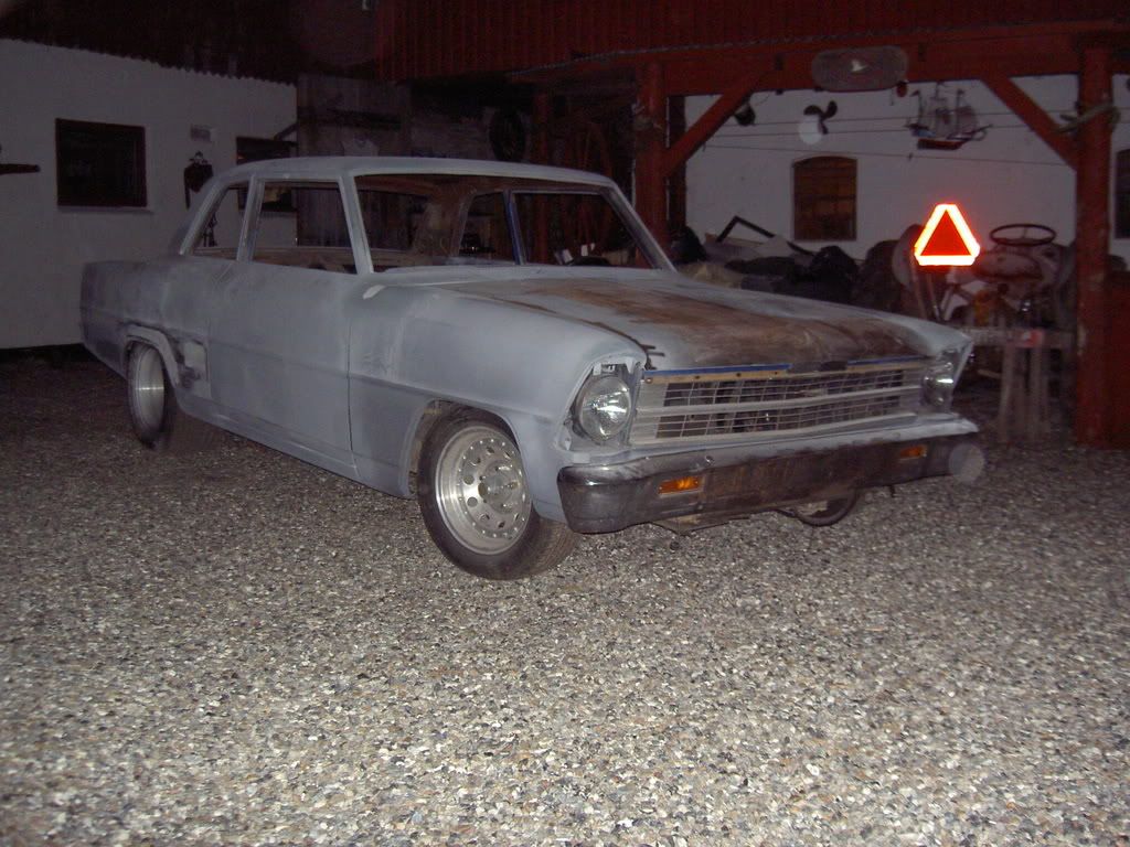

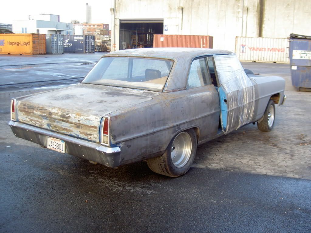

The car is an 1967 Chevrolet Nova Sedan. I bought it a year and some months ago on ebay, and it arrived to Denmark propably a year ago. This is how it looked when i picked it up:
The car was bought without engine and transmission. But it had got an minitub, 9" rear with detroit locker and an aluminum fuel cell. Everything was with the car except for engine and transmission. Later on i bought an LS1 with 4L60E of ebay. My first plan was to mate the LS1 up with an TH350 or TH400 but half a year ago i came across an T56 on ebay with everything from clutch to pedals. This was much more suitable with my plans about building an Pro-Tourer. Very early in the progress i also decided to go for twin turbo's for the LS1, and i have 2 GT35r turbo's that i also bought of ebay. But the twin turbo build will be part of "stage 2". First of all i will have the car running and approved with the LS1 engine.

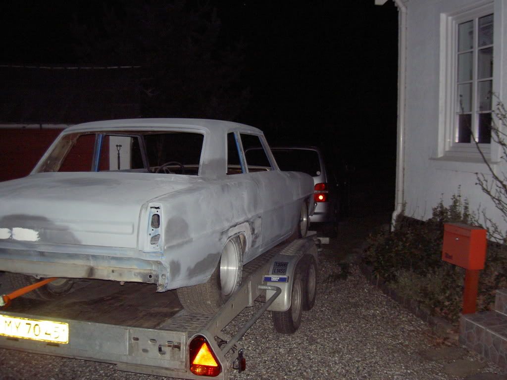

Here are some pictures from when i moved the car to my new garage:

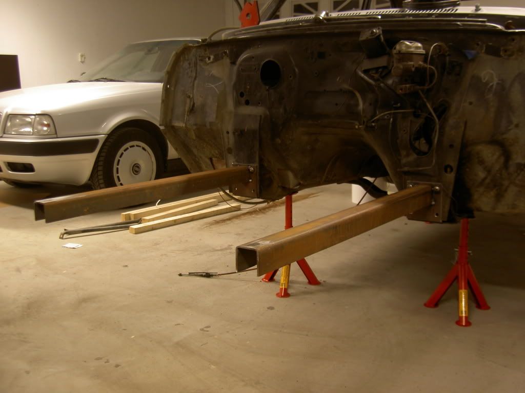

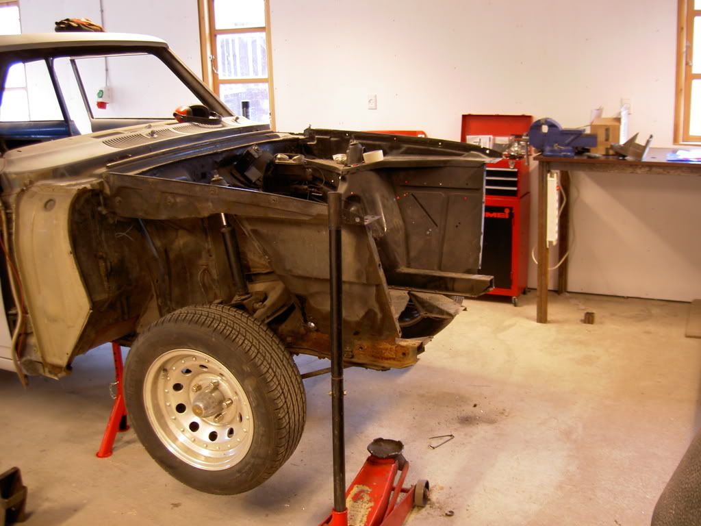

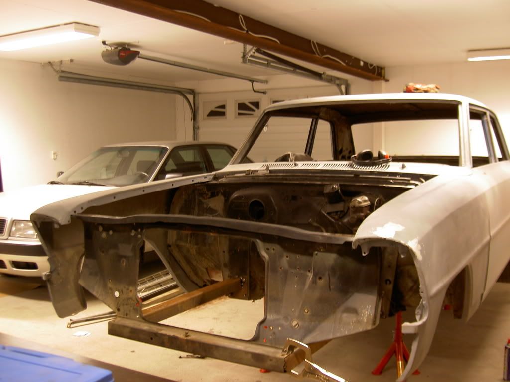

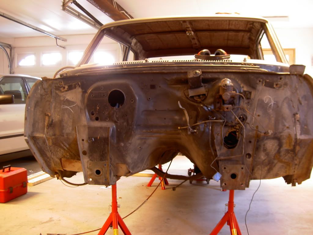

Here are some pictures from when i took apart the frontend:

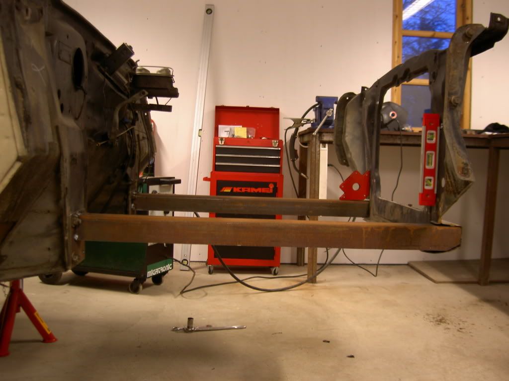

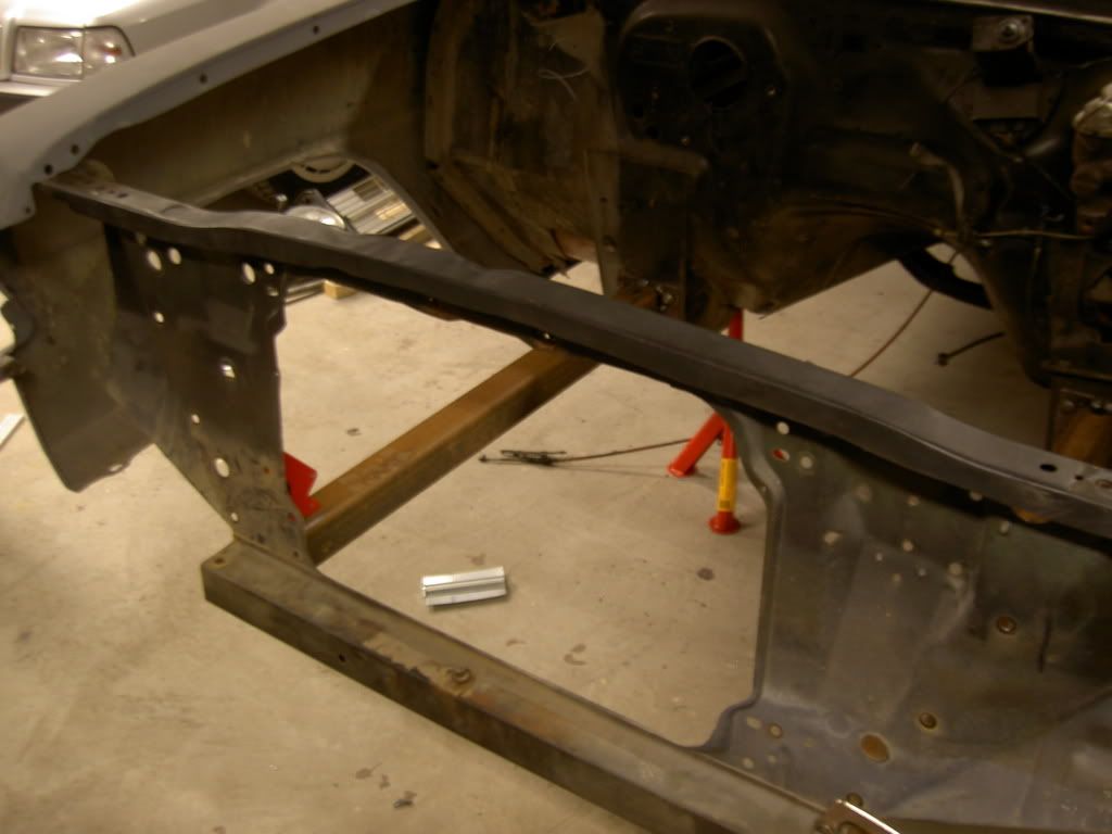

Got started on mocking up the front framerails yesturday. Need to do a little more adjustment before they get some more tack-welds. Then i will mock up the entire front and fenders in order to make sure that everything fits perfectly before welding them solid. And then it is on to the Mustang II components that needs to be welded in. Hopefully it will not be long before i have the controlarms etc. Then i will be able to put the car back on the ground and see how it looks.

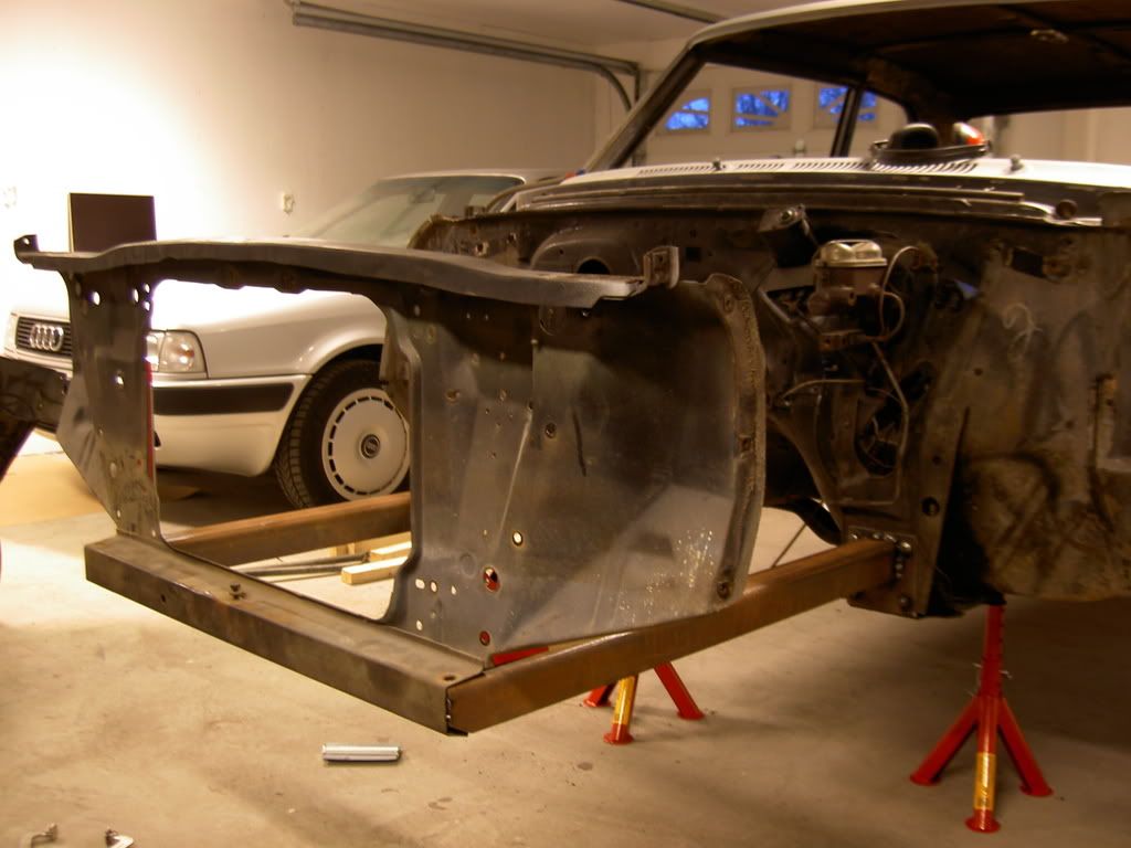

A little progress from yesturday. Was a bit excited to mock up the front fenders and radiator support to see if i had done my maesurements properly. But it did fit very nicely! Also adjusted the framerails a bit so that they now point excatly straight ahead and are parralel. Hopefully i will have the framrails done in the weekend and maybe mocked up the crossmember. When that is sorted out i can start thinking about putting in the engine and making a new transmission tunnel for the T-56.
For now everything is going according to the plan and i have not run into any mayor obstacles that i have not foreseen yet.
