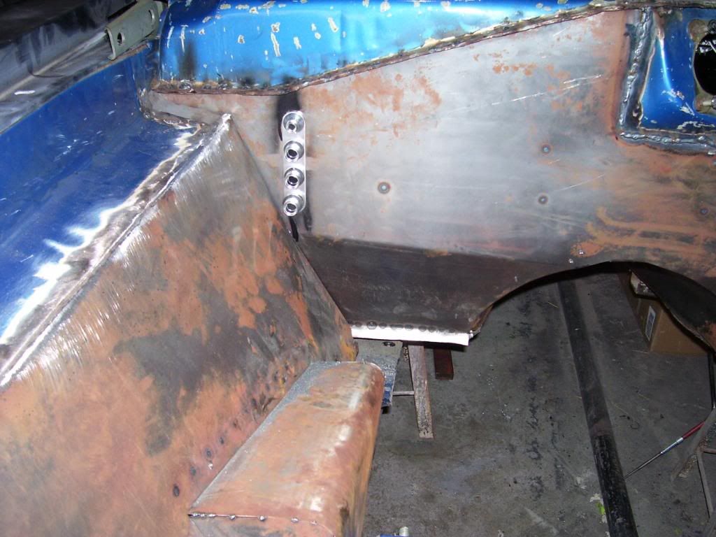

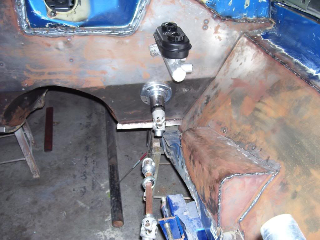

[IMG][/IMG]
[IMG][/IMG]
Here is mine just not completed yet.

Originally Posted by Bakaruda View Post
[IMG][/IMG]
[IMG][/IMG]
r those custom inner fenders??

I am trying my hand at fab work. I have alot of welding and grinding to do. But to anwser your question, I cut the firewall, inner fenders and shock towers out of the car. I then boxed the shock towers in at the top. The boxes are for the upper control arms. I am going to finish welding and grinding then dip the complete car.
