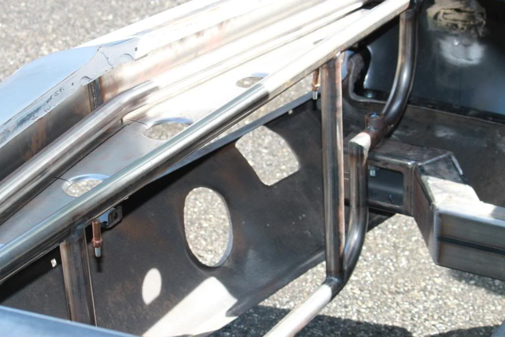

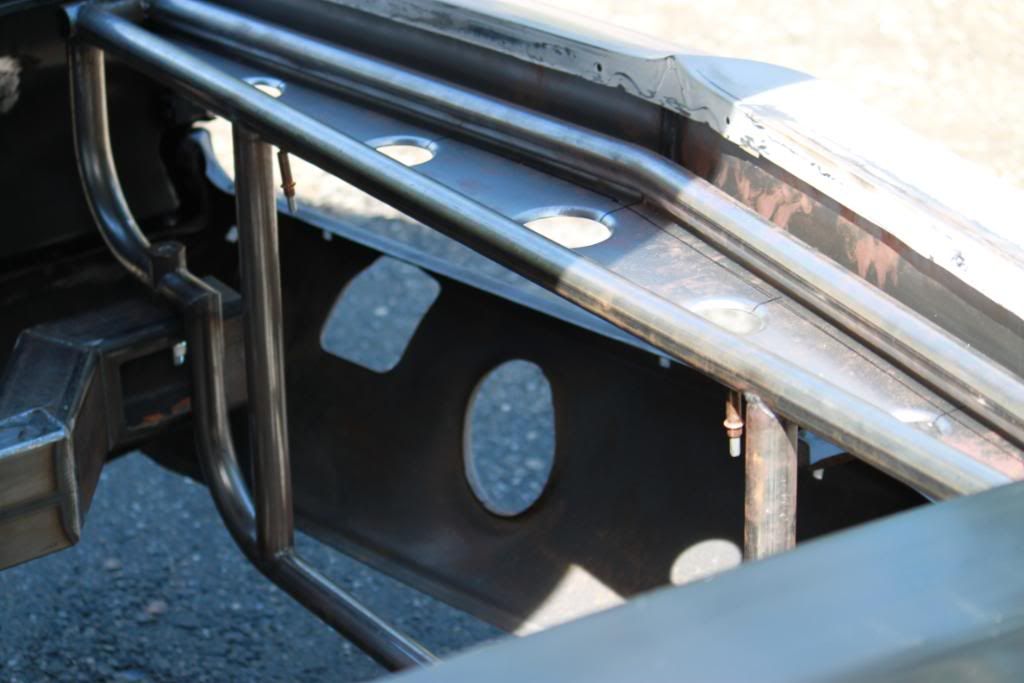

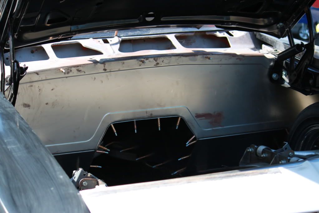

Very nice.
Jake did you remove the pinch weld on the rockers?

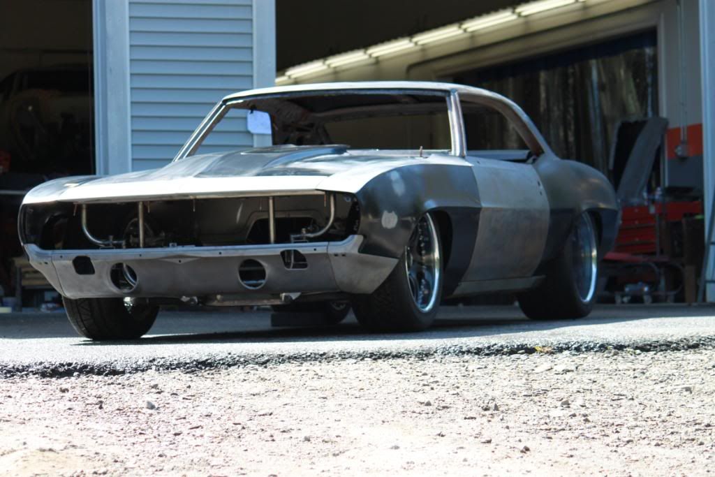

That looks great!!!
I am in the saving mode for my Max G, what ride height is that frame set up for?

a few more

Posts: 1,593
yes, we cut the inner rocker completely out to the upper pinch weld, which is about 1 inch beyond the lower pinch weld, then plated across the rocker with .188 4 inch flat stock, using plug weld on top and solid welding rocker to bottom edge of flat stock, then metal finished to 180 grit. the frame is a 5 inch rocker height, bottom frame height set up.

Thanks Jake.
What kind of ride height?
Are you going to tie it with a cage?
This is going to be a killer project. Please post more pics

Posts: 1,593
yes, car will have a nicely tucked 10-12 point cage, 1.75x.120 dom.
ride height will be 5 inches at rocker, need to make it drivable.

Is that a pre fabbed firewall or something you made? If so where to purchase?

We made it. i have a template and can make one pretty easy., it can be with or without the wiper motor opening.

Looking good. Love the smoothed firewall.
