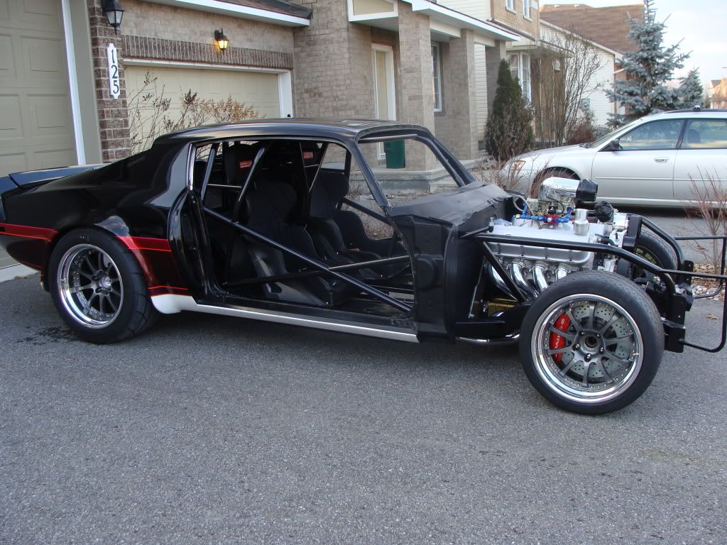

I had the intercooler mounts made at the chassis shop so when it came home it was in the car. After this pic was taken I had the intake shortened 2 inches to lower the over all height of the motor in the car. The carb hat was also changed from the one on the dyno to the extreme velocity one. It is said to make 25-30 more horsepower then the stock procharger hat.

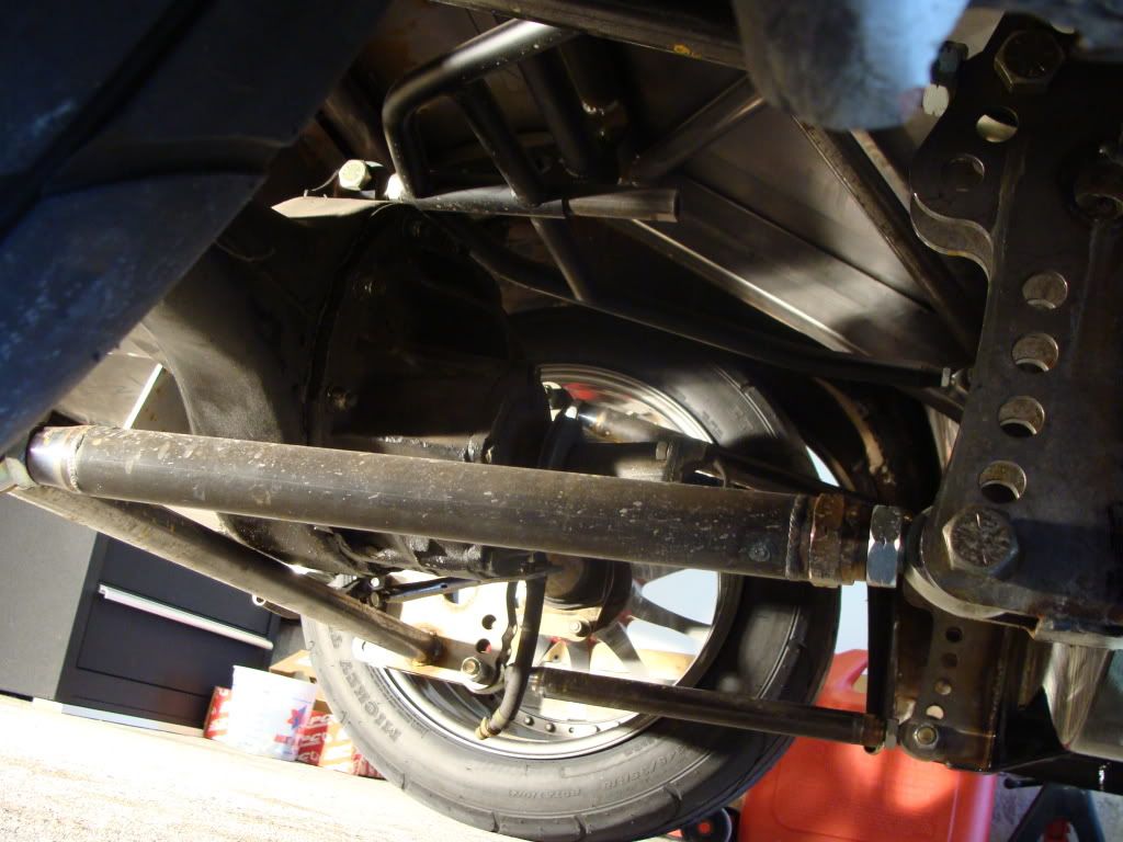

The rear suspension was made to articulate to avoid binding but I may adjust it if needed when I get to the cornering part. There is a large center brace to keep it from shifting side to side.
Pardon the surface rust, I haven't stripped and painted this portion yet.
