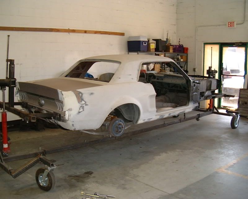

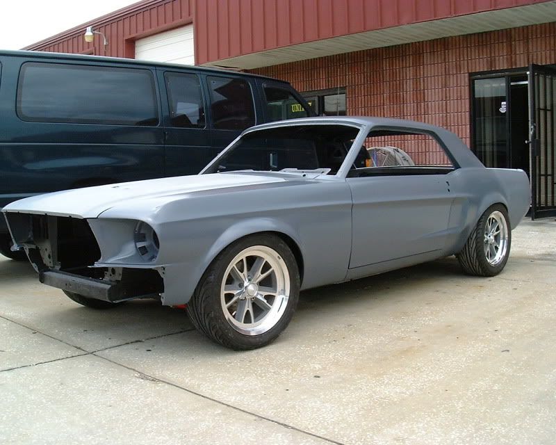

The car looks great, nice work! What are you going to use for rear brakes with the big bearing old style?
  #13
Old 02-19-2010, 09:31 PM
GPR's Avatar
GPR GPR is offline
Join Date: Jan 2010
Location: Port Richey Fl
Posts: 660
Thanked 12 Times in 11 Posts
I plan on disc brakes not sure of the brand yet. I want the car to set low so we will have to narrow the rear since it was out of a 63 Galaxie and once we install the brakes it will be to close to the quarter.

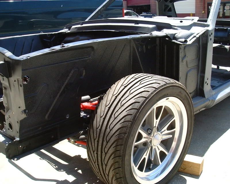

The fender aprons were sprayed with SPI bedliner the engine compartment is epoxy primer

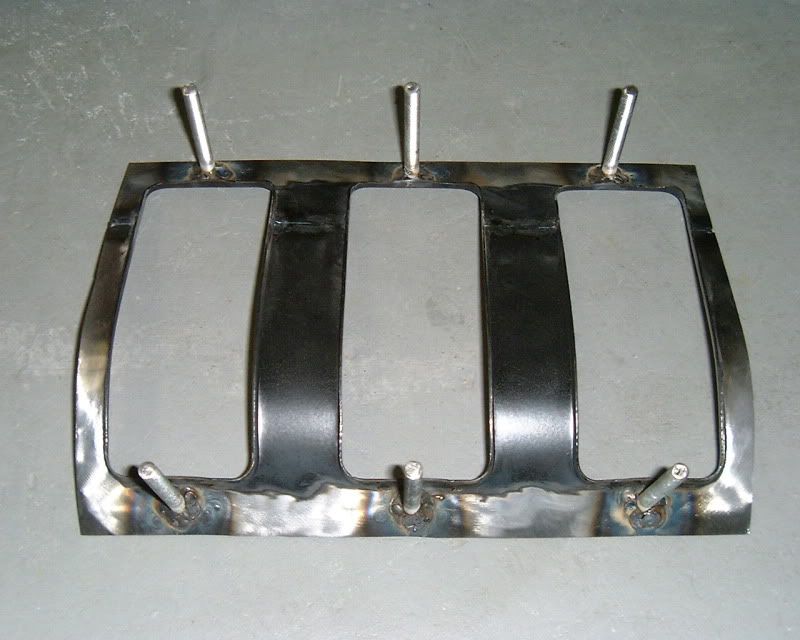

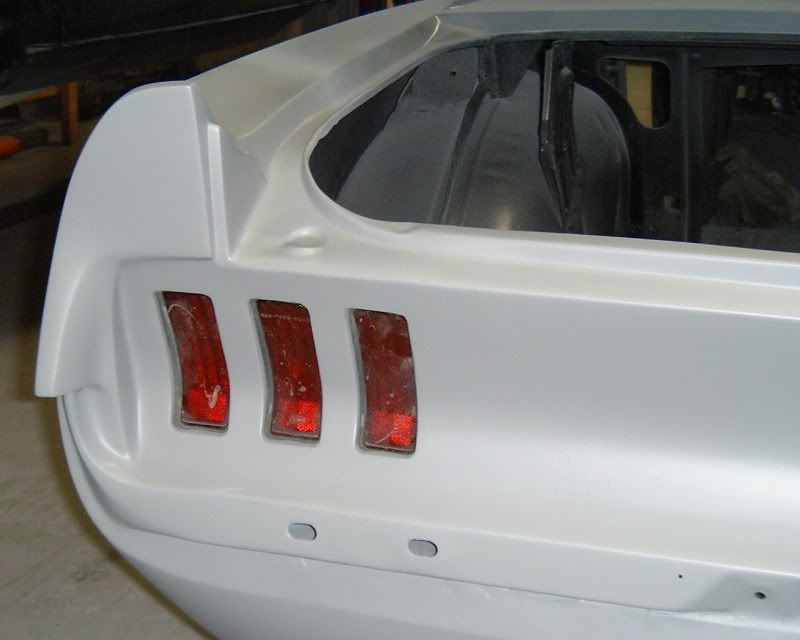

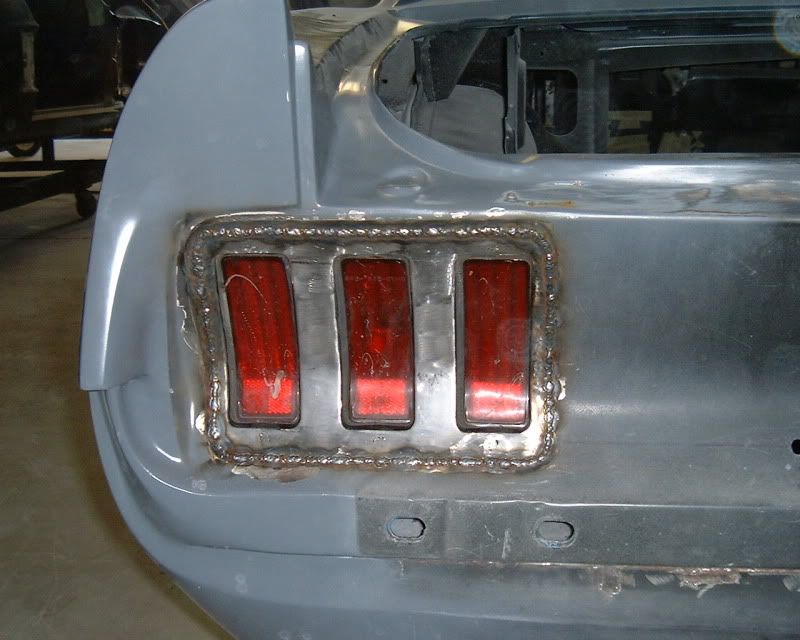

At one time I was going to use the deluxe taillight panel but we did this instead.
I still need new lenses.

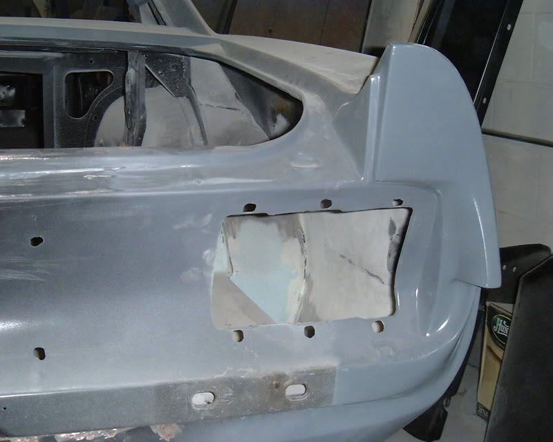

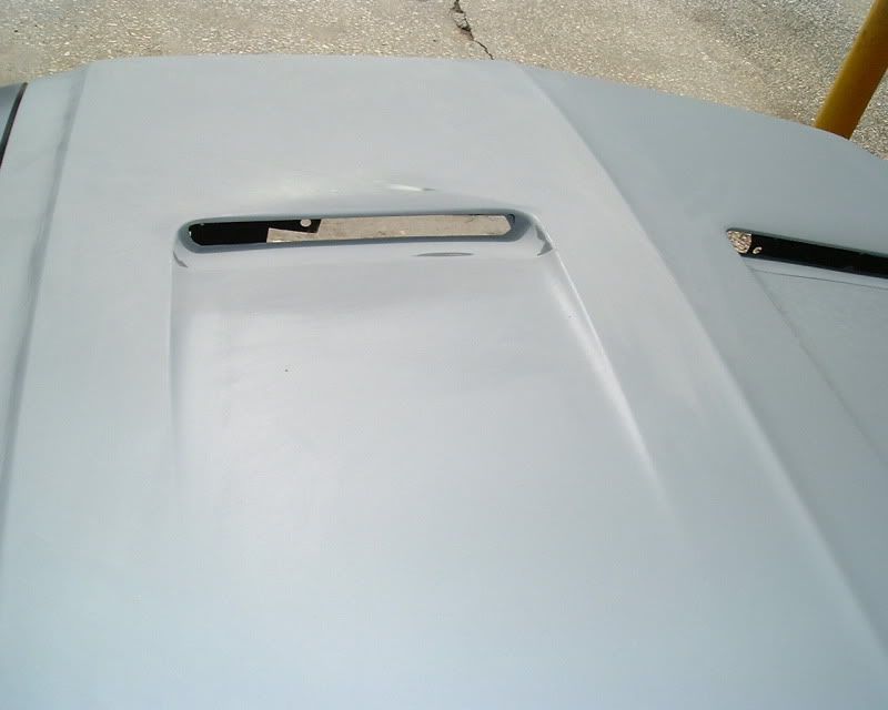

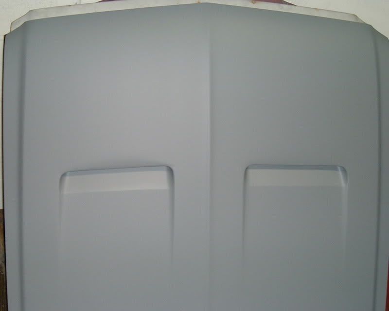

I modified the hood by bonding the turn signals to the hood and making them an air extractor.

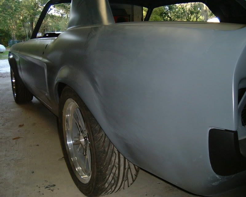

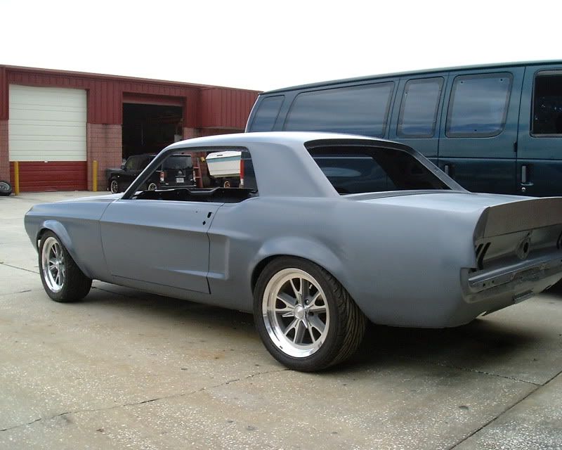

The major body work is finished on the body. I still have to block it out and work on the gaps.

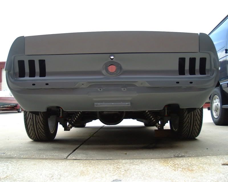

It has been awhile since I worked on my car so this weekend we took out the 63 Galaxie 9" and narrowed it 2" so it would be the same width as a Mustang.
After it was narrowed
