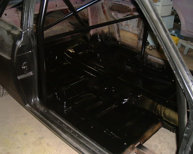

It has been awhile since I did an update.
The roll bar has been epoxy primed
I started the first of a lot of block sanding and priming on the quarters to make them straight
I thought the bodywork was finished but I had a lot of small dents in the roof I found after block sanding

looks like its going to be nice! You guys put epoxy down then filler over it? That's good, I see a lot of filler over metal these days lol.. One trick that i do is put down etch (on bare metal), epoxy, then a couple coats of urethane primer wet on wet, because the primer sands a lot easier then epoxy, and and you have more material on it so don't sand through as much when doing the mud work.. also its nice to have some primer on it to block right from the beginning
I use SPI www.southernpolyurethanes.com epoxy that sands real easy. I spray two coats than blocked it with 80 to find the low spots. Do my bodywork than spray more epoxy and than two coats of Evercoat Slick Sand. Next step is sand with 80 until I start seeing the black epoxy followed by two more coats of Slick Sand and block with 180 than epoxy prime again.
I had to move my car outside for awhile so I epoxy primed the quarters again before all the bodywork was finished.

We had a little spare time so Brian welded up a few rust holes in the rear window channel and I did some more bodywork
I should have it in prime again soon and than I can start the block sanding.

Today I sprayed 1 coat of SPI epoxy and than 2 coats of Evercoat Slick Sand.

Wow what a difference being one color makes. It looks like the quarters came out nice.
