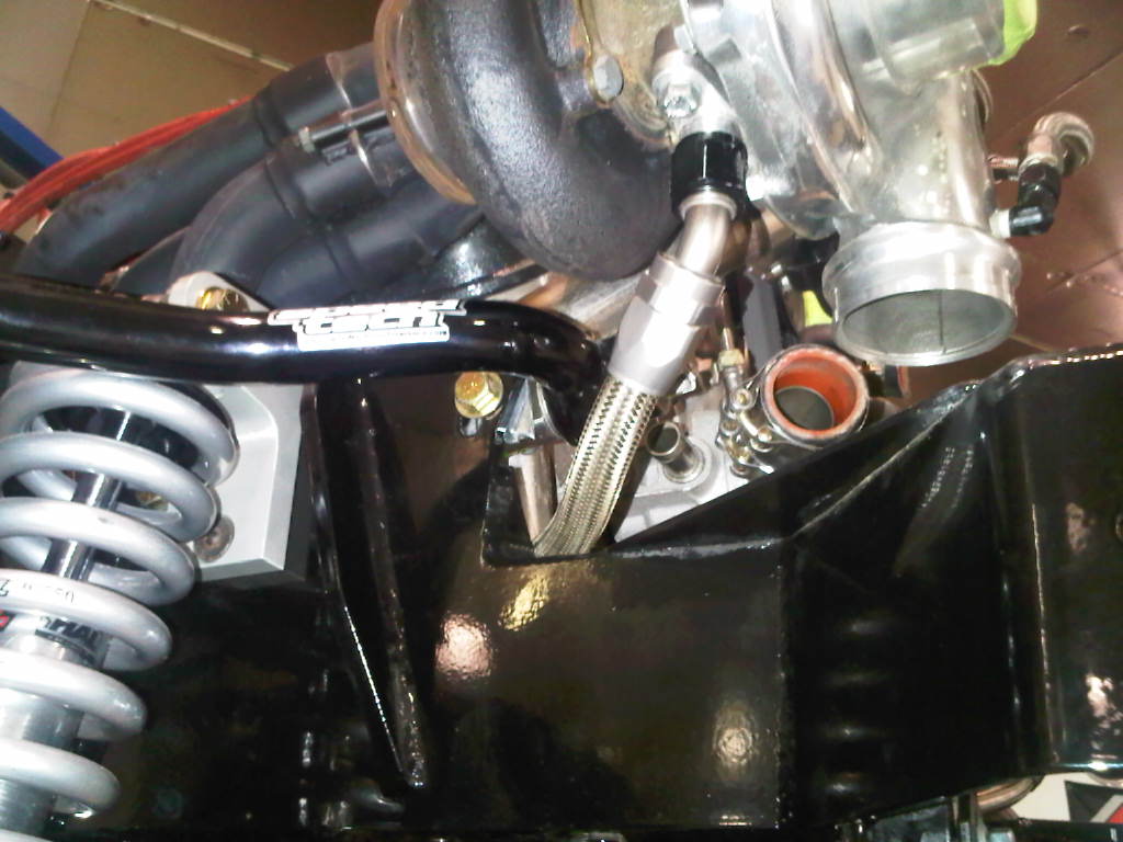

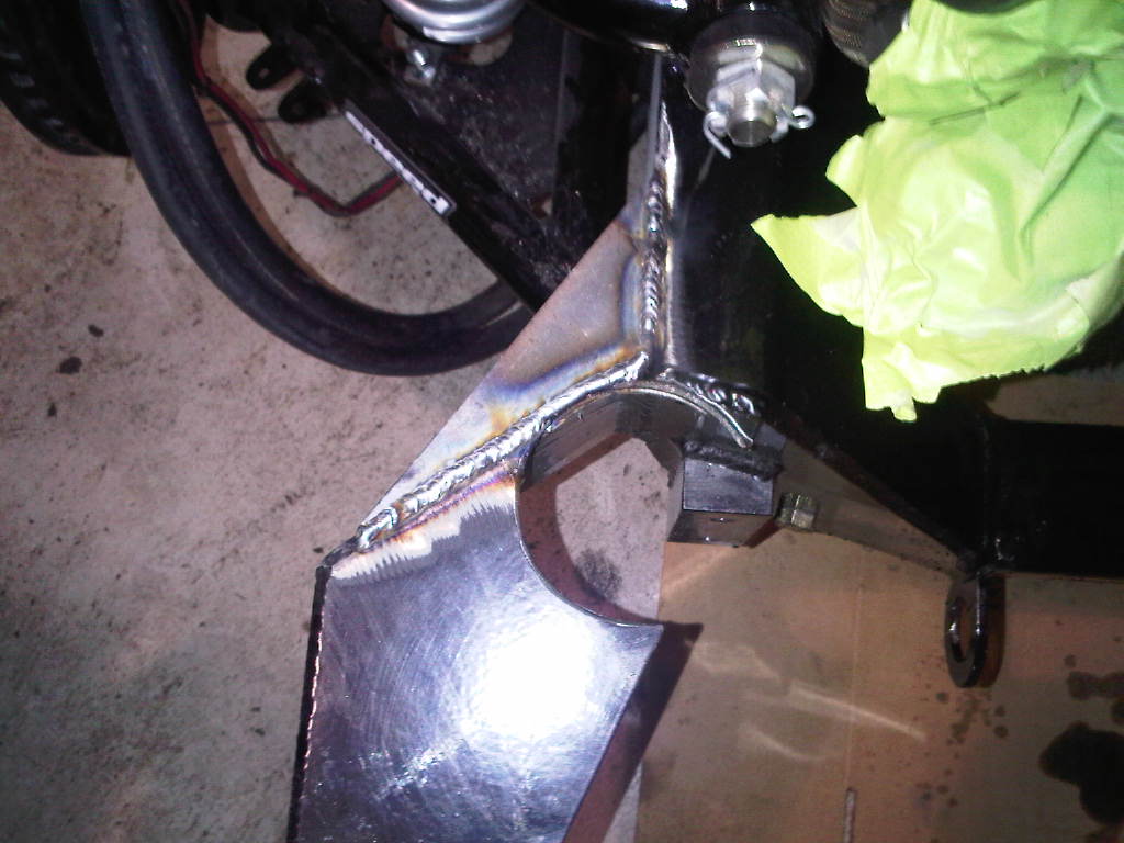

I had it... 3 days it would have been done. Ran into a couple things i couldn't do much about. The radiator is lower on my car so the intake tube can fit neatly under the hood. Because of that.. and the position of the sway bar (its up front just above the front crossmember)... my fan hits it.Also the lower rads inlet/outlet needed to be cut off and a 90 put in its place. So i am on a mission to find a new fan... I also needed to notch out the frame a bit for an intercooler pipe. No big deal.. i hole sawed it.. then welded a brace on the back side to compensate for "weakening" the structure. It came out looking like Speedtech sent it that way. I also did a few other things while i had it apart. Exhaust wrapped the down pipes.. change a dump tube...
Couple pics of my frame notching... nothing to exciting.. this was before paint of course....

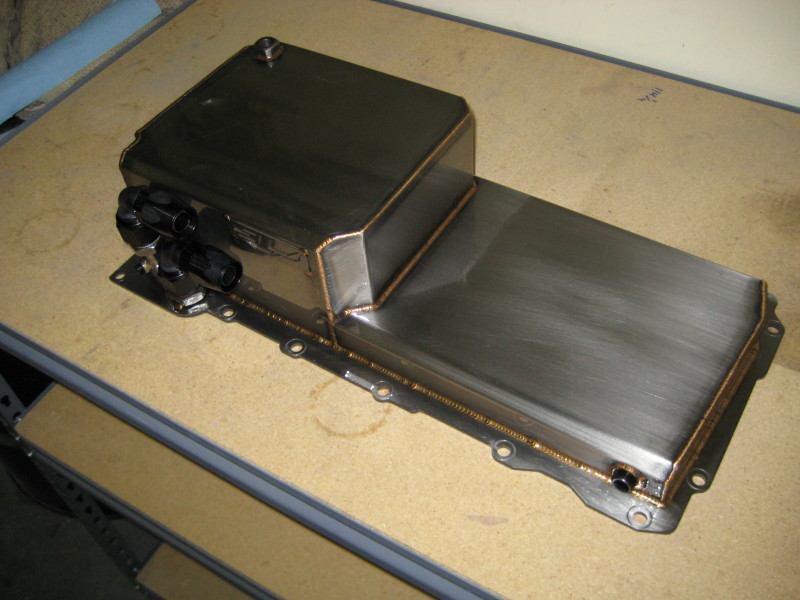

I did just order the ATS oil pan from Speedtech though. The oil pan i have now is just too low. Its the LH8 pan... it hangs too far under the cross member. I have not hit it... yet. This weekend i was blasting around with friends.. and some dips in the freeway got me thinkin. The ATS pan looks perfect. So we are going to swap that out next week.
I'll post some pics of the difference of the two pans once the ATS pan is installed.
Here's a couple pics of the car with the Speedtech frame at ride height with no rubbing... and a pic of the new pan.

I am installing the new ATS pan next week. The LH8 pan is WAY to low. I haven't hit anything yet..... but i feel like its only a matter of time... so yeah.. im getting rid of that thing.
