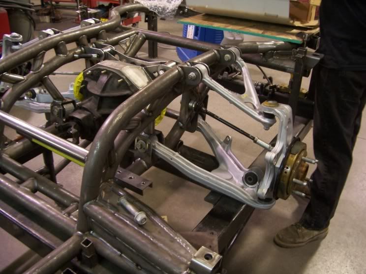

Few more pics:
Made progress with the diff. Have the Moser aluminum centre section in (lightened 3.50:1 gears) with a Wavetrac (http://www.wavetrac.net/) diff. Still waiting on the CV joints before the rear coilovers can be finished.
Getting close!
-- Joe

Looking good. SRIII certainly makes a great looking frame and it works so well too.

x2. That frame is slick...

Man... I wish I woulda thought about having the back half of my SRIII frame like you did. I guess I'll just have to do another Vette when I'm done with the current one.
Great progress on your '64. That's gonna be a beast.

Very,Very,Cool.Who make's the CV shaft's.I can't wait to see more of this amazing build. Scott M.

that is one cool pile of metal you have there. So is that the same ZR1 geometry?
