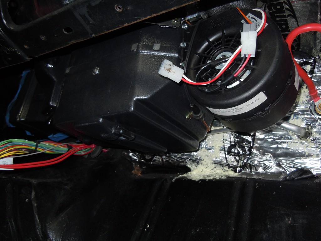

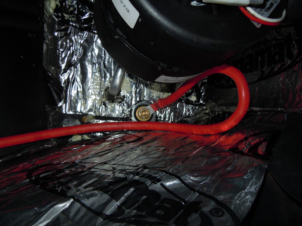

Default More updates May 2011
Here are some pictures of the rough in of the wiring and the completed install on the Vintage Air system. This is the second Vintage Air system I have done and man do the go in just like the instructions !

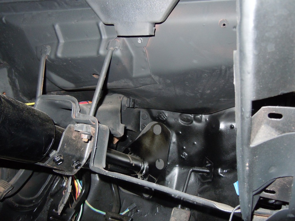

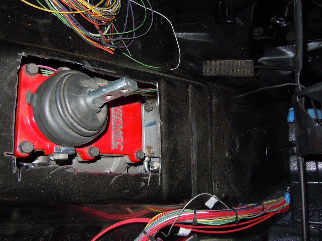

Posts: 59
Default Wiring
More of the wiring rough in and dash area after clean up.
