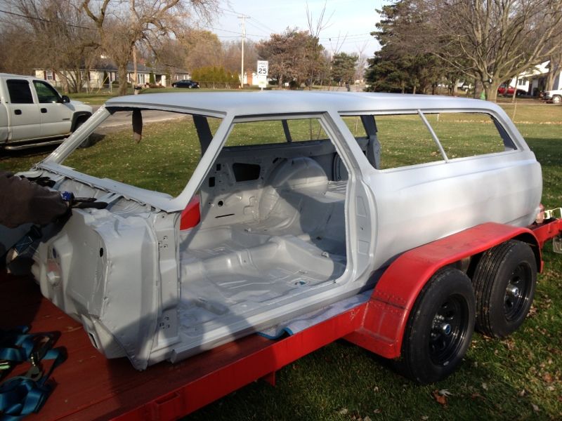

Floors patched

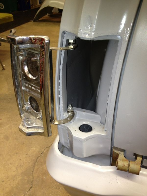

Flush fitting the Tail lights

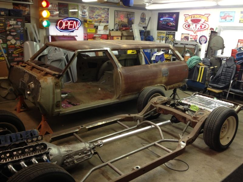

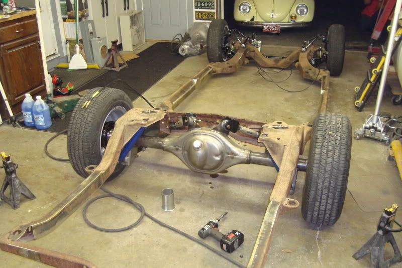

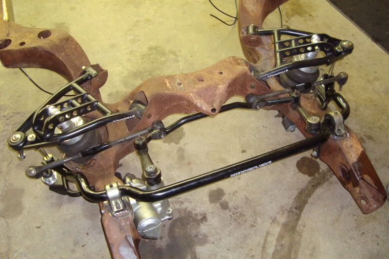

Got the suspension on and mocked up today. Its low... should be cool! The front crossmember is sitting on the ground when you put some weight on it, might end up putting some sort of bump stops on it?
Next gotta get the body back on the frame and start building the tube x-members and make all the engine and trans mounts!
I will probably end up notching the rear floor slightly for the upper rear control arms and to gain a little extra exhaust room.
You can see the frame all boxed in, the rear control arm brackets boxed and a support brace/tube for the upper rear arms.
Finally some pics... -Gary
Also, the big Hotchkiss sway bar didnt fit the factory bracket holes, so we welded a plate to the bottom and drilled and tapped to 3/8" bolts. Using the original front hole location and moving the back ones location. AND you can see how much I had to cut out of the spring pockets for the shockwaves to have enough clearance not to rub!
