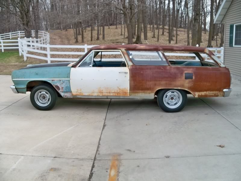

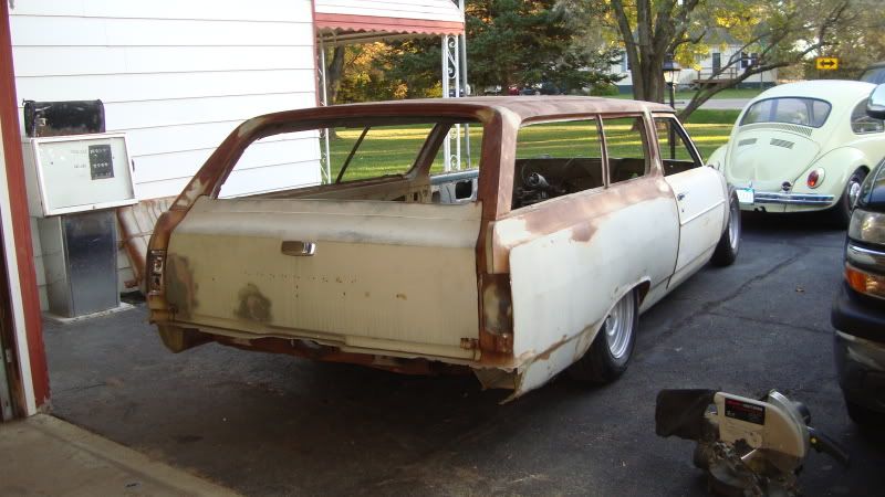

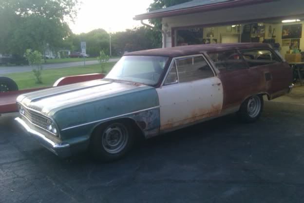

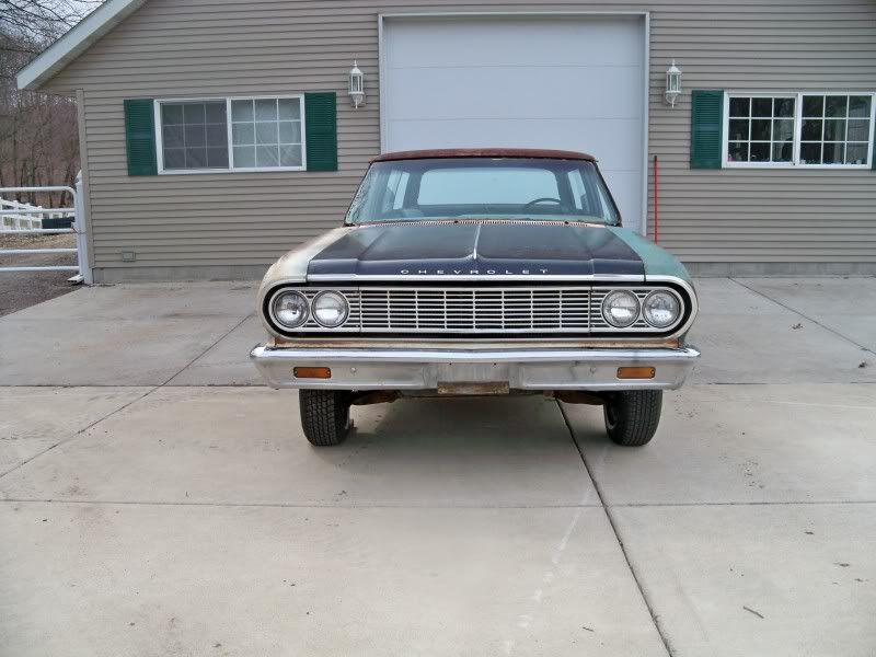

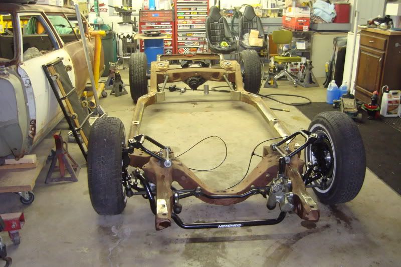

I recently sold my 62 Chevy II and have begun my next car.

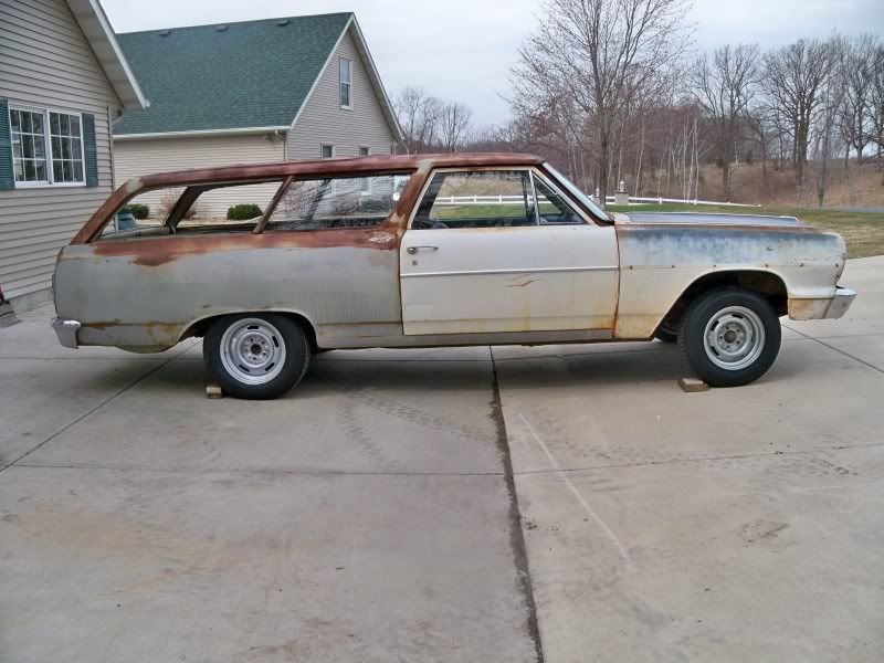

64 Chevelle Wagon, 2 Door! Its a "300" wagon, with the "LS" engine, hence the LS-300 lol

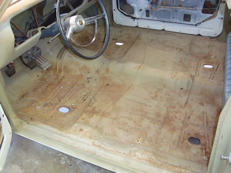

Picked up a SUPER solid and complete unrestored car to start with, its gonna be nice to start with a solid car and not have to patch and make everything for a change! Only rust is in the front floor pans, few dings and dents but thats no biggie. I'm in the process of collection up parts now to start working on it.
So the plans are so far,

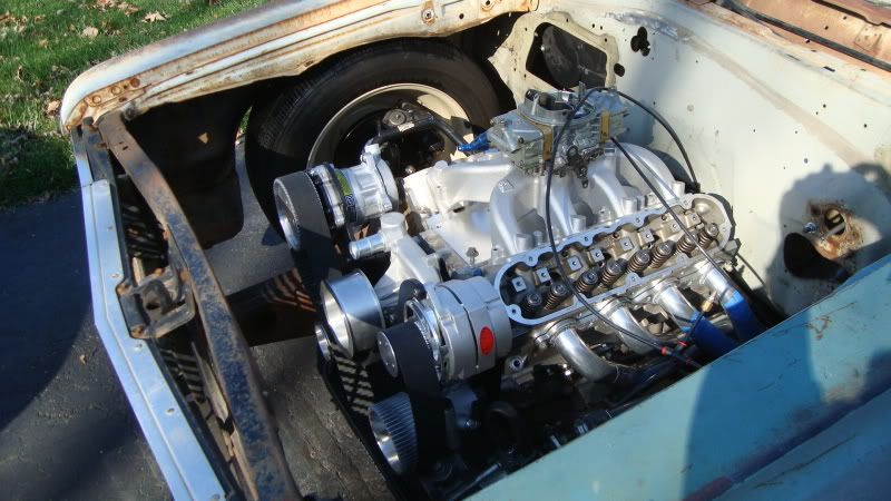

LS engine, Carburated, LQ4 short block, CNC LS3 heads, not sure of cam specs yet.
Overdrive trans, prolly a 2004R, but still have not got that yet.
Moser 9" ford, 3:90 gear

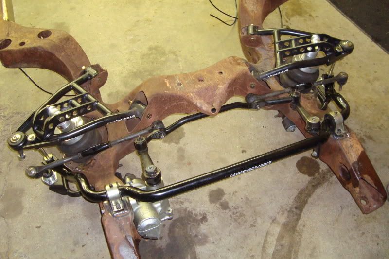

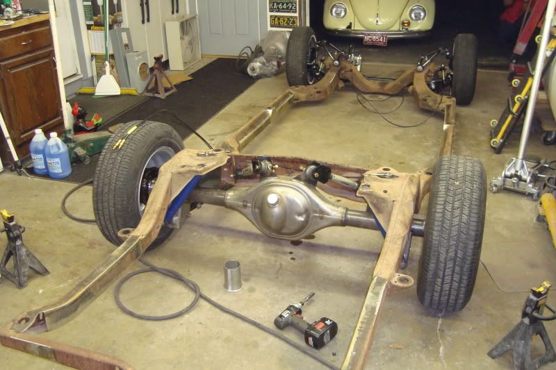

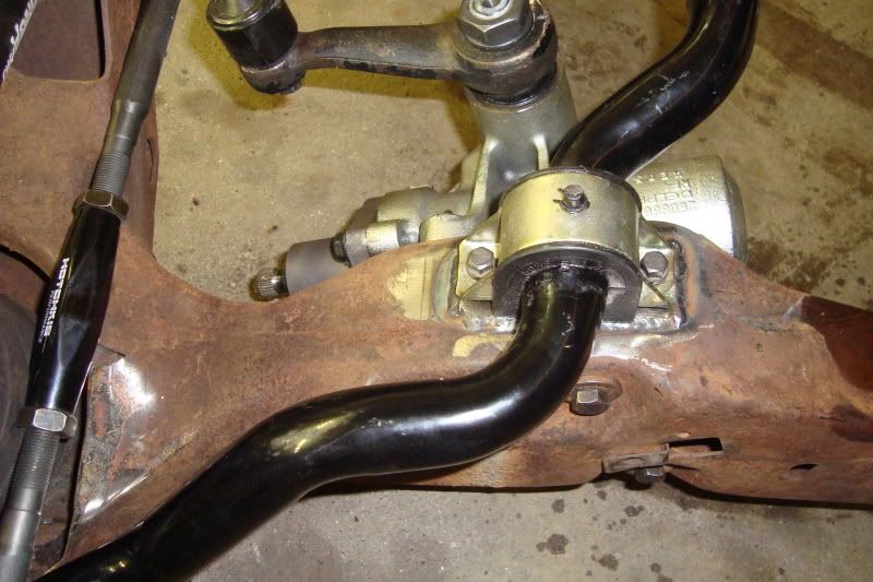

Full air ride suspension I picked up all the suspension from a guy, had less than 500 miles on it all
E3 ride pro system
strong arm front control arms
shockwaves front
hotchkis front and rear sway bars
hotckis steering arms
delphi 600 power steering box
air ride rear lower control arms and bags
hotchkis dbl adj upper arms
Planning to run 17" and 18" wheels
I want to run air conditioning on this one too
Black mountain precision front drive system on the engine
Thats where I am at so far, not sure what all is available for the LS engines since I'm new to them. Same as brakes? I need to get dropped spindles and all the brakes.
-Gary

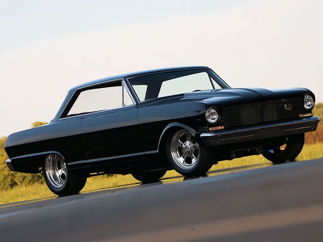

Heres a pic of my 62 Chevy II I just sold, also a pic of my 66 Chevelle SS I sold awhile ago.

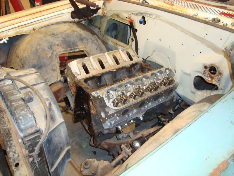

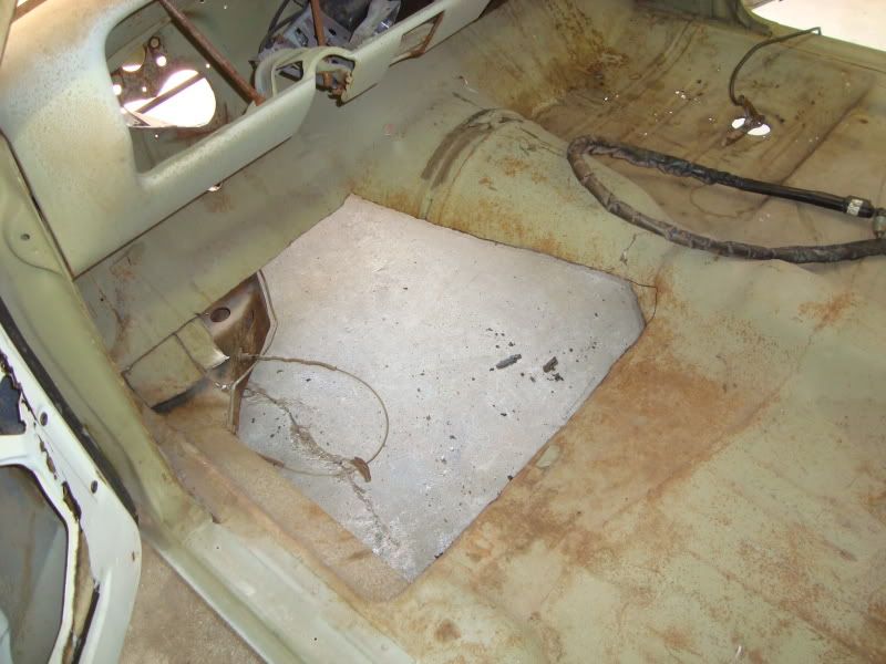

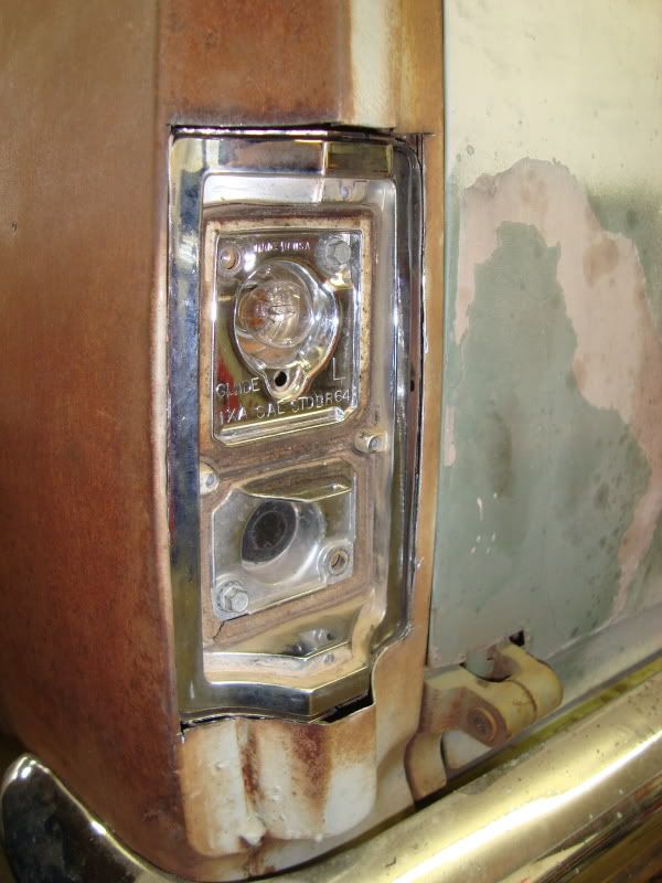

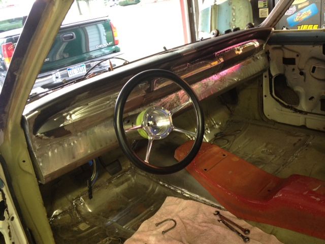

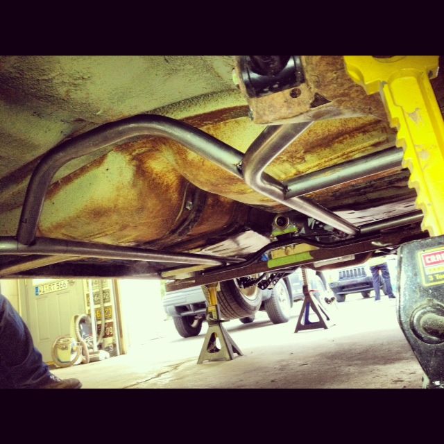

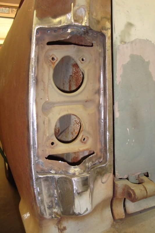

Little bit of an update, pics to follow soon.

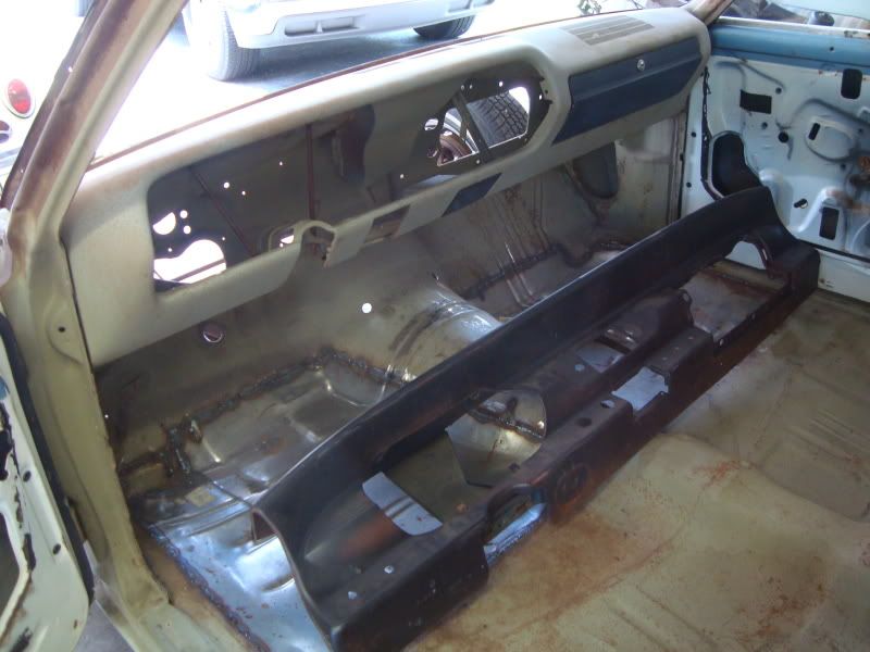

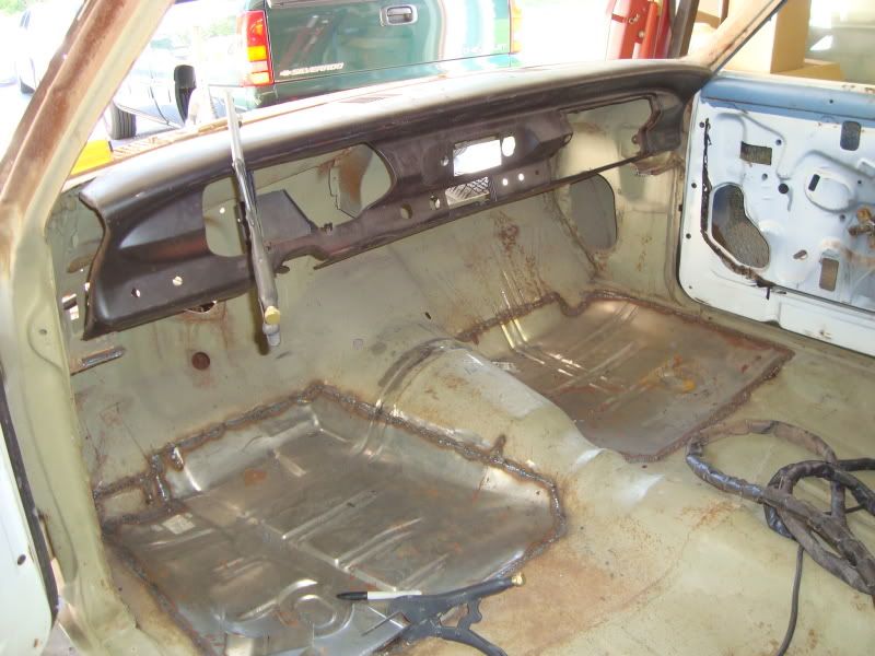

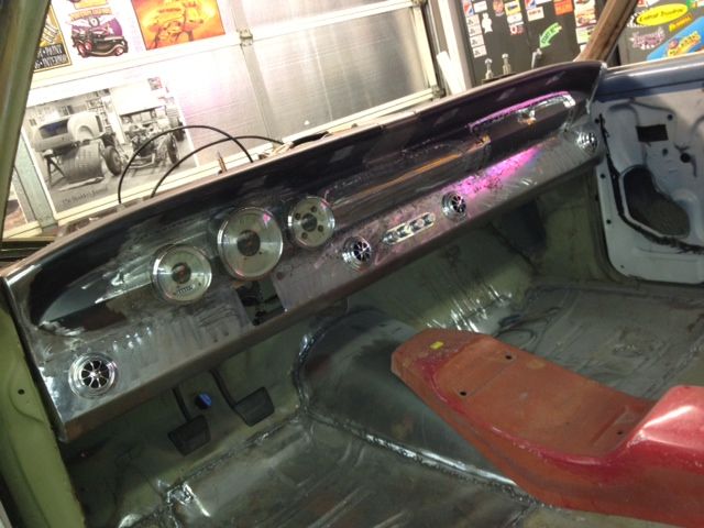

Got the front floor pans replaced (only rust on the car to patch!!)

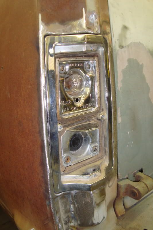

countersunk the tail lights flush with the body
cut out the dash, in the process now of grafting in a 62-65 Chevy II dash
Got something in the works with the rear bumper...

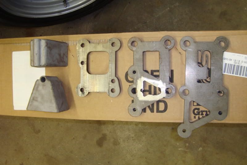

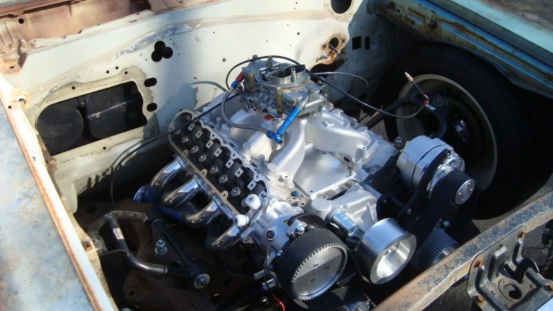

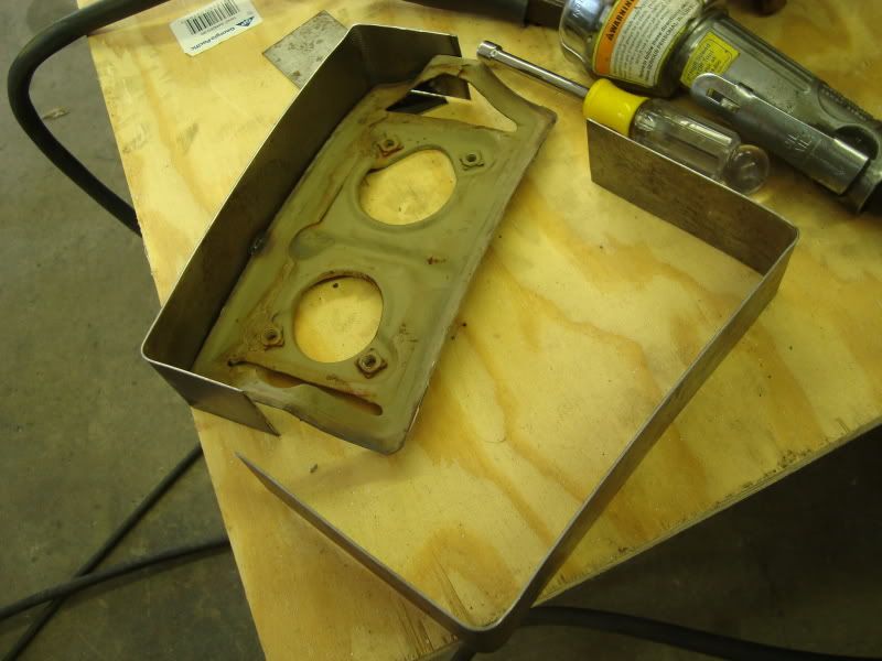

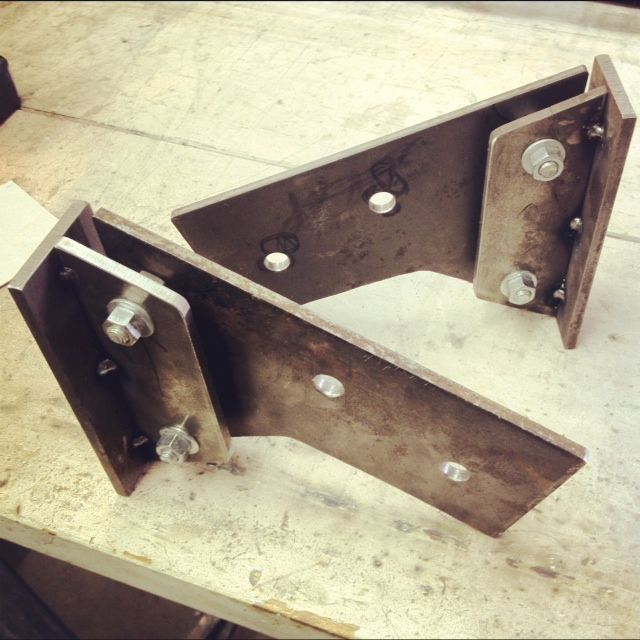

I drew up some engine adapters and had em laser cut so now the engine/trans is set in for mock up and I got some headers
Guys at Scoggin Dickey came thru with all the goodies for me to put together a very stout 416 Stroker motor!
Should move the grocery getter down the road pretty well!
Still working on ideas to get rid of that ugly gas fill door, and something different for door handles.
I'm heading down to Goodguys Columbus to see what kinda deals I can find down there and I can start moving foward
with some of the other stuff, steering, brakes, air cond, etc.
-Gary
