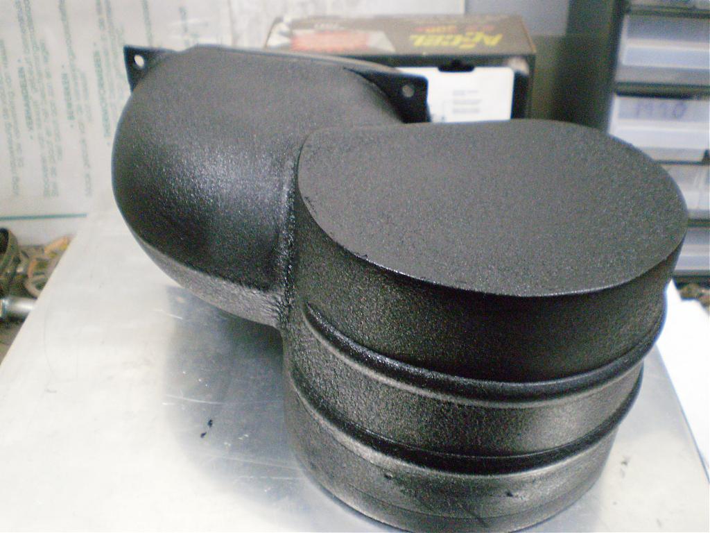

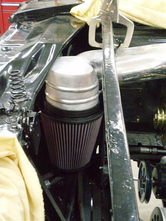

Little something upcoming...
Air filter housing, came out pretty nice..
After wrinkle paint its way more nice...

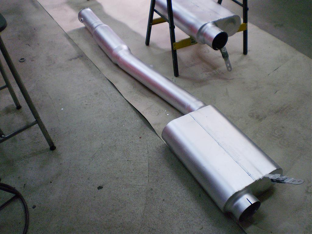

I did also build new 4" exhaust w/ Flowmaster race bullets & mufflers.
Painted with aluminium/silicone high temp paint.

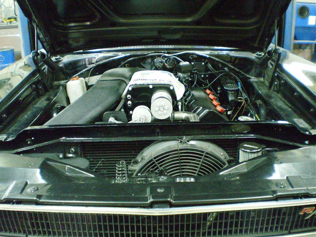

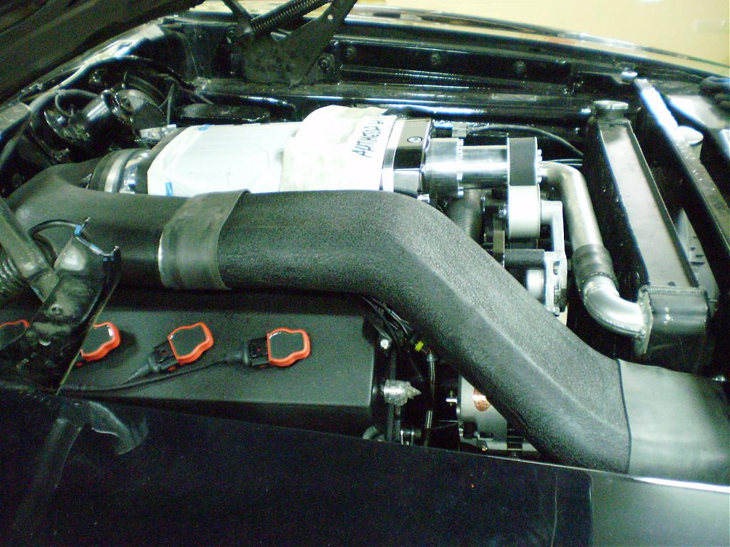

So over 1K views but still not much comments...

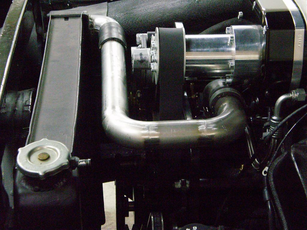

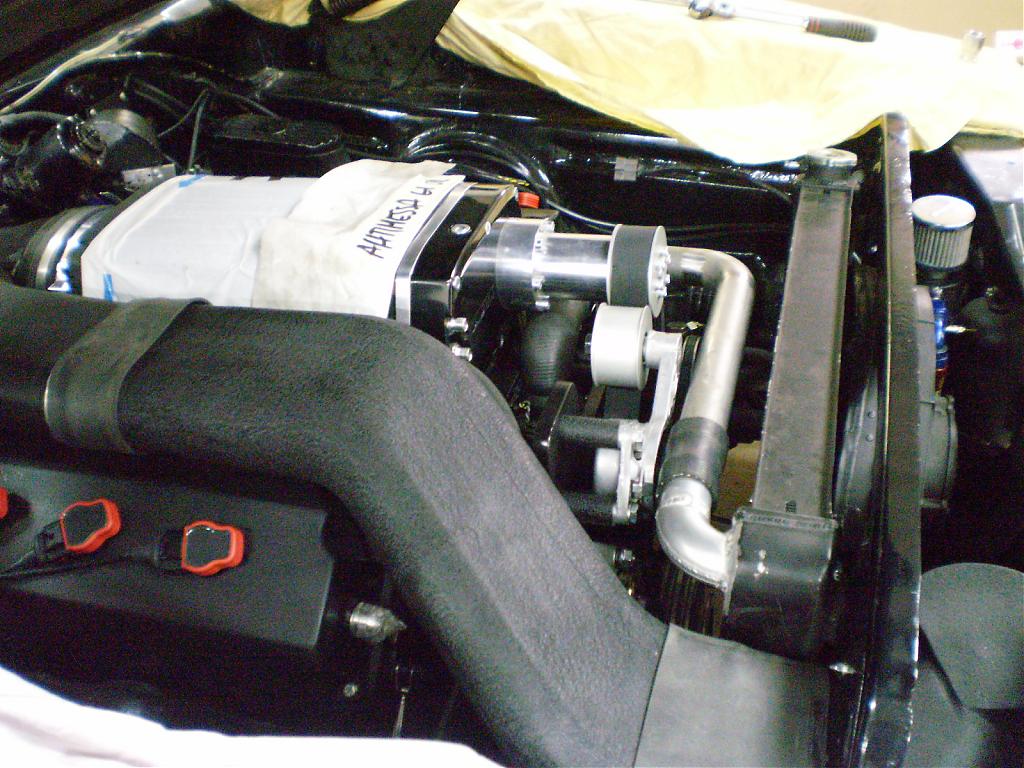

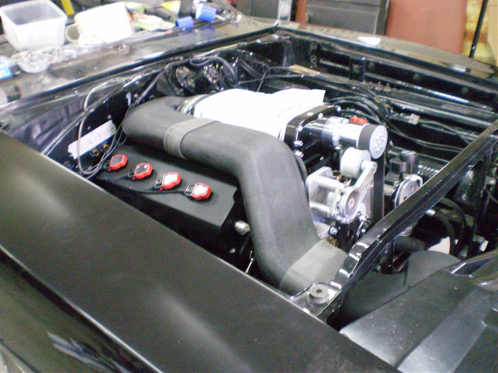

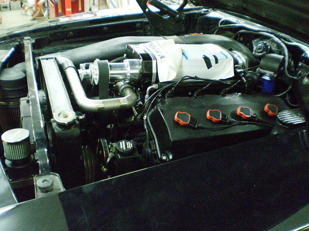

Lets update this then...
I've been busy but electrician how was hired to install Motec-ECU and ISIS-Power has been slow.
He made engine wiring harness and he does outstanding work but it takes so much time.
We are 5 weeks behind original schedule.
Engine is all painted and has been assembled. Cool thing is that it fits under stock hood as plan
Not running yet.
ISIS is unfinished.
Now I have taken it to next guy...
Then to dyno... injector are good around 930HP on E85, Owner says that around 800Hp is enough. This is a street car.
Sorry about the quality of my pics,

So its done on my behalf,
I'm flying to Florida at first of July
, Juhani
