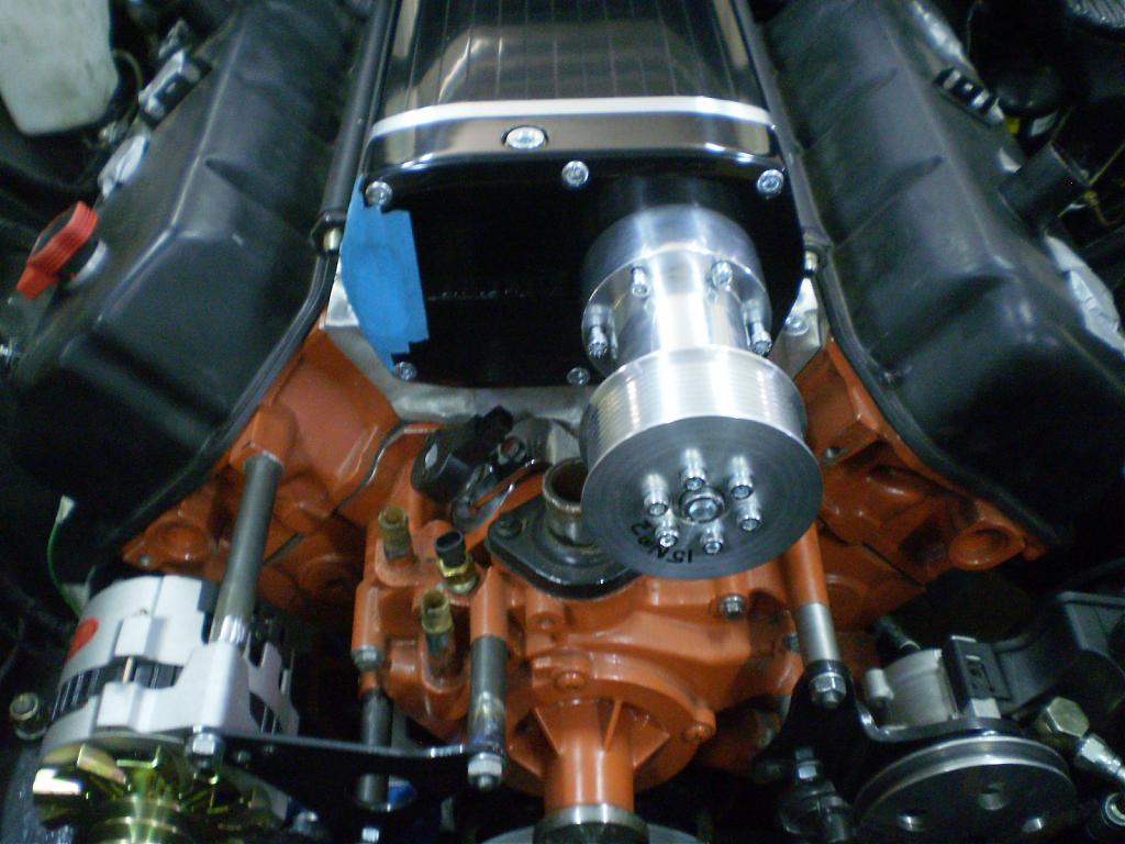

I'm building one at the moment.
Custom made by me
(and with help of some of my talented friends)

Thanks guys. Its going to be a monster!
Well, I think that it got something to do with that we bought three unit at the same time.
And that we bought them from Sweden, where they are made.
About the intake, your right. It was a new BDS intake but not much left, new bottom plate, new top plate and over an inch lower.
Today welding injector plugs and fuelrails mounting tabs...
, Juhani

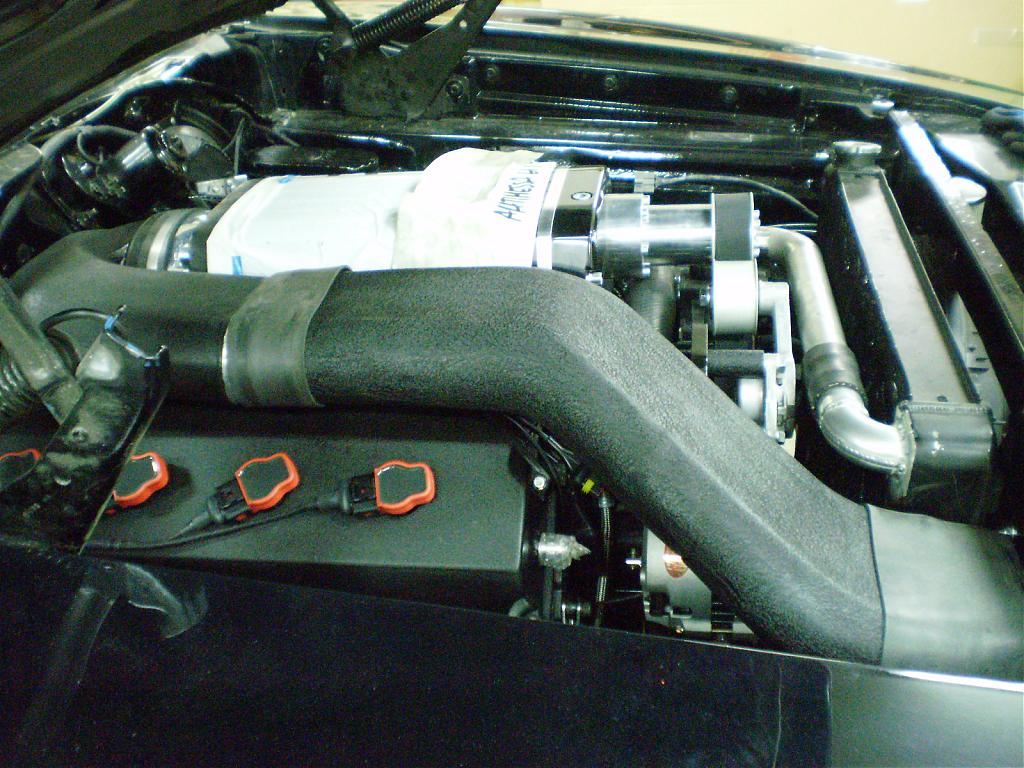

Little progress... and little hiccup, throttle links will not fit, have to make something else...
, Juhani

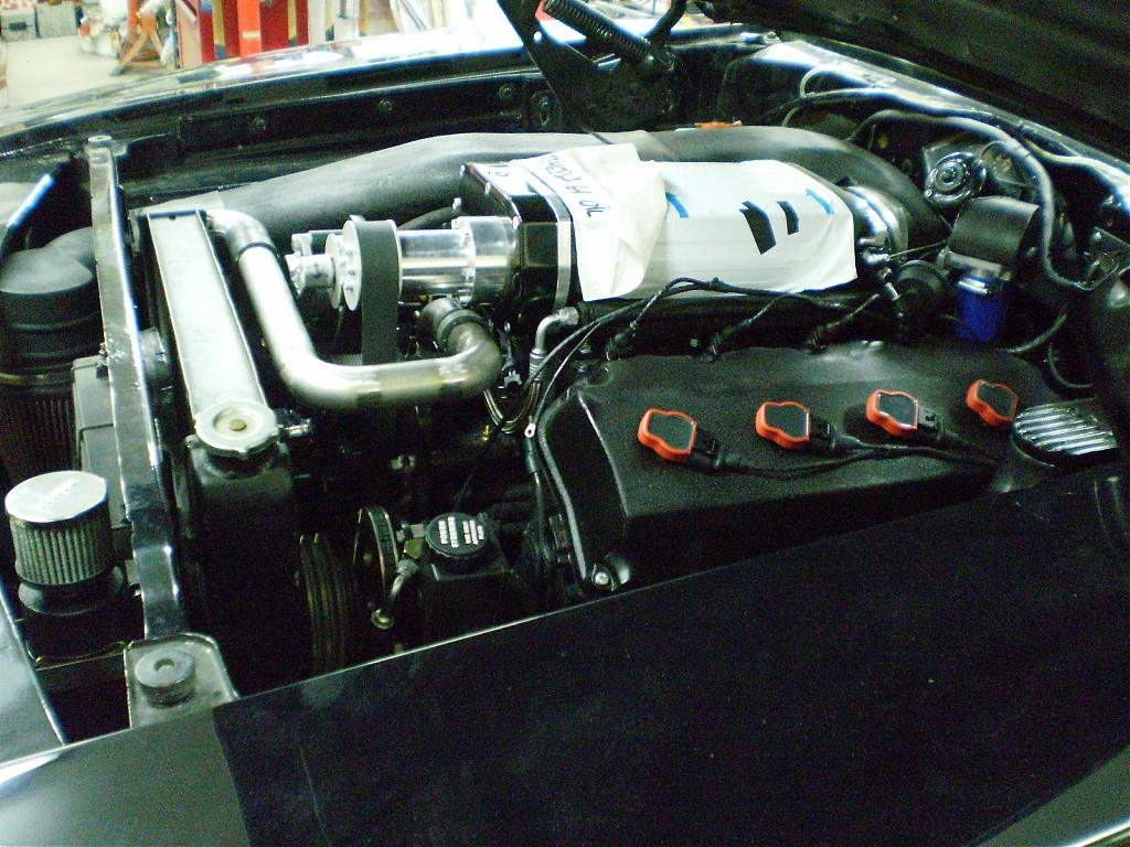

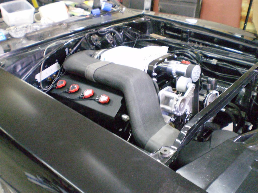

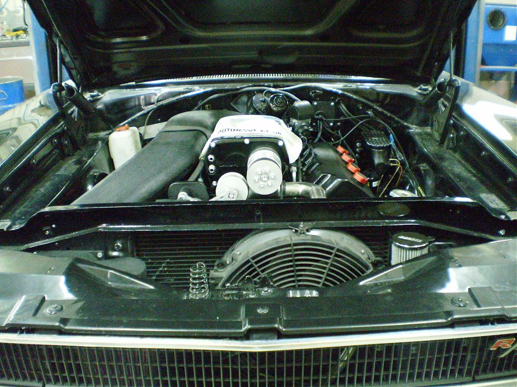

Little progress, throttle link done, now it's time for something innovative stuff
Distriputer: gone, custom made cps in its place.
Sparkplug wires: gone, 8 direct ignition coils.

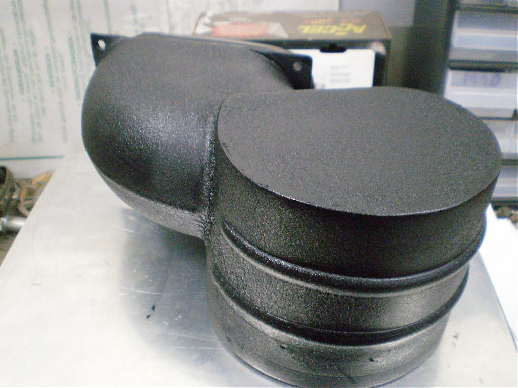

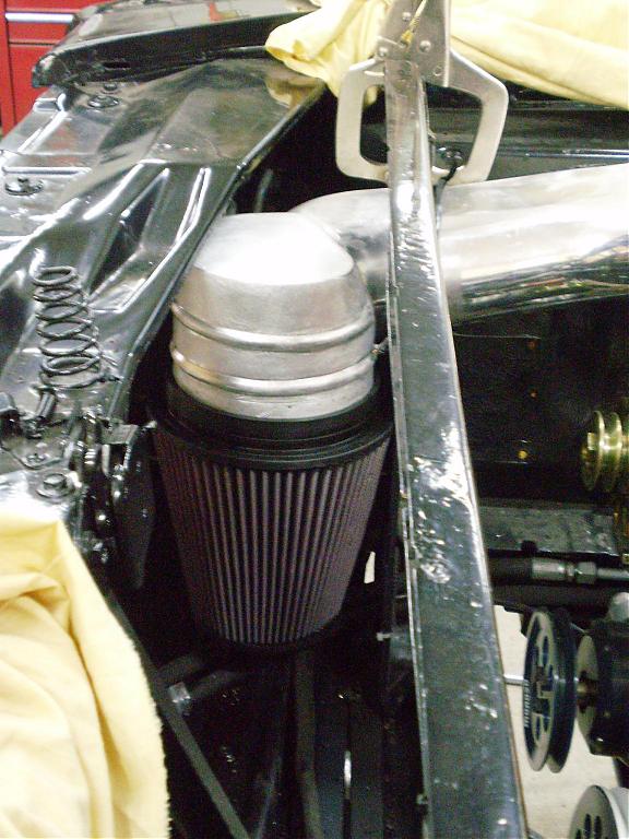

Making air filter tube, from aluminium , oval, trying to use all the space we got.
Waiting for electric waterpump so I can fab belt guide pulleys and auto tensioner.
, Juhani

This is going to be an incredible piece when complete.
Sorry if I missed it but what you are putting it into?
