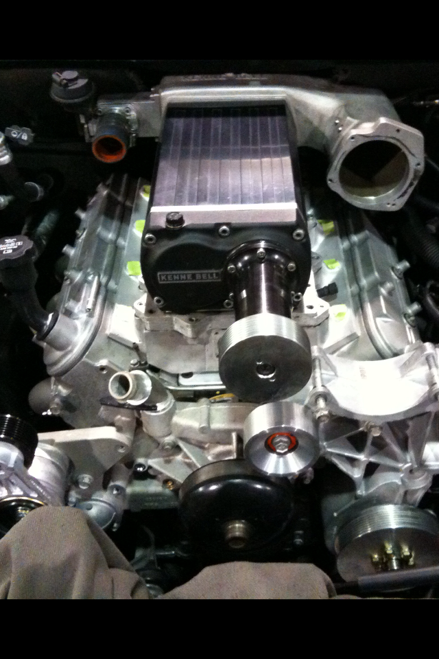

IMHO, and this is just my opinion, an inner cooled twin screw would be my choice. You would think centrifiguals (F1R) for their linear power curve would be good, but they are finiky and do make lots of heat. Turbos create packaging challenges - which is fun for some - and are more complex systems. I'm told Kenne Bell's make the lowest intake temps so that would be my first system to investigate. They do make instant power though, so you need to be a lightfoot.
