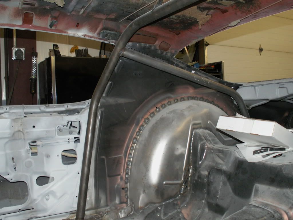

Here is more of the progress...
DSE mini tubs and roll cage installed
Firewall smoothed
Side markers filled

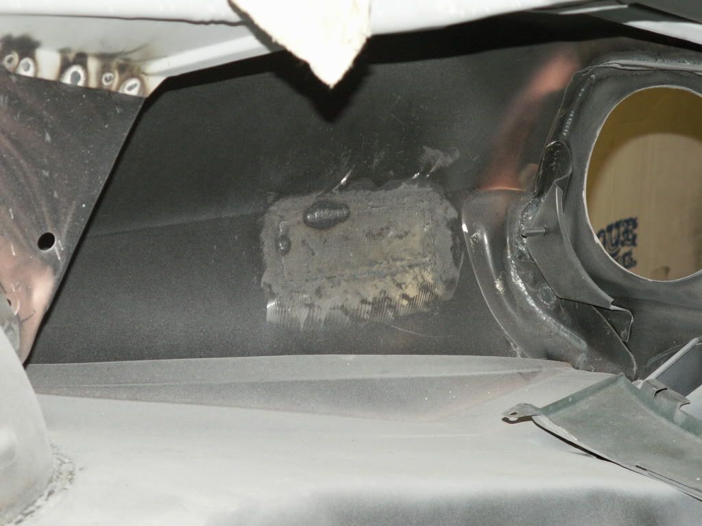

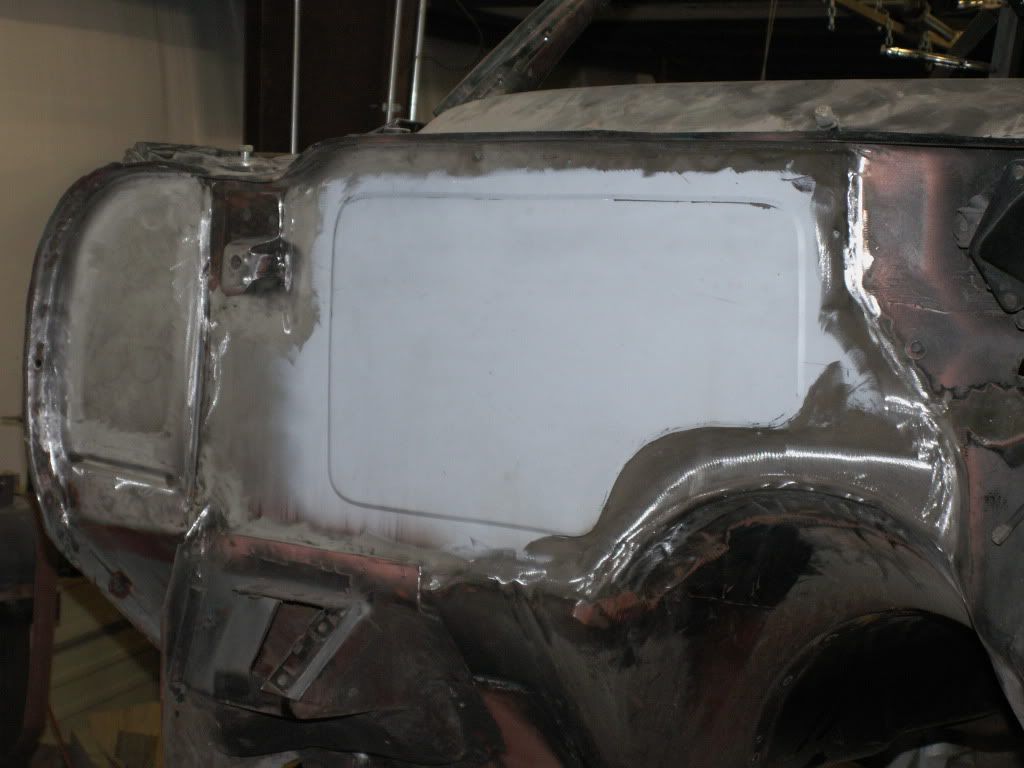

I never was a fan of the quarter “overhang” so the quarter-to-tailpan seams were welded smooth
Instead of welding the plates to permanently hold the subframe to the connectors I opted to make it bolt in so the front subframe could be removed.

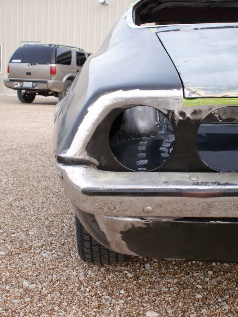

The last modifications…then bodywork could start. A RS header panel was grafted with the standard one to create a spot for the indicator lights since the standard openings would be used for cold air induction.
Here is the “collector” for the air. It will eventually feed into a central, filtered air box.
Lastly, I wanted to go with split bumpers but always thought they could use a little heft to them. There were a couple 67 Camaro bumpers lying around so my friend cut and stitched them together to see what it would look like.
