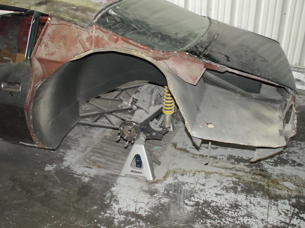

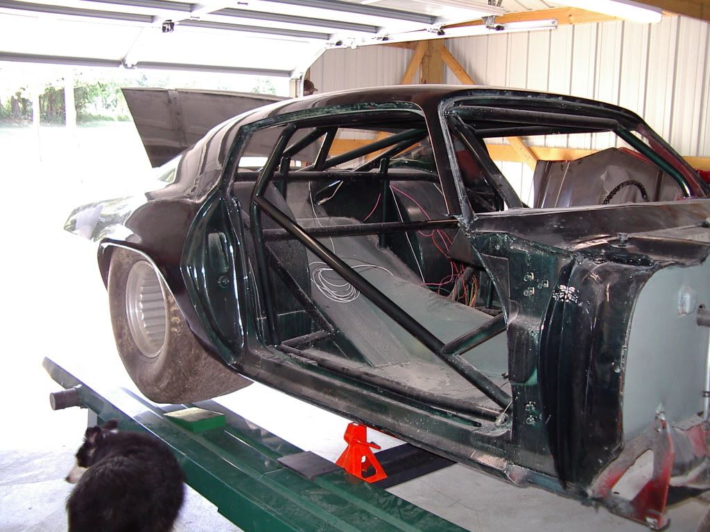

This story is not unlike many as the car has family history. I purchased the car in the late 90’s as a red street/strip car complete with 10” slicks and and a stout 383. Shortly after that I got married, started a family, and the car sat in the garage.
My Dad ended up buying it from me and decided to turn it stricly into a drag car. The car was back-halved, with monster tubs and slicks, and a 12 point cage. He traded a guy for some of the work (p.s. – that never seems to work out well for the trader) and that’s where the project stalled. Broken promises, shoddy work and the car was finally hauled home unfinished. Frustrated, he bought another project car and the ’72 sat. In 2007 my Dad passed away and the car once again was mine.
My dad’s initials are REM and rapid-eye movement (REM) is the stage of sleep dreams mainly occur in. Since this build was a tribute to my dad, and my dream car, it seemed like the perfect project name.
Here is what it looked like the day I brought it home…

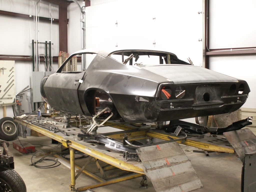

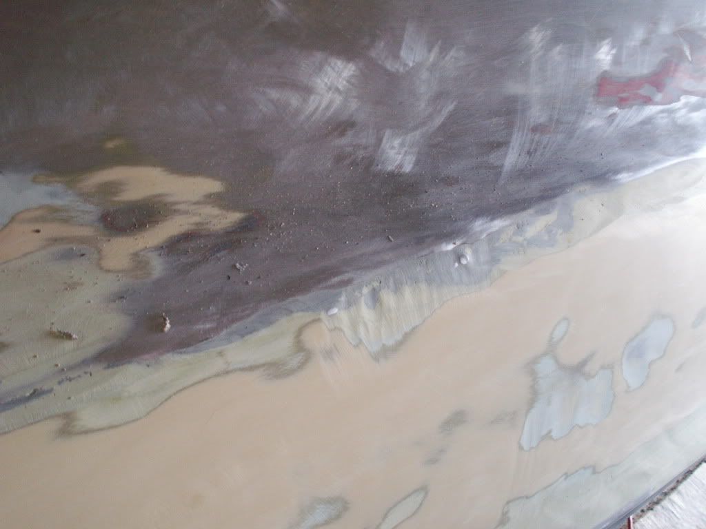

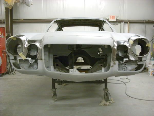

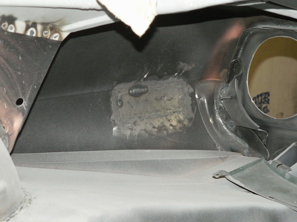

After digging into the car I noticed a lot of questionable work.
1/4 - 1/2" thick bondo
Rust painted over
Knowing the limit of my skills I decided to send it to a professional shop.

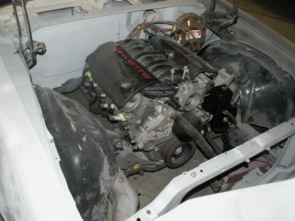

Modifications:
Rushforth Rated X’s – 18x8 front, 19x12 rear
DSE mini tubs, sub frame connectors and roll cage
LS1 with Texas Speed 228R cam and 4L60E
Wilwood brakes
Heidt’s front suspension and 4-link rear
Side markers filled
Combo RS/Standard header panel (think Dale Jr’s car) with standard inlet used for cold air induction
Billet tailights and RS indicator lights
Vintage Air

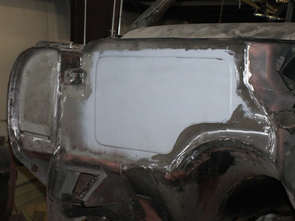

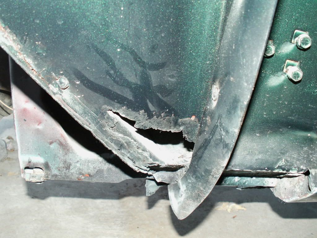

Popping off one of the quarters revealed more carnage.
That’s when we pulled out the Dynacorn catalog to go shopping for new sheet metal:
Full floor pan
Trunk pan
Trunk drop off
Tail panel
Quarter panels
Inner/outer wheelhousings
Frame rails
I was able to find some original doors, fenders and hood in pretty good shape.

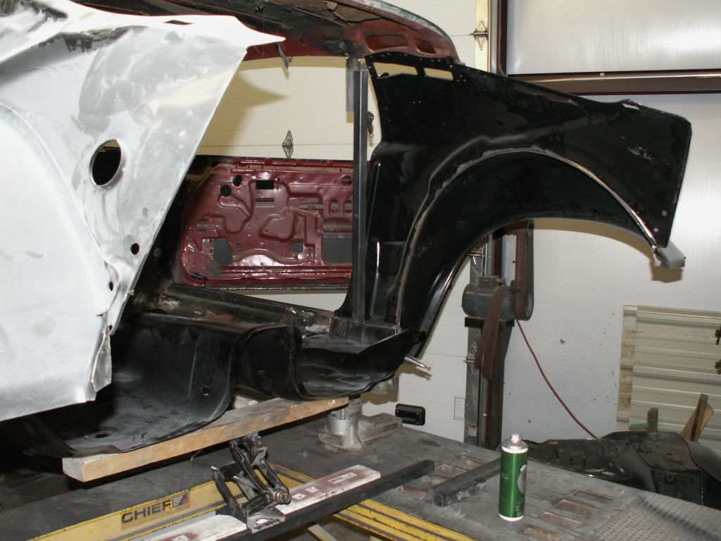

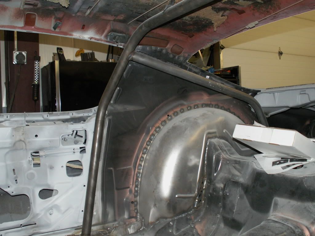

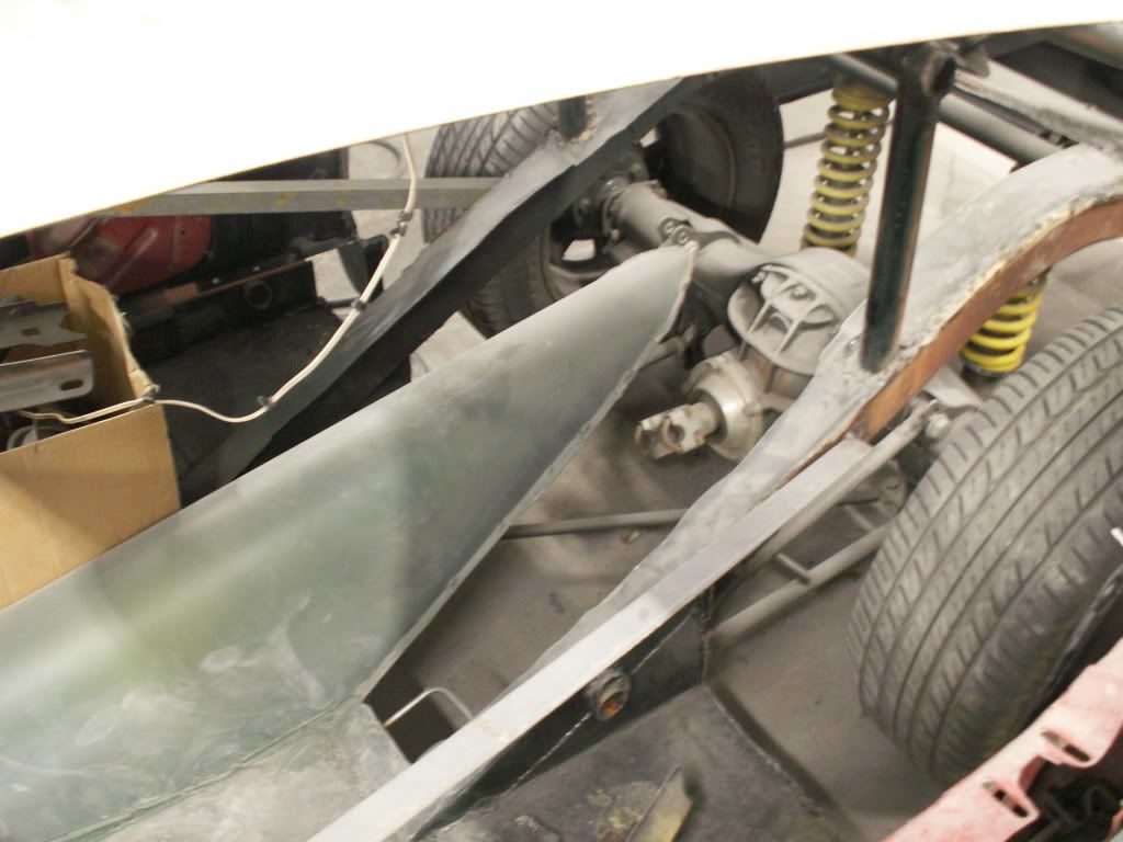

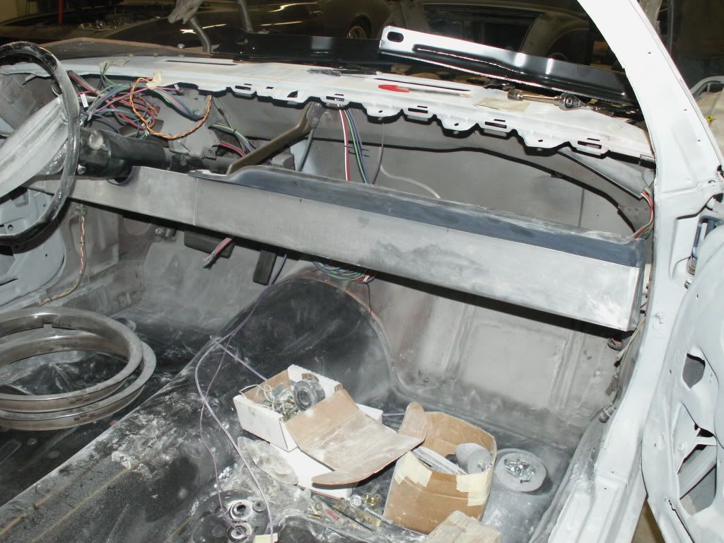

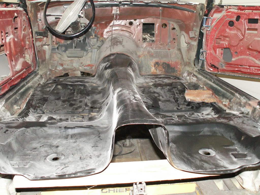

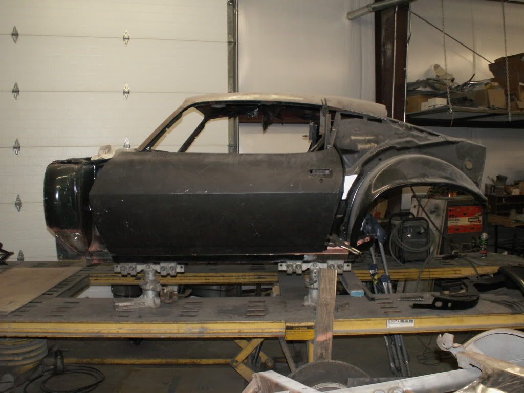

To make room for the new sheet metal the old trunk and floor had to be removed along with the non-structural cage bars.
Old 05-02-2012, 05:59 PM
MoonMan's Avatar
MoonMan MoonMan is offline
Join Date: Mar 2010
Location: St. Louis
Posts: 79

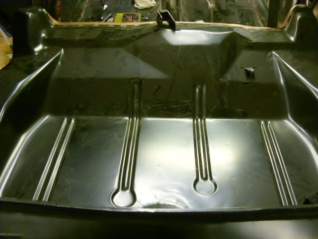

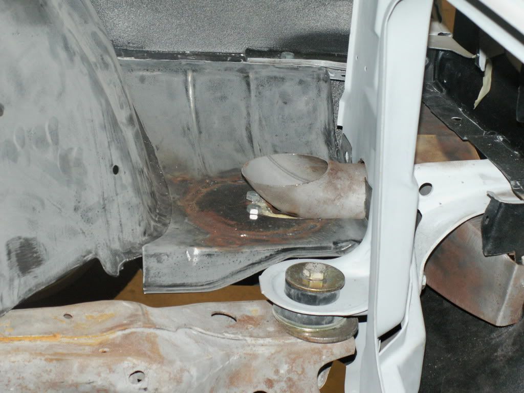

Then the rebuilding process starts!
New floor
Inners cut out to make room for the DSE tubs
Yeah that's right, the original part of the car is the rockers, firewall, and roof!

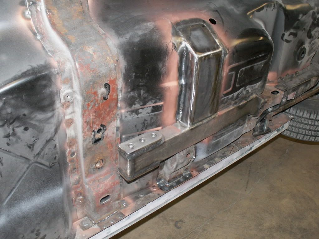

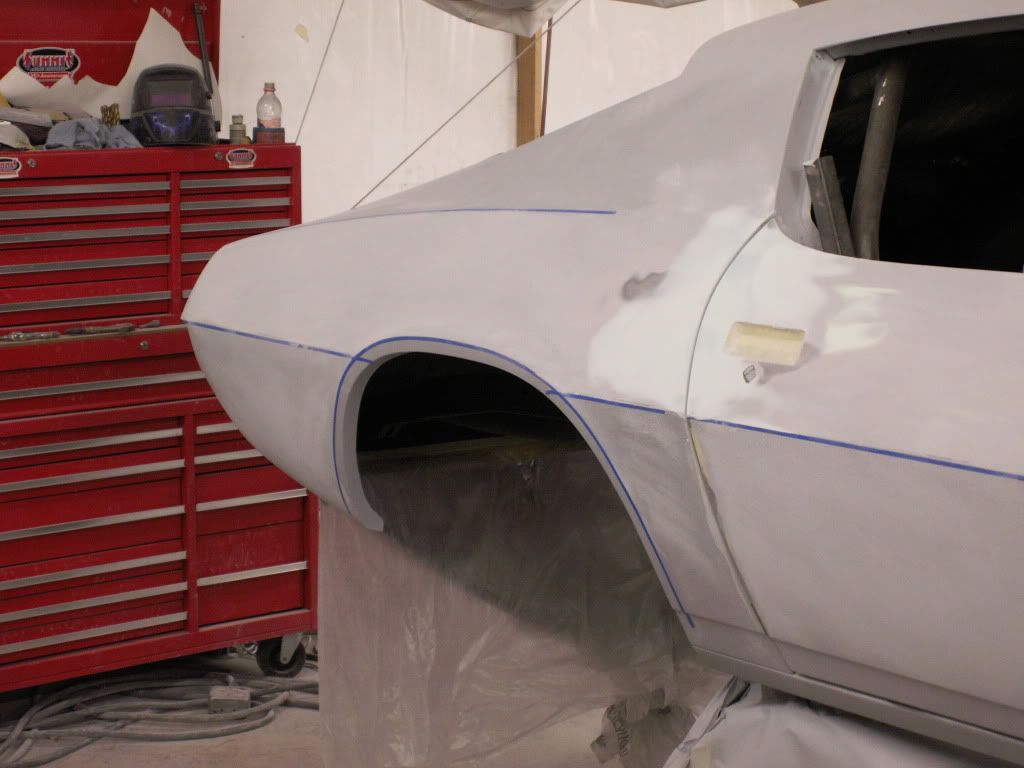

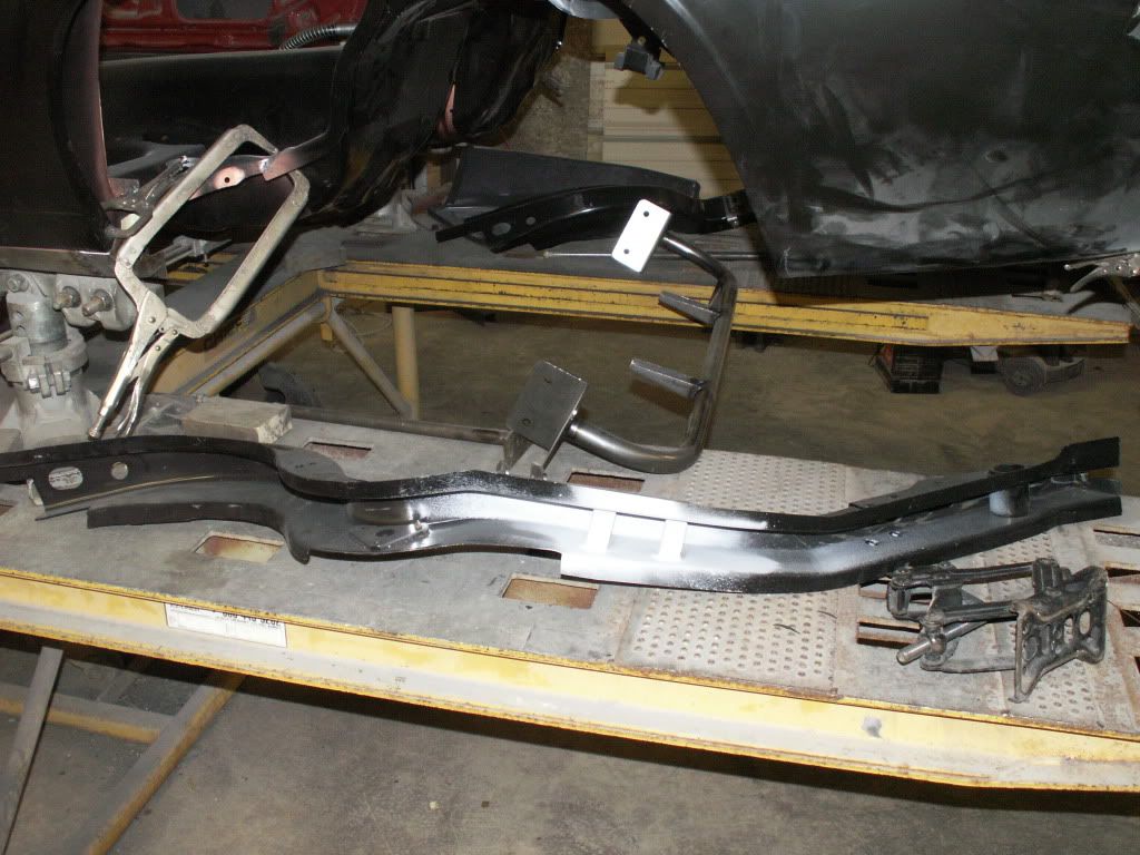

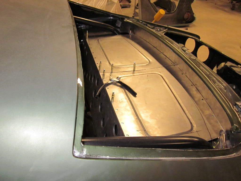

More pieces of the puzzle

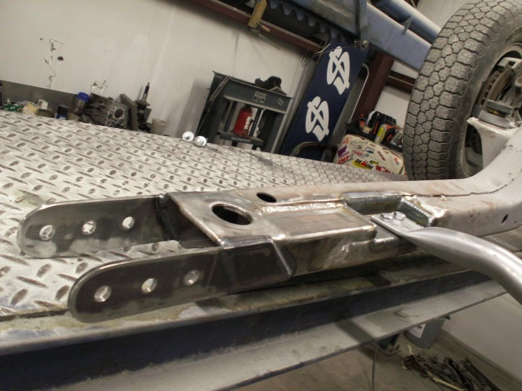

New trunk floor

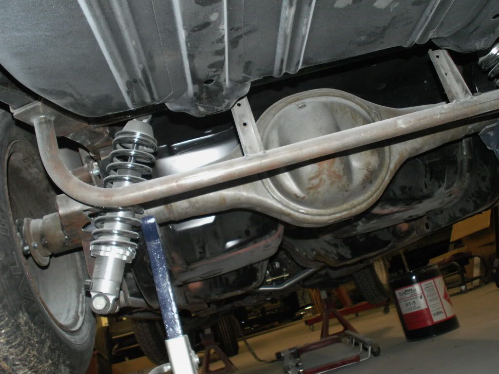

Frame rails and coilover bracket next
Add some quarters and tail pan and it's starting to look like a car again
