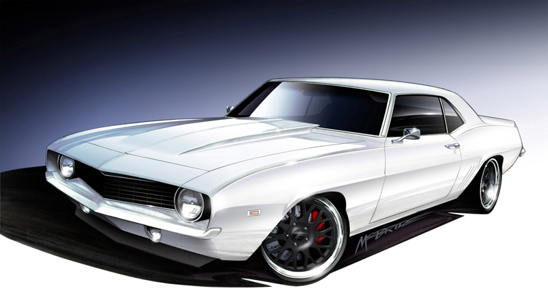

I have a feeling it will look something like this one, minus the stripes and with a deck spoiler. Note the is NOT Stielows car, although it did inspire me to get black wheels.

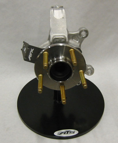

Here is all I'm going to show you:
I present to you AFX Spindle Serial Number 000001. Thanks for the inspiration Mark.

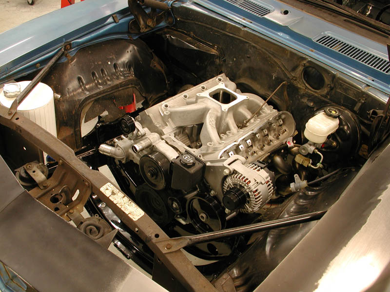

Chassis - All the chassis modifications are done using a combination of ATS spindles and DSE parts
Drivetrain - All the powertrain has been modified up and trial fit in the car. I'm using ATS engine mounts, tranny cross member for a T-56, ATS headers and a C-5 Corvette accy drive for the LS7. The hardest part of installing the LS7 is the dry sump oiling system. I had ATS make me a pan that fits the engine and a '69 stock fron clip. Should work good.

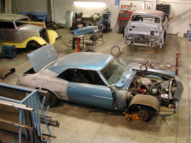

Paint and Body - The body is at Perfomance Restoration get preped for paint.
