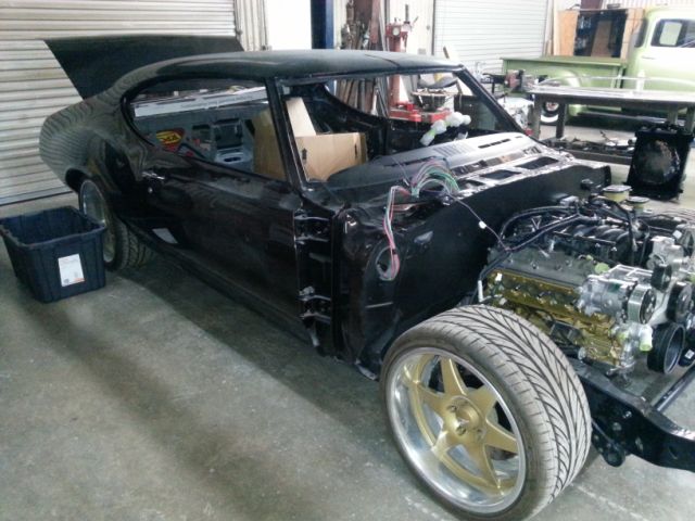

Been a while since the last update, so here goes:
1. got the engine & trans in, headers installed and the front coils adjusted to bring the oil pan off the ground.
2. during the install, had some issues with the mounts and the engine dented the firewall trying to get it all installed.
3. got the front steering components installed and torqued, and the wheels / tires reinstalled so it could roll.
4. sent the car to my painter and had him rework the firewall and paint it, as well as the dash & rear speaker deck area
5. while in there, he saw that the motor mounts were way worse than I thought. He had to cut them apart, flip them around, and generally rework them to get it all level and installed correctly. By doing so, he was able to raise the engine and trans a little giving better ground clearance. This also centered the trans in the tunnel like it should have been (was off-center before).
6. the hard brakelines along the frame have been installed
The car is now back in my possession, and will be getting the Vintage Air A/C system and the wiring harness installed. I will also be ordering the driveshaft, and once that is in, the car will go to the exhaust shop to get the Borla stainless steel exhaust system welded & installed. After that, more wiring, fuel system and dash.

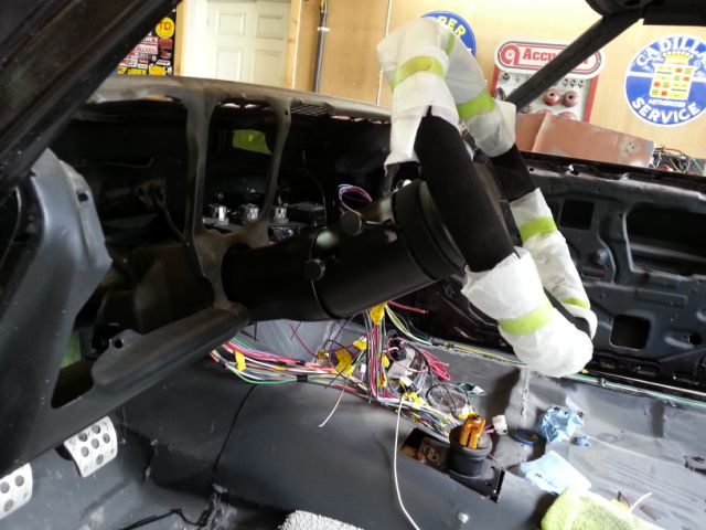

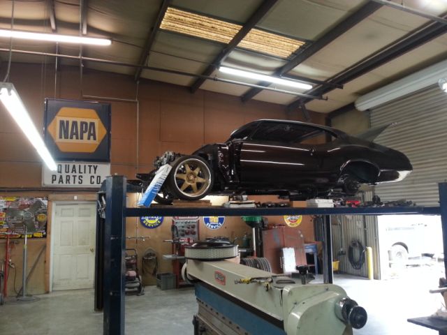

After a LONG delay, Project Sabre is finally moving again. We had to take the car back from the last shop as they let it sit for many months and didn't do the work they said they would. I now have a good shop working on it, and they have been able to accomplish a lot in the last week. We did find that the last couple shops that had the car messed up quite a few things along the way, with incorrect bolts being installed in the suspension, parts installed in the wrong spots / backwards, and the rear axle adapter mounts weren't done properly or safely. As such, the rear axle is coming back out and we're having it all fixed the right way.
In addition to fixing the suspension installation and the rear axle mounts, they are wiring the car, installed the steering column and wheel, finished up the pedal install, hydroboost and brake installation / lines, making a driveshaft, getting the engine ready, installing the a/c system, dash, gauges, etc. The first focus is fixing what's wrong, then working mostly on the drivetrain and suspension issues, then tackling everything else.
I'm just glad to see progress, which is LONG overdue! Here are updated pictures:

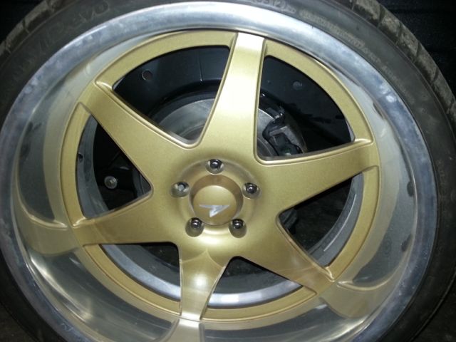

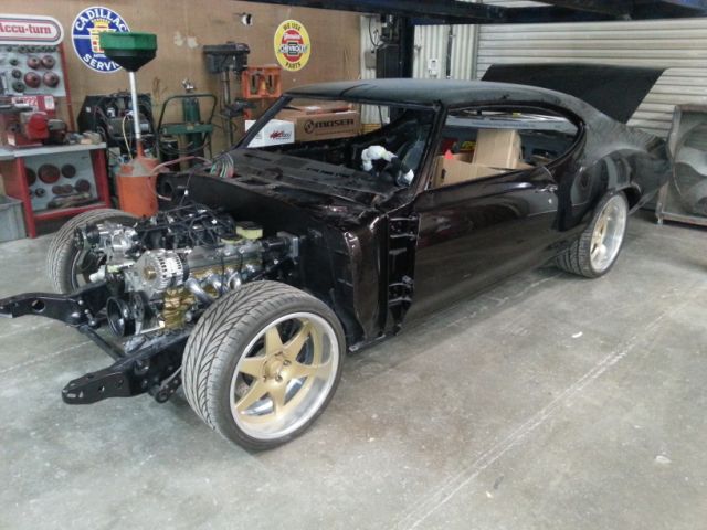

Minor update, but an update none the less. The shop got all the brake calipers and rotors install, all bearings packed, all Ridetech suspension pieces installed correctly. The window fuzzies have been installed, as well as the door latch hardware including the new handles, handle gaskets and door lock gaskets. The doors close like a new car and sound great when hitting the striker. The tinted glass has been ordered, but a week into the 'processing time' we found that the rear window was backordered. They should have that shipping in about 10 days time, so we should have glass installed within the next 2 or so weeks. The master has been installed and the hydroboost installation is done (they still have to finish up the brakelines, but the hardest part of that system is done). Getting much much closer, and very pleased with the work being done and the communication. Here are pics from this weekend:

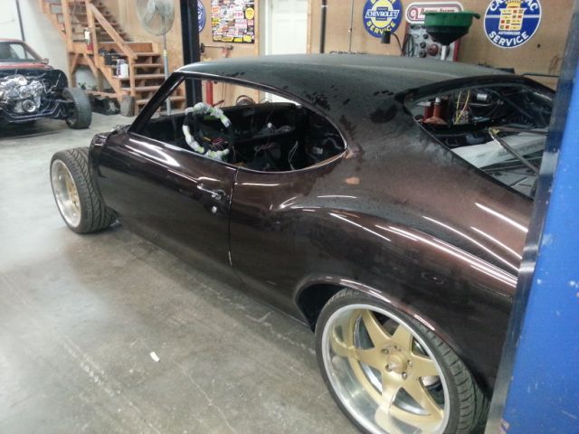

The color combo with the wheels is right on!
