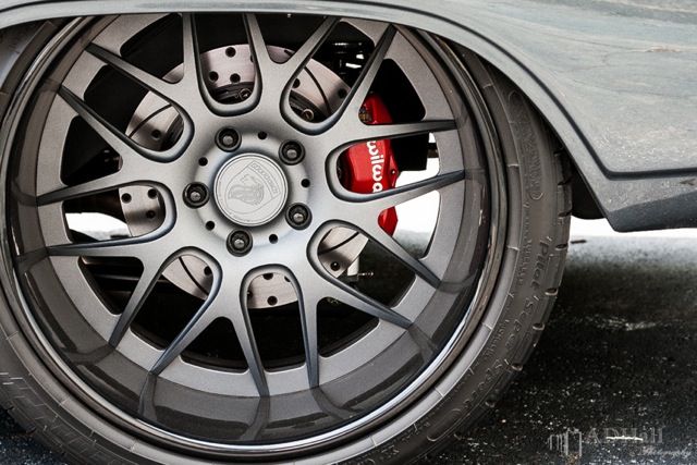

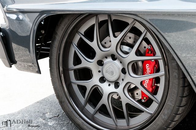

With the wider rear tires, are new wheels in order? A sweet, new set of Forgelines perhaps?

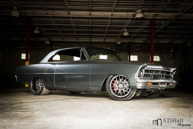

These year Novas are growing on me. That is a going to be a nice build guys! Keep us posted.

Nice looking build. Going to be an awesome car. I'm a fan of the 66-67s myself!

Yep new wheels will be here this week ,......but not Forgelines Sorry

On the tubs yes we narrowed the rails to the edge of the quadralink supports and filled the outer frame with the DSE supplied frame boxing plates, that and the narrowed 9" got us good clearance with a 305 on a 19x11 with a 5" BS

Looks awesome
