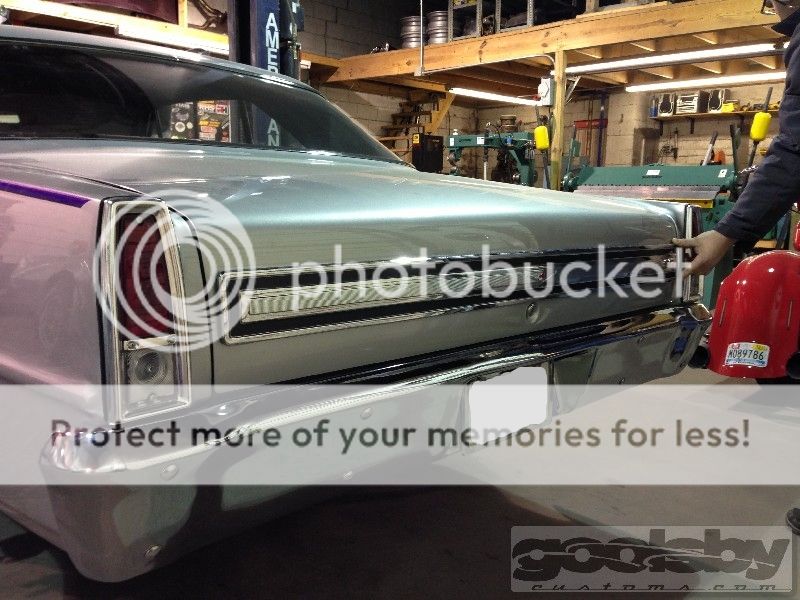

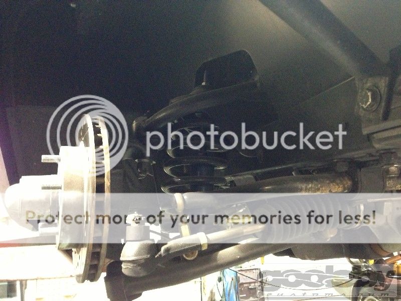

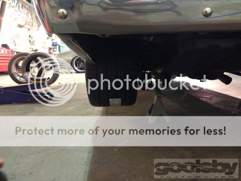

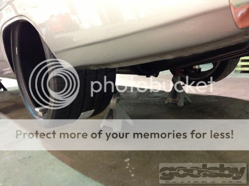

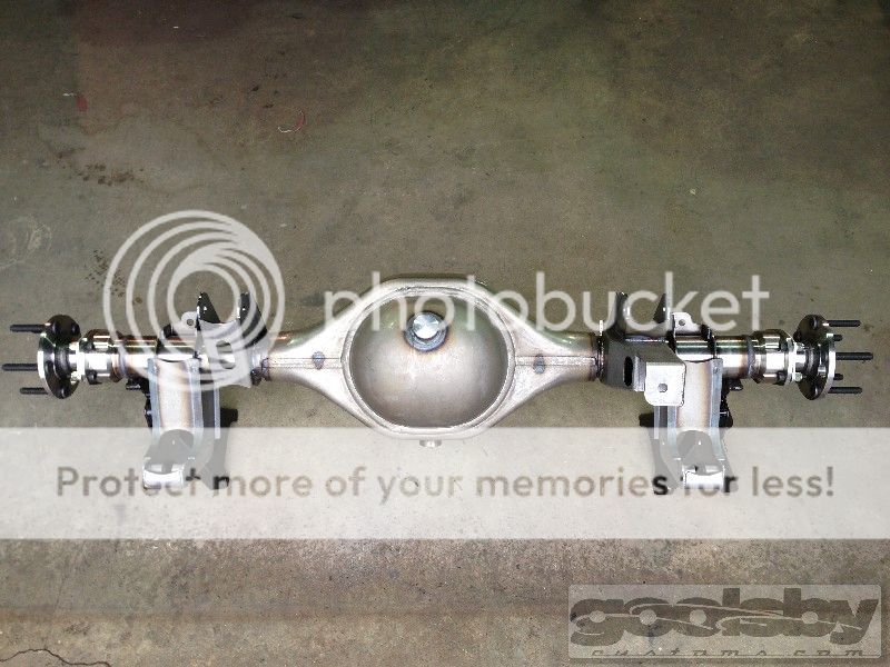

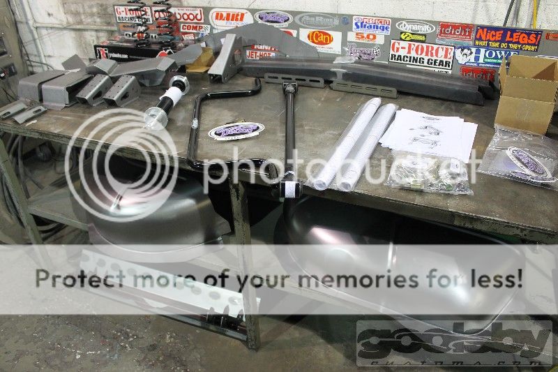

This Nova came to us a few weeks ago by a good friend of ours over in Atlanta. Overall the car was pretty decent with an LS7 and 6-speed , but the suspension , interior and obviously the paint job was a little dated, so we will be doing a few updates to all of those and make this Nova a great driver that will hopefully turn some heads in the process. Plans include , DSE Quadralink rear with new 9", coilover conversion for front , Big Wilwoods all the way around, new wheels and tires, shave drip rails, handles, gas fill, wipers, cowl vents, rear tail panel, and some custom dash work followed up by some carpet and seat work by M and M Interiors, along with some minor repairs and upgrades along the way.

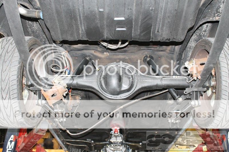

The old 9" and Cal Tracks bars will make way for the new narrowed Moser 9" and DSE goodies

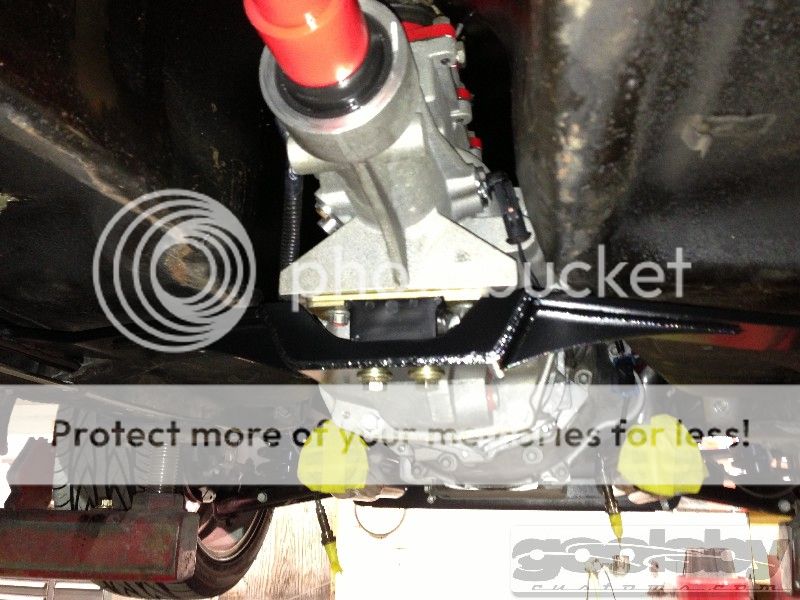

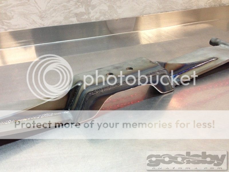

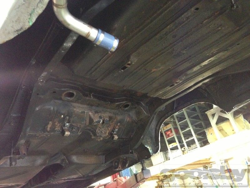

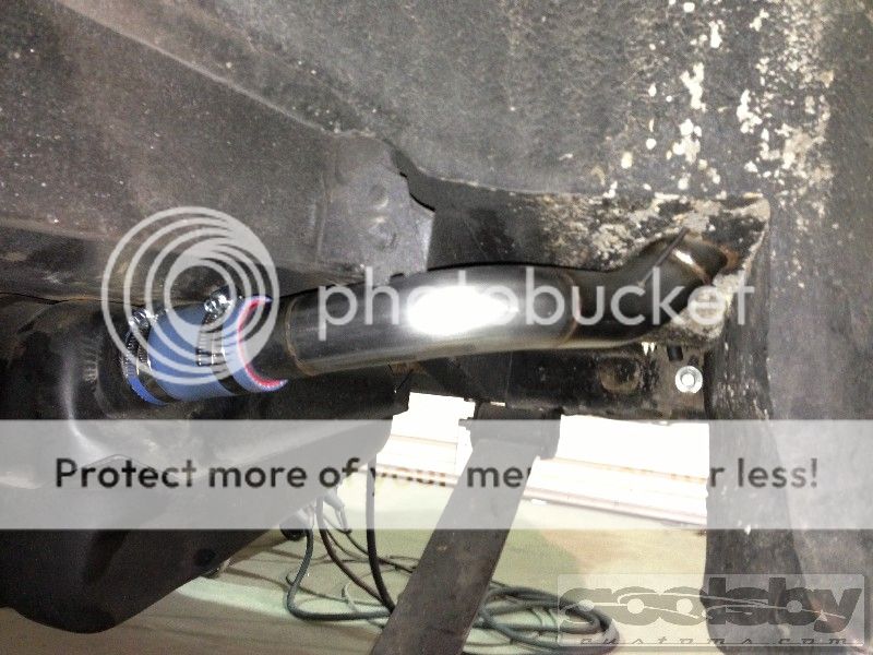

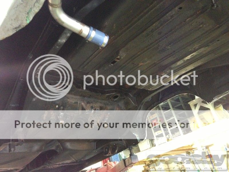

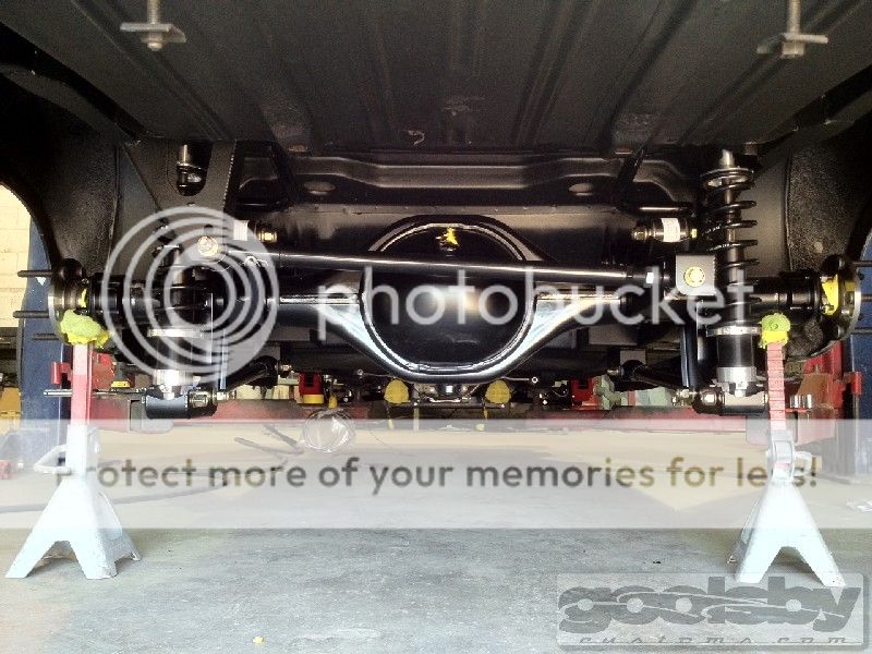

While we were under the car doing the rear supension we noticed the rear trans mount was solid with no bushing so we modified that to accept a bushing to reduce vibration transfer and be a little stronger with the new mount, nothing groundbreaking just some quick fab that anyone could do

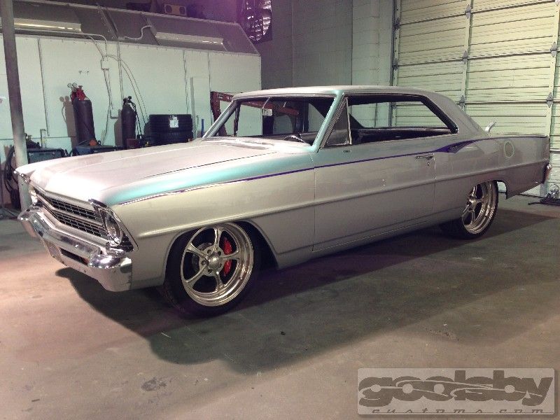

This car is going the cyber grey metallic off of the ZO6 , should be pretty clean

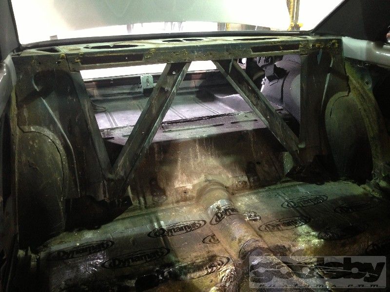

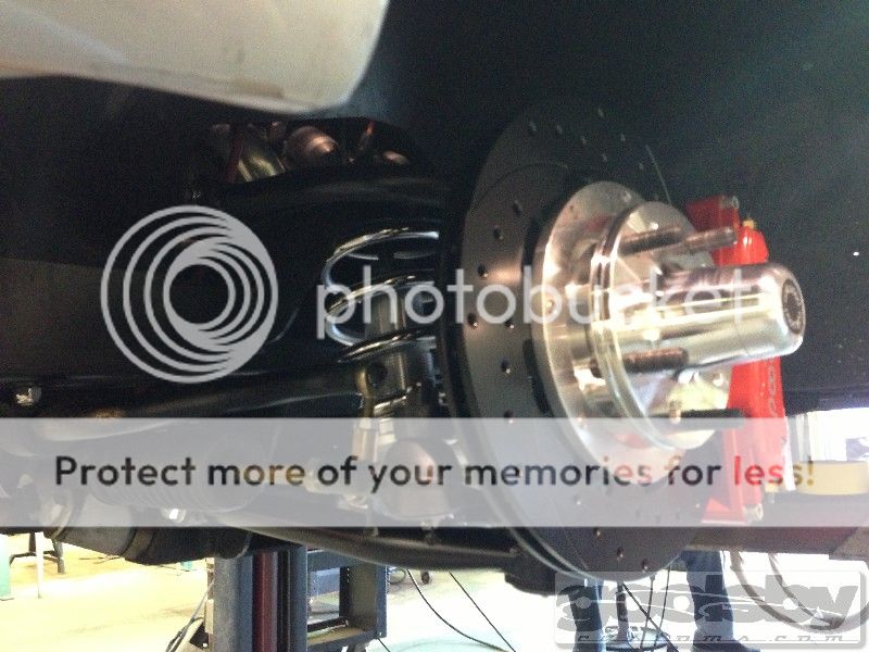

Some more .....
OLD......
NEW....
www.Goolsbycustoms.com

what are you going to use for a rear parking brake?
Plan is to use the Lokar cables and hand brake in a console, hope thats what you were asking
