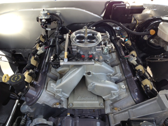

ive got a 5.3 in my 69. z06 243 heads milled .030 thinner headgaskets , custom compcams camshaft with holley terminator efi. not a torque monster but its ran 13.20 at 109 with terrible 2.0 60ft. with a stall or t56 it could run high 12s easy. they are good little motors that you can wind the pi$$ out of.

Posts: 137
How do you like that dual plane Edelbrock? I have the single plane Vic Jr with an accufab 4150 TB on it and it loves to wind up!

Posts: 816
It has a lot better throttle response. More bottom end torque too. It will still wind out also. Good intake for street use
