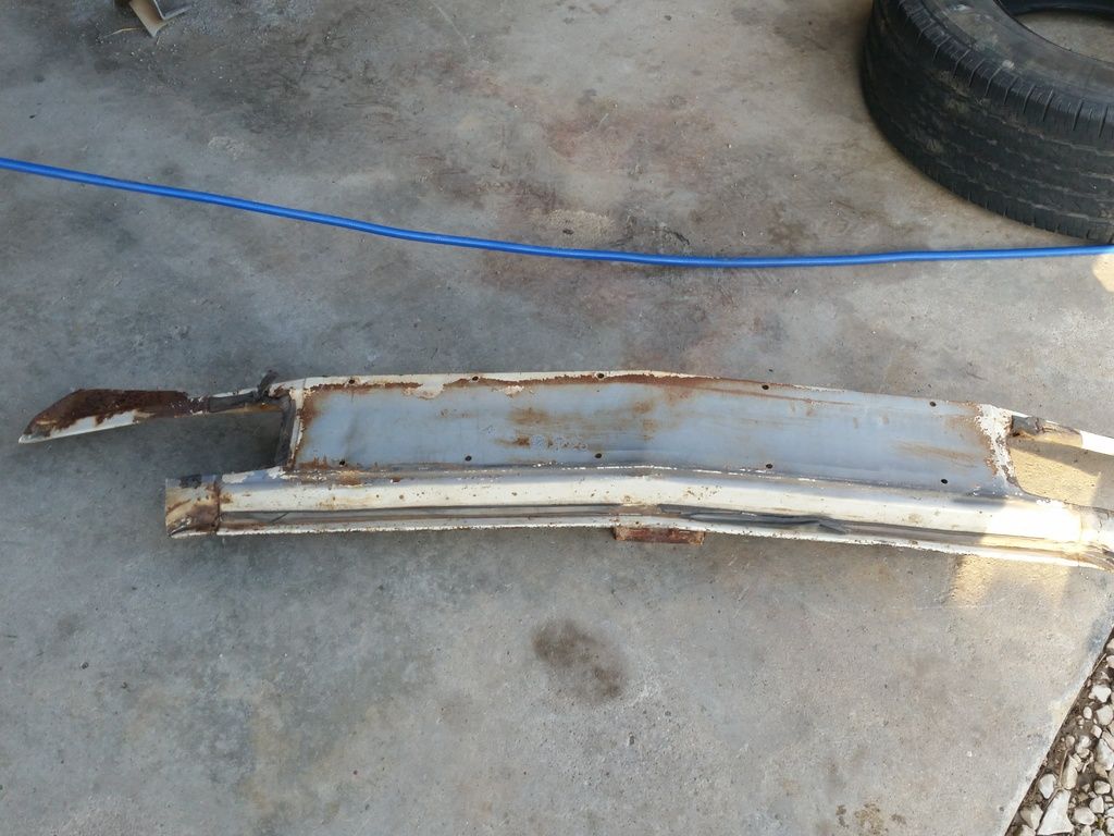

Working on mounting in the new(used) set of buckets. Not being factory mopar seats, I'm having to cut the bench riser out of the floor to get them to mount flat, other than that they are fitting pretty nice. In progress pic..

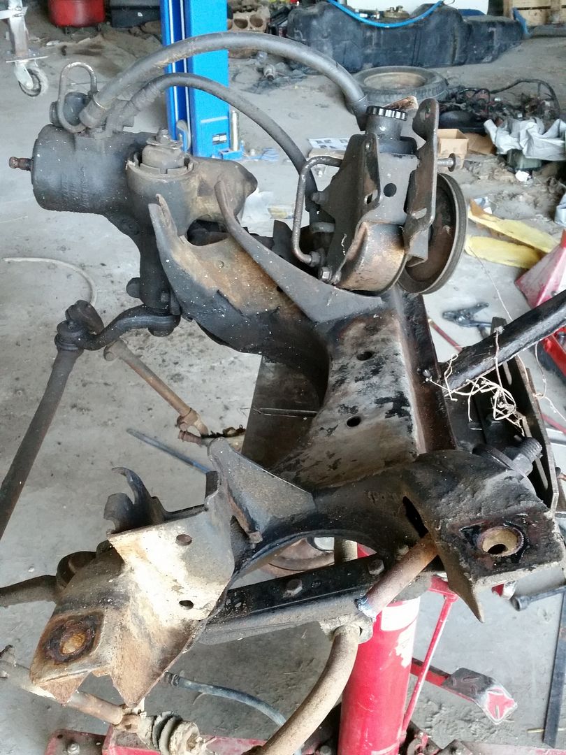

Been a long while since an update. A lot has happen. Car is completely stripped, now up on a body cart. Hoping to blast it in a couple weeks.
But I did pick up a few new toys
Out with the old.....
In with the new:
  #17

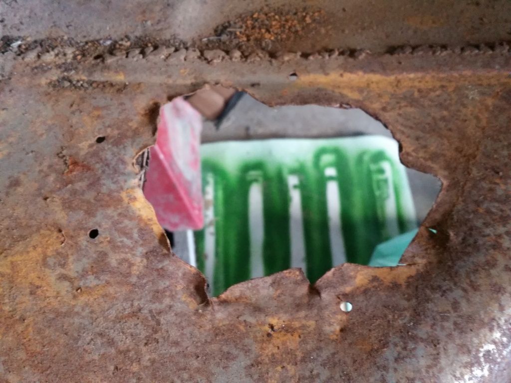

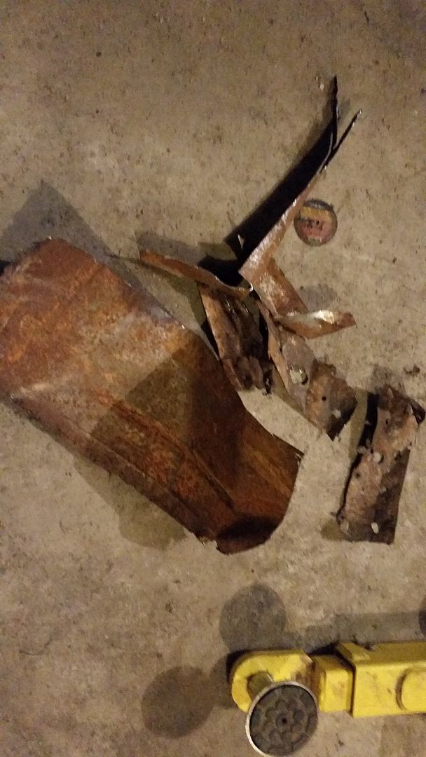

The old owner's "fix"

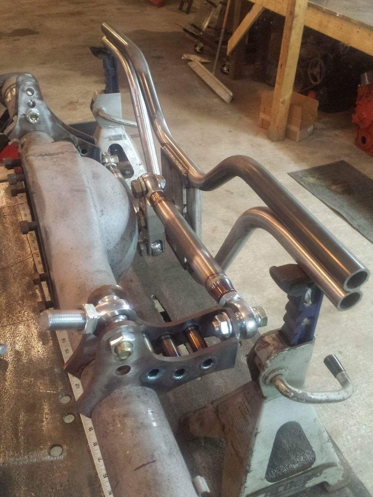

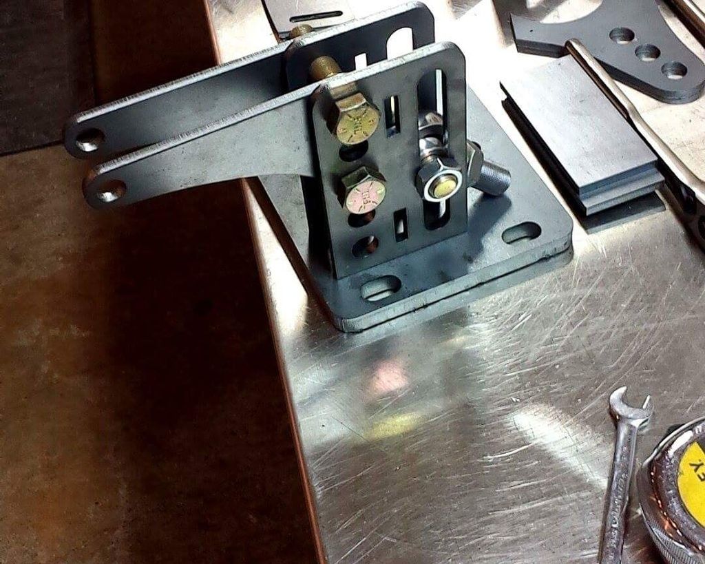

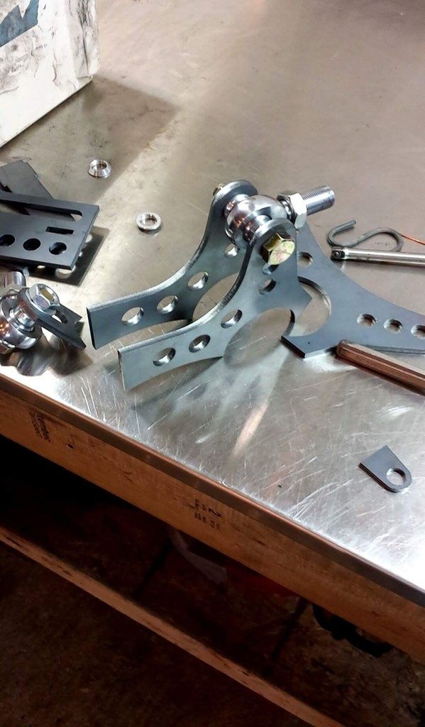

thought i'd post some updates over here. After months of thoughts, I came to the conclusion I lacked the fabrication skills I needed to trust my life on my suspension, so I got with Carl Gerst at Gerst Suspensions and told him what I wanted and he went to work. This is what we have together thus far. It's still in progress and this is just the mock up version to make sure everything fits and works. It's being tested as we speak too.
4 link parallel with Watts link with sway bar
