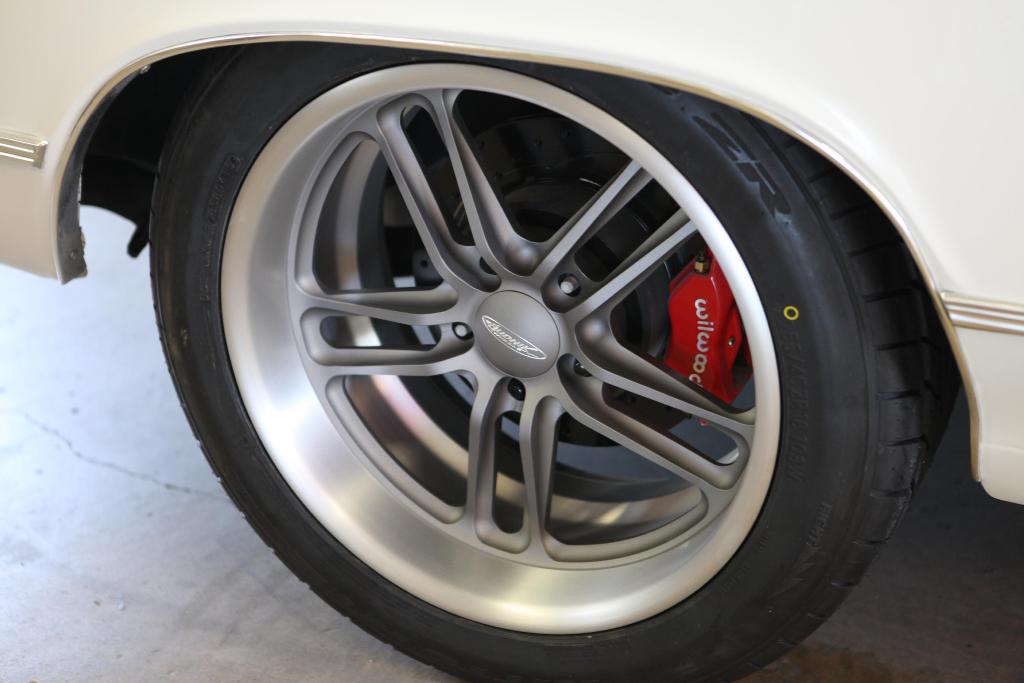

Default Budnik wheels

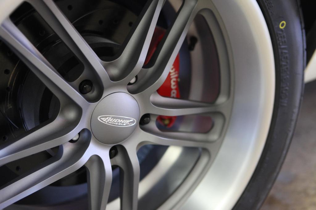

The Chevelle's "Budnik V2" wheels arrived, and they look great.

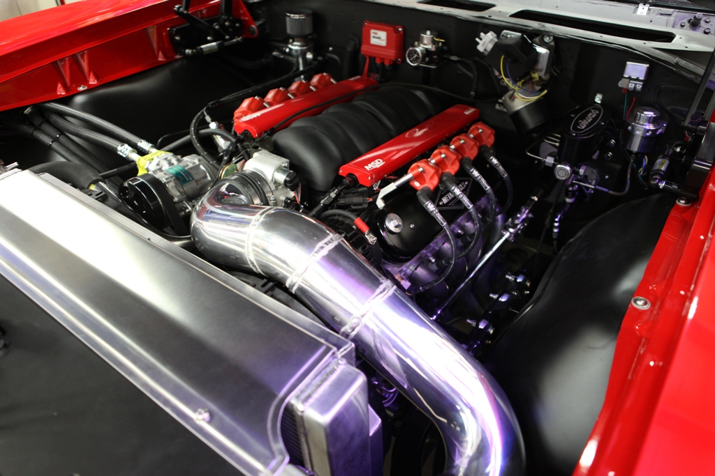

Originally Posted by 98ssnova View Post
Have you fired up the MSD yet? Curious on how it to setup after the install?
We have not fired this engine yet, but our shop does a ton of LS conversions, and we LOVE the MSD fuel injection. We also have it on our personal shop car which is a 68 GTO with a pretty radical Wegner Motorsports LS3 in it and it handles that engine great.
The hand held controller steps you through a series of basic questions, then it goes into a self learning mode, and really does an amazing job...we recommend it highly.

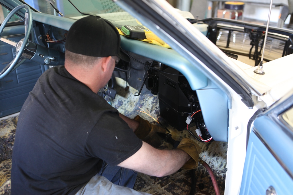

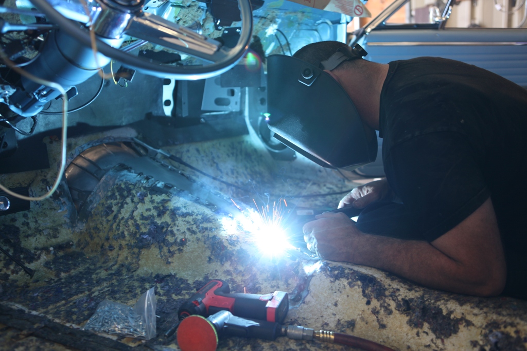

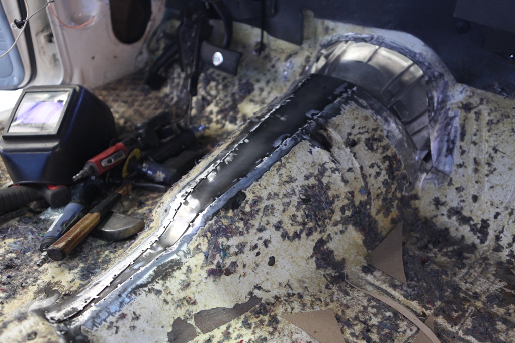

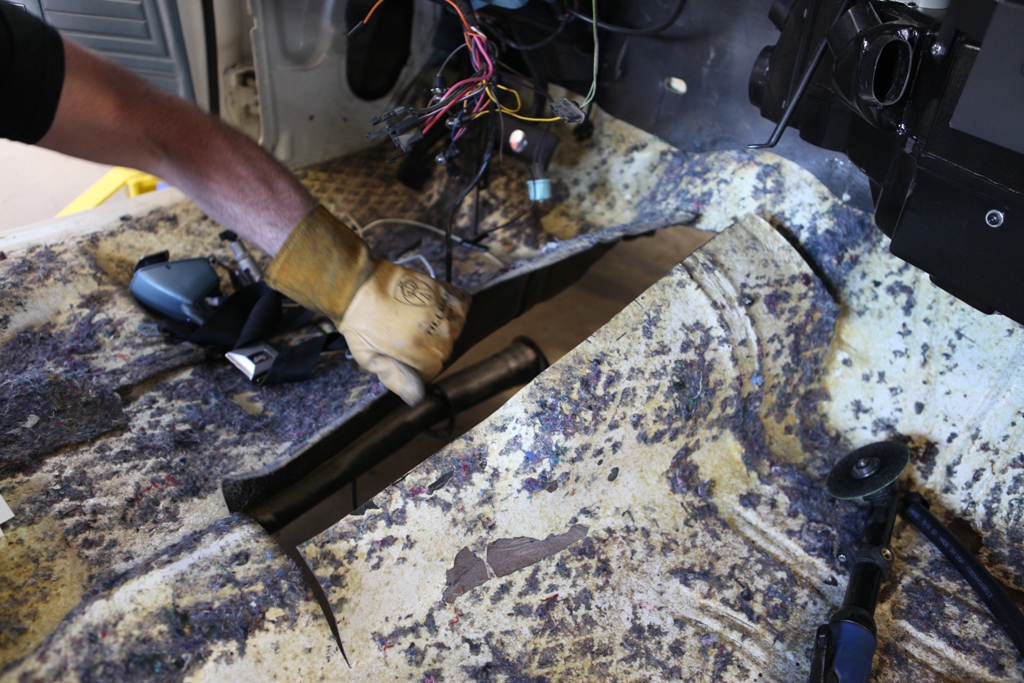

Default Tranny tunnel

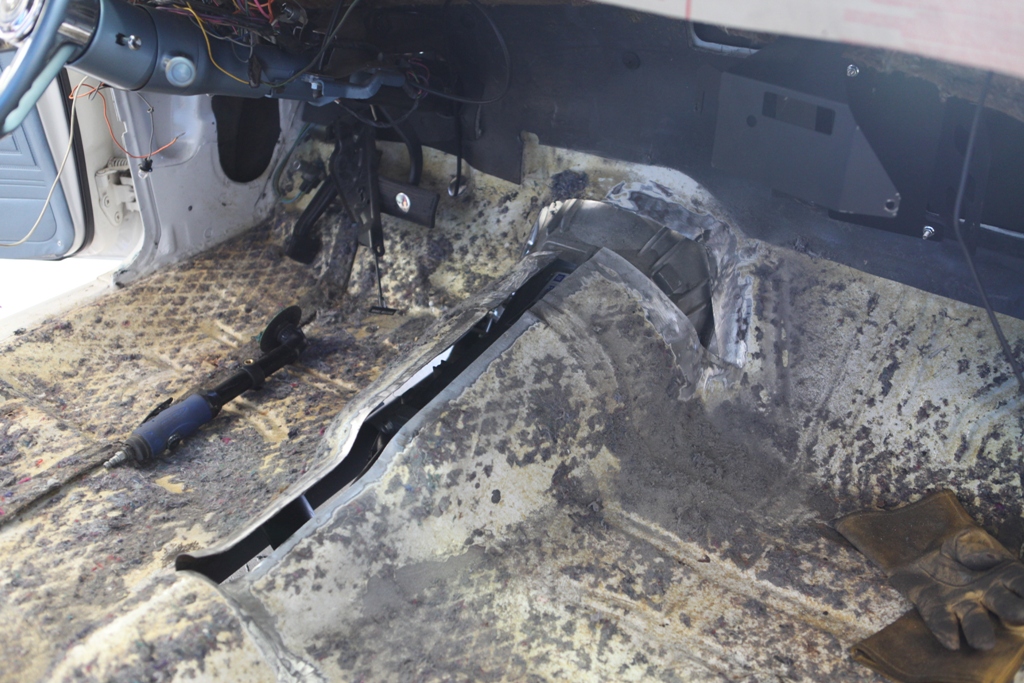

Here we are opening up the tranny tunnel to allow room for the much larger 4L65E.

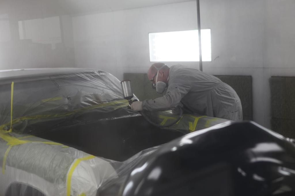

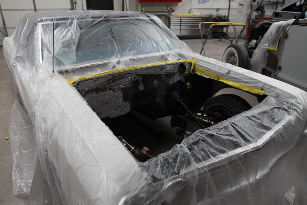

Default Firewall

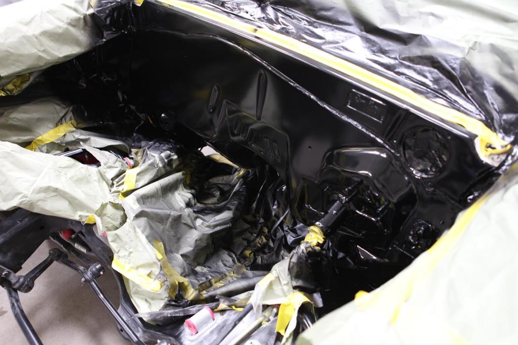

Here we are filling holes and smoothing off the firewall, then shooting it in semi-gloss black...next is the final install of the LS3.
