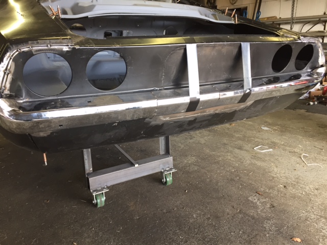

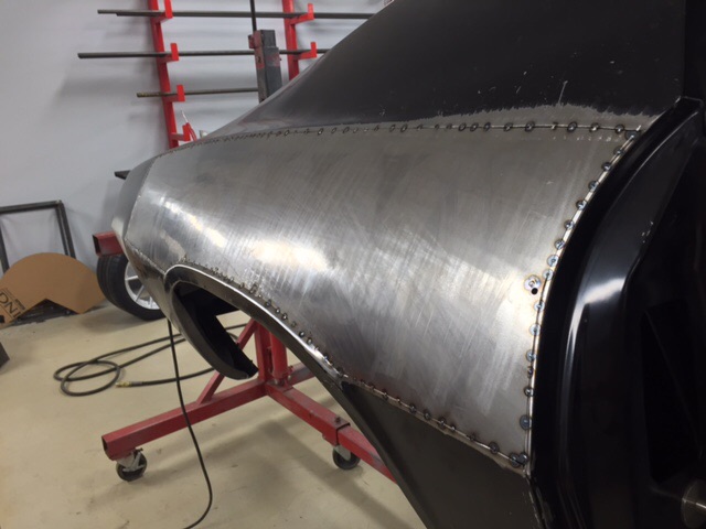

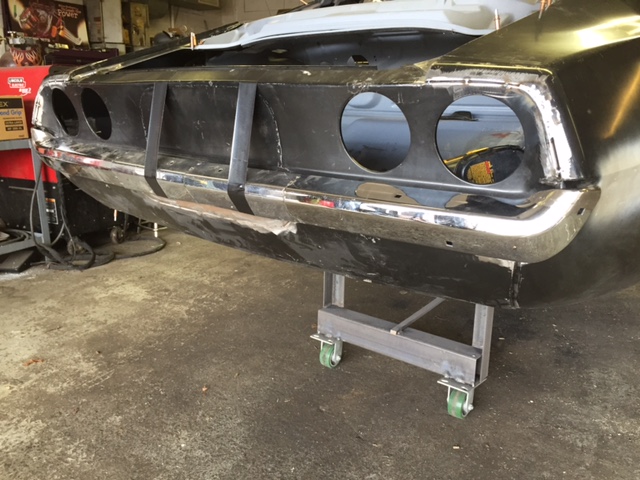

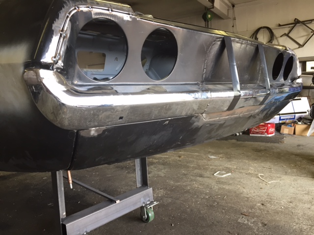

some more pics

I had to cut out the Detroit speed tubs ,I ended up going with a 345 30 19 tire and they just weren't big enough , also had to stretch the quarters with these panels , formed them on an English wheel
