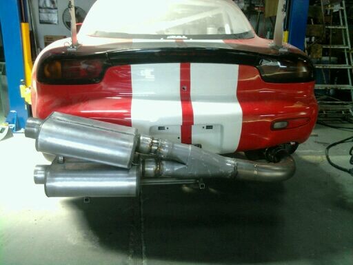

Here was my Laguna Seca 92db exhaust.... single 3.5" into dual 3" UltraFlo mufflers. It was stupid quiet and still ran 1:33 there not fully pushing it. 2470lbs wet.... 12:1 compression 438ci with stock LS3 heads/intake, GSR dog box, 18x12's all corners only 530rwhp/510rwtq but torque everywhere.
