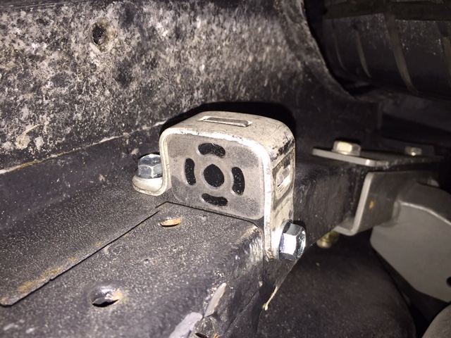

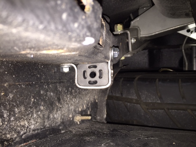

The 295s fit great with the BMR Torque Arm and I think even with the flatter wheel opening on your Camaro they would work if you look at how far inside the wheel lip the tires are tucked on my car. There's also good clearance before the tire would contact the rear of the inner wheel well on the inside. Early Firebirds don't have the seat belt bludge in the front of the inner wheel well but if your Camaro does a BFH should easily adjust for any needed clearance there.

Thanks this really helps how do you like the setup? I spoke with BMR today and they are pretty much saying what you are and a mini tub even better. Did you keep your C-clips or go with a C-clip eliminator? I assume the stock gas tank still fits.

Stock Goodmark replacement tank... 3" exhaust cleared everything... 2.5" tailpipes would be even better/easier.
