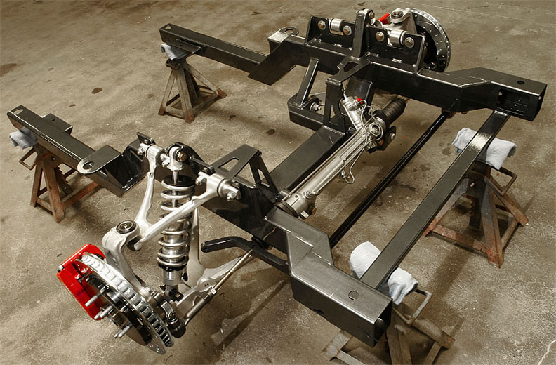

As important as technical aspects are for me i want certain visual look too. And the AM clip looks somehow little bit "fragile" to me. Yes i 110% sure it is way stronger than anything wich came from factory but if you take look of this picture you know what i mean:
http://www.artmorrison.com/albums/Ca...4399.sized.jpg
And yes the white backroud and un painted frame does tricks to that picture but still i think the inner fender are going to fly away??
Then there is a 21st clip. But did i understand correct it mounts the engine 1" higher than others? I would rather not cut the tunner for T56 and like the idea of lower "point of weight" . Otherwise i like the looks of the 21st frame more. https://lateral-g.net/forums/atta...9&d=1149044409
I believe both clips need some trimmin to innder fenders to look right ?
I am affraid this leads me eventually baying DSE clip

The comment about the high rack position was based on the observations of another (very reliable) source about a year ago. I would not treat that as definitive information - I would talk to 21st Century directly, and check with with people who have used the clip, like Steve1968LS2 on this forum.

if you read steevos post and do a search the 21st DOES raise the motor, i know with a 4l80e no cutting is required just some heat and massaging to install. its a very nice piece and drives even better
