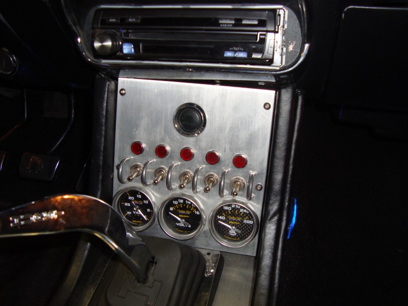

I have the air fuel gauge now, just have to make a revised console panel, to hold it, then hook it up.
Existing gauge layout;
The start button is going to be axed.
I'm thinking switches at the bottom (across) and the four gauges side by side in a quad layout at the top 2/3 of the panel.

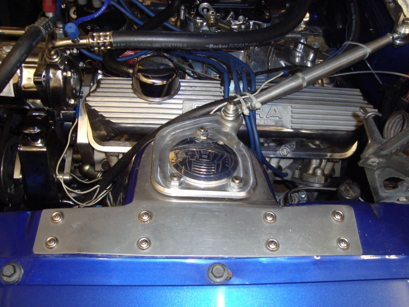

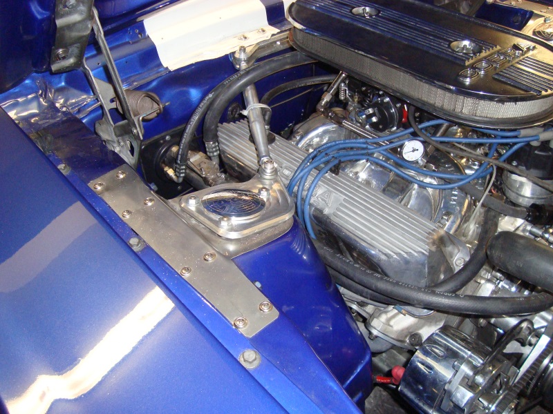

Next I worked on installing the new emblems.
Some fitting work, but that's done.
Now I have to decide on orientation.
To the side (side facing)
or to the front.
The problem with the side, is that the emblems are a little hard to see, with the shock towers canted towards the inside. It might encourage people to lean in over the car a little too far?
I like them pointing to the sides. I wouldn't be concerned with people leaning over too far.
