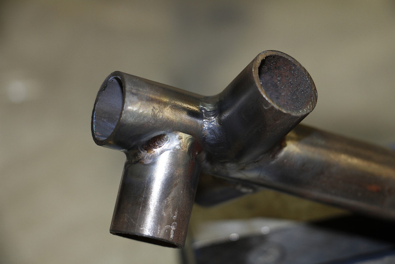

I just picked up a used JMR tube notcher so I have more welding challenges and practice are on the horizon for this winter. Here's the first attempt with .75" OD 4130 tubing.
Didn't take long to notice 4130 welds much nicer than some of the junk I've been practicing with! Now I need to find a source of affordable 4130 practice scrap. That stuff is
